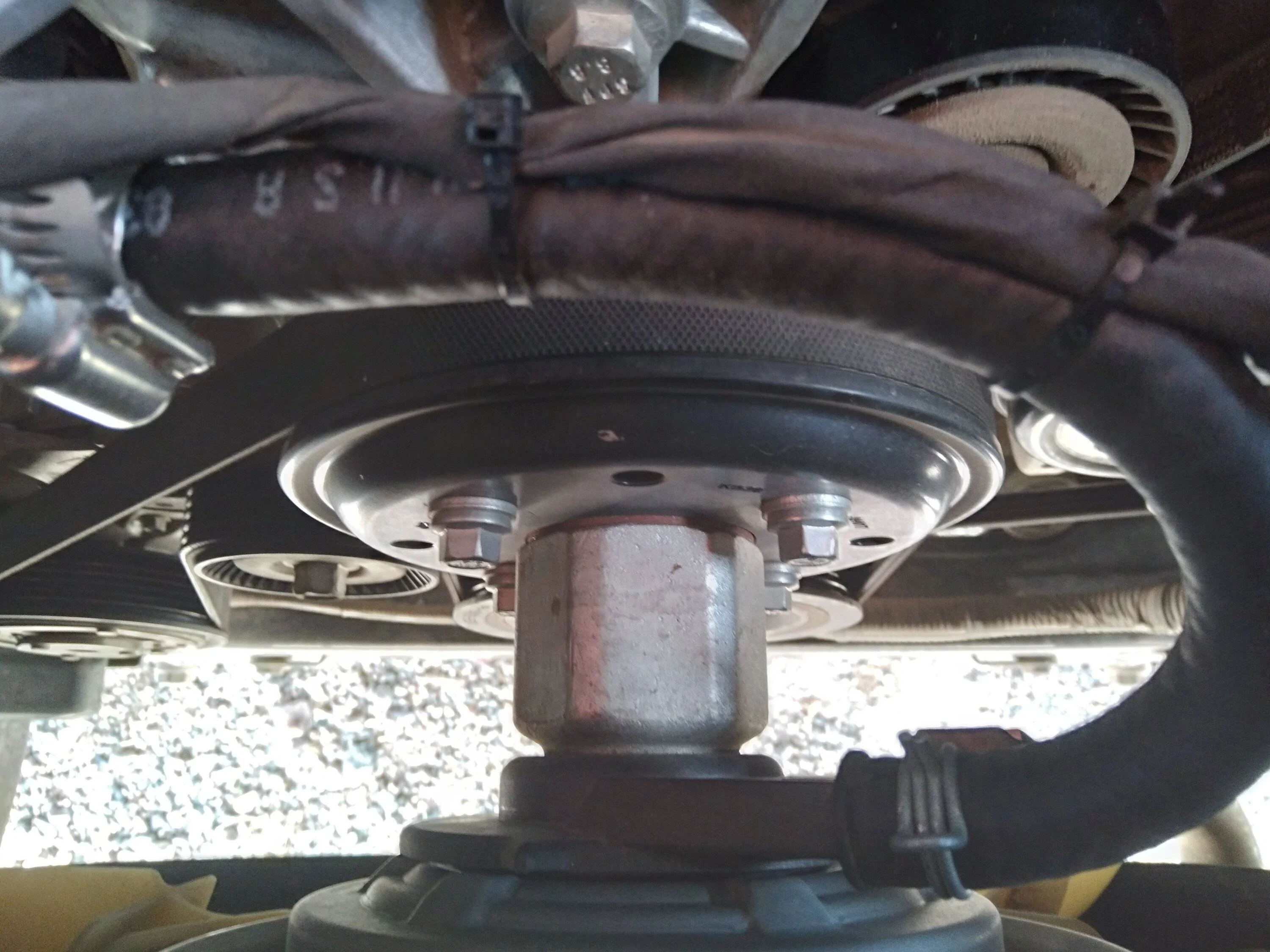

I hadn't broken two hoses within a year but patched the same one twice. Both times it broke on the end away from the fan.
Yesterday I patched it to (hopefully) make it to the auto parts store.
My thoughts were to just replace the old hose with something stronger.

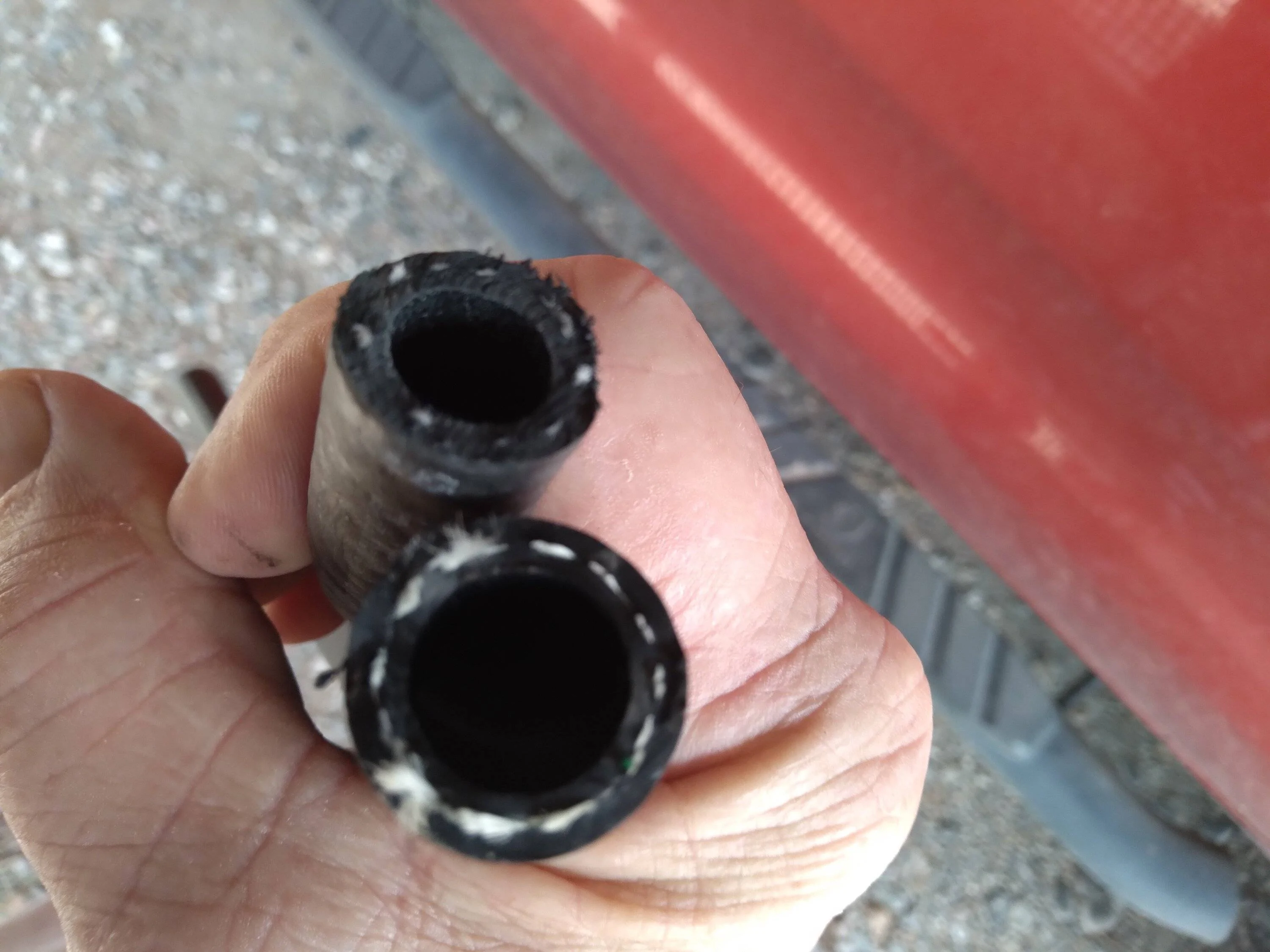

I asked about some reinforced rubber hose at NAPA and the guy had some cloth reinforced stuff.
He called it multipurpose hose and said some NAPA stores have it in black and some stores have it in red. I
The 3/8" looked a bit small, so I bought a piece of 3/8" and a piece of 1/2".
The fabric reinforcement looked a lot heavier on the 1/2", but 3/8" ended up matching the old hose.
(The 1/2" didn't fit tight on either end so wasn't used.)
When I got home and started to do the repair, my patch from yesterday had already come loose.
(I had wrapped a strip of Gorilla Duct tape around the split, then covered with my extra wide hose clamp. The old hose was just too brittle on that end.)
I re-used the stout crimp hose clamp down at the fan sensor, and used my wide hose clamp at the top.
I tried to get some fancy zip ties like the factory ones that carry the wire harness piggyback, but couldn't find any and just used regular zip ties.
This hose should hold a few years, it's built much better than the soft rubber factory hose.

I had no interest in having the dealer replace the hose with the same inferior rubber that failed in the first place.
Surely (Shirley ?) Ford could have chosen a more suitable material for the hose.
Interestingly, most failures of the hose seem to be at the same end, the end away from the fan.
There might be an even stronger alternative to the cloth fiber reinforced hose I used, but anything is an improvement over the factory material.

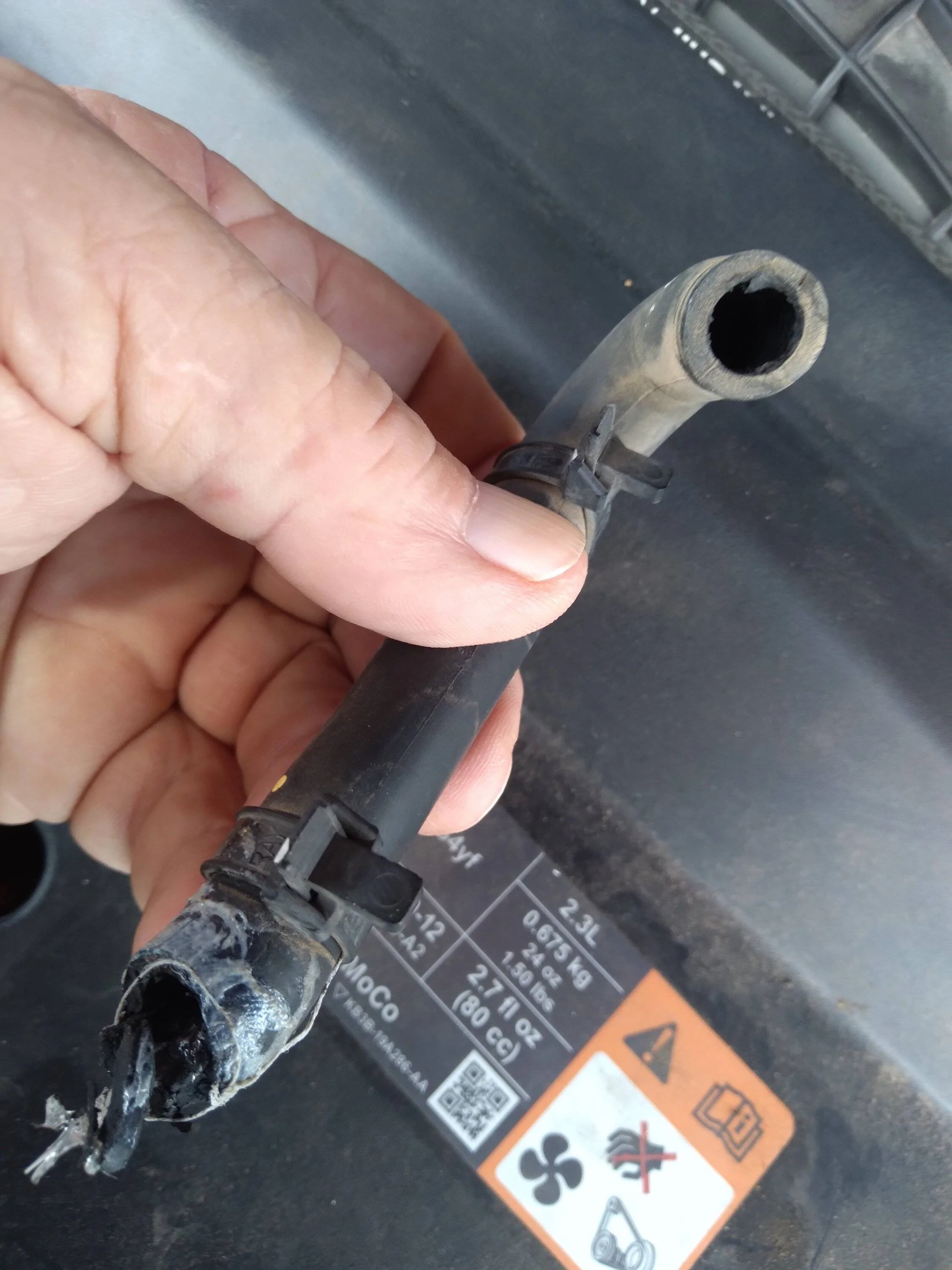

I would agree with these statements if the hose had a clean break but the hose is literally disintegrating in my fingers. This leads me to believe it’s either poor manufacturing or wrong material for the job.
Photo of temp fix to get me to the store for some hoes
