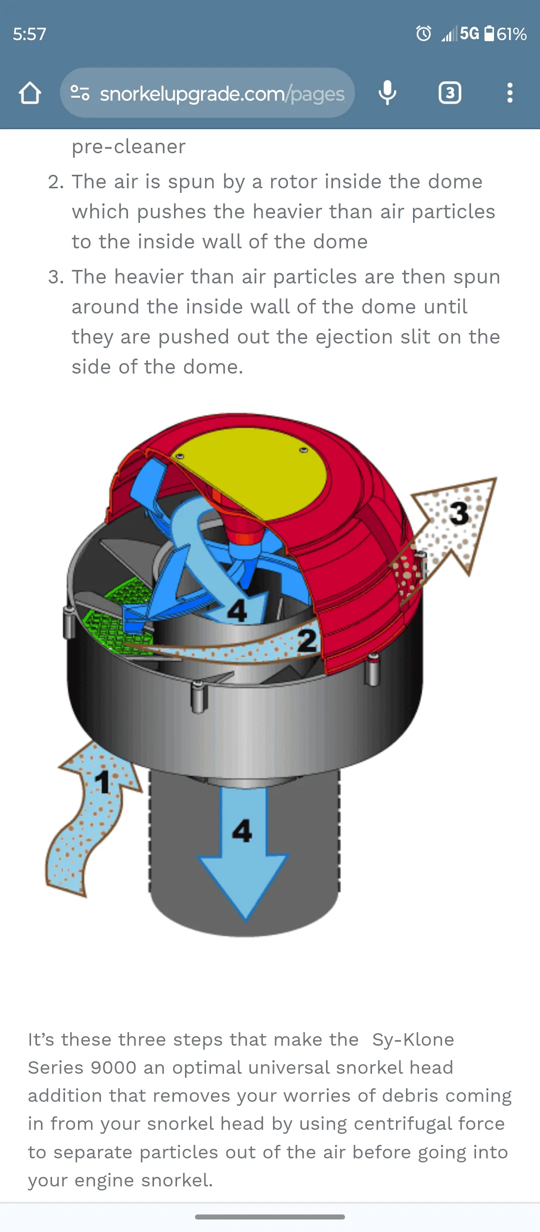

Now we get to the lovely Syclone Snorkel PreCleaner and why you would consider it. In the attached picture below this paragraph will give a general breakdown down of the PreCleaner. Let's say you want to have as much filtering of Dirt Dust and Debris as possible or better yet want to protect the vehicle from sucking up Snow in a snow storm(just like I was worried). This is where the PreCleaner comes in handy especially since there is no maintenance to the PreCleaner(less work you have to do the better). The fan that is inside the PreCleaner essentially uses centrifugal force to move any Dirt Dust and Debris at the ejection slit in the PreCleaner. The Fan is simply powered by the Air moving past.

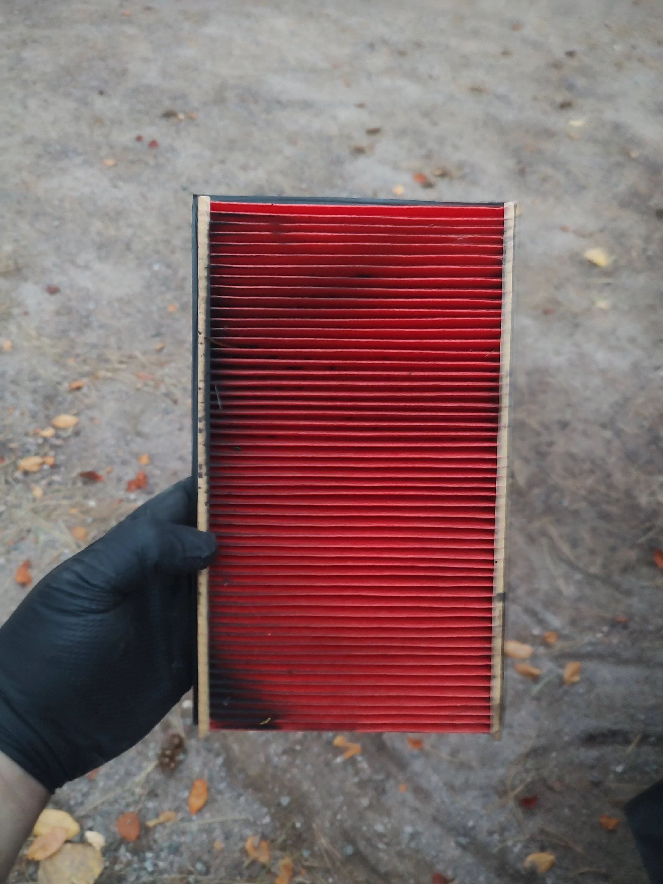

Now for the general results of the PreCleaner Efficiency. My Snorkel was installed in Mid July of 2023. I did replace the air filter and let it run until I installed the PreCleaner. Here is what the Filter Looked like when I removed it after 3 months.
Not too bad compared to no snorkel for about the same time and run OffRoad (sorry as I don't have a picture of one of those).

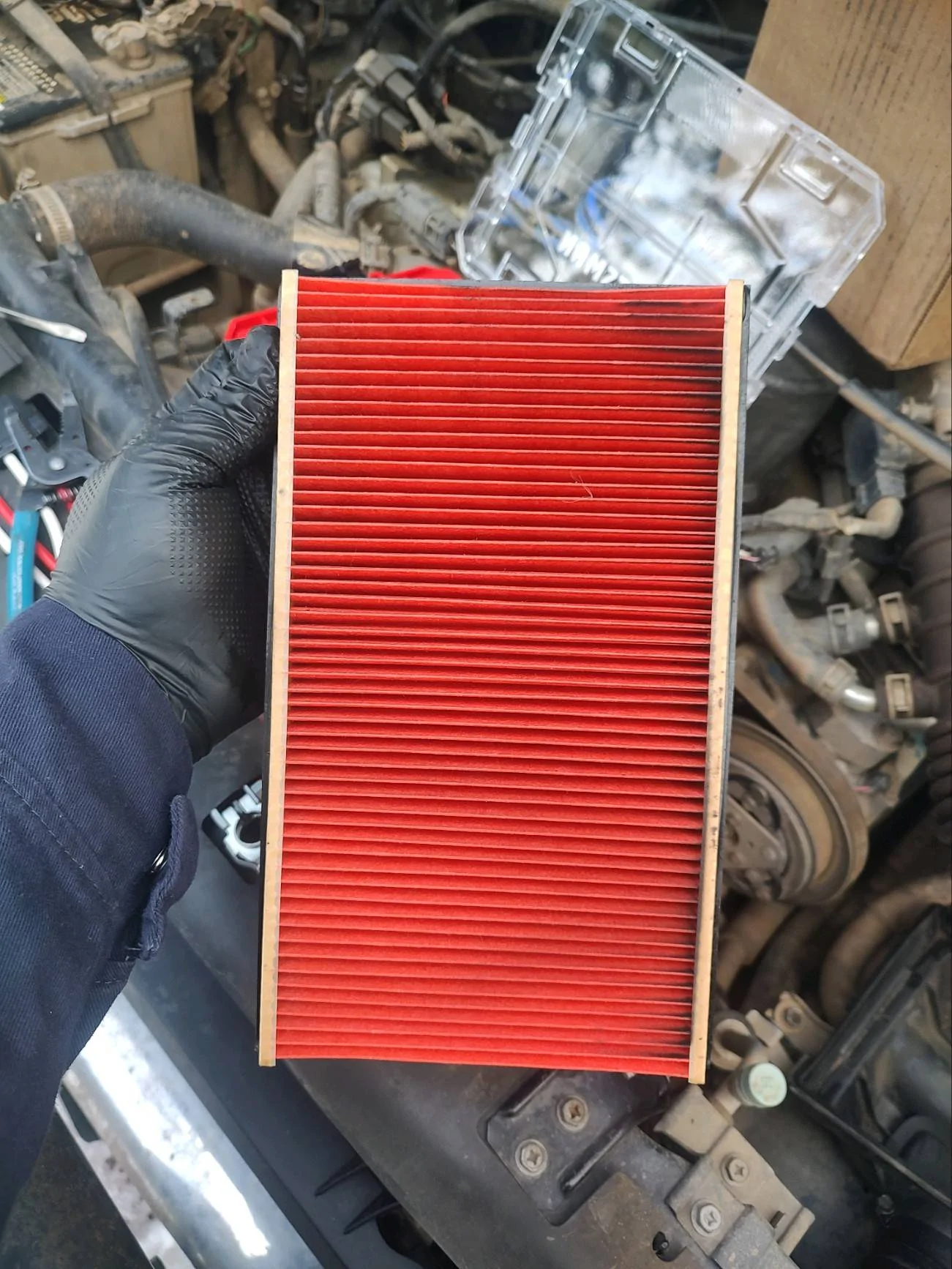

Now here is the current Filter that has been in since the PreCleaner installation.
Much cleaner as you can tell. That is only just after 2 months, but as you can tell it is nowhere near the condition of the other filter.
For context these are OEM Nissan Filters that do have a Light Oil Film to help trap Dirt and Dust.
