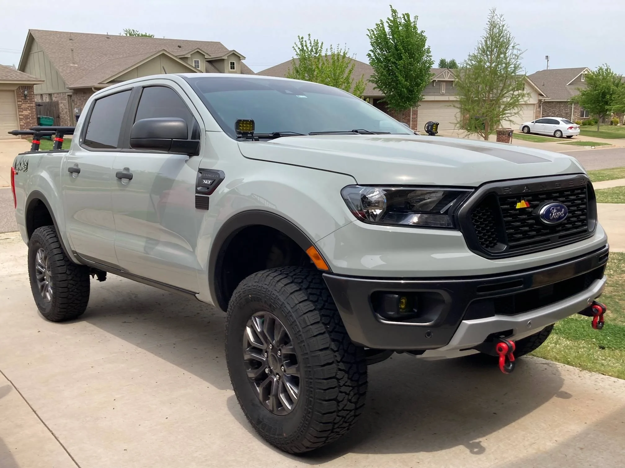

Utah_Bound
Scott
Dec 29, 2021
109
323
Oklahoma, US
2021 Ranger XLT FX4, 2021 Renegade Upland 4x4
Plumber
