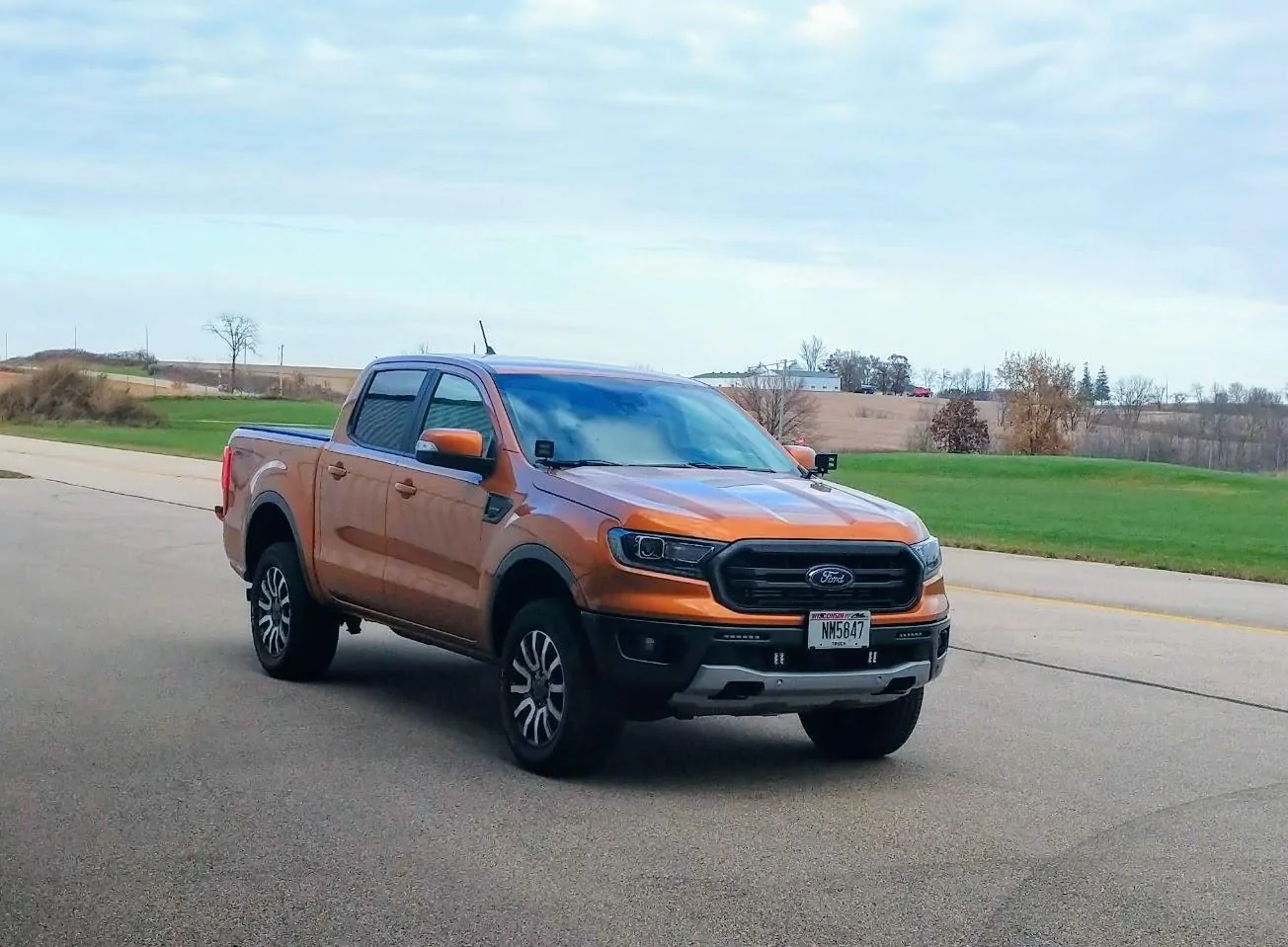

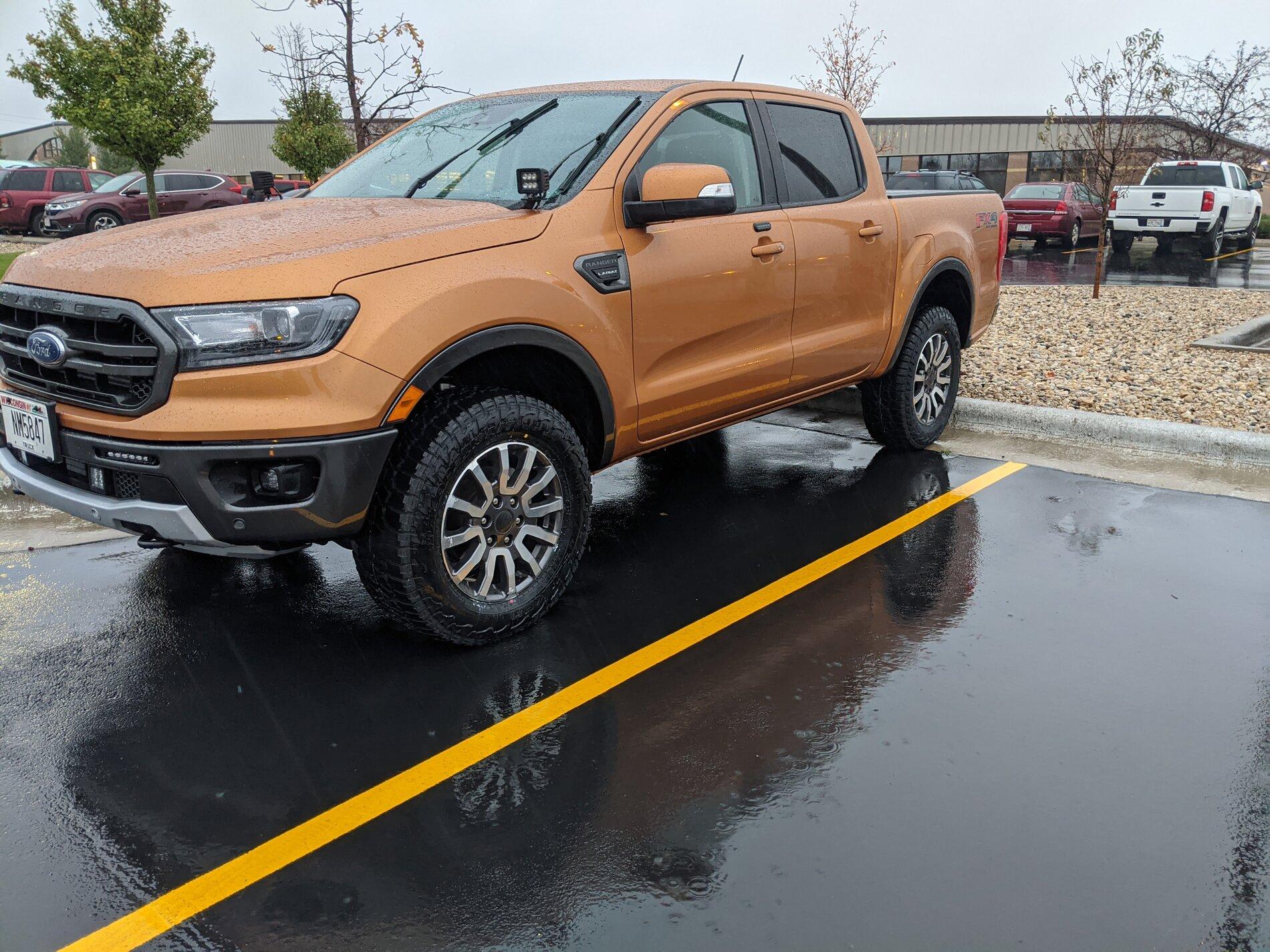

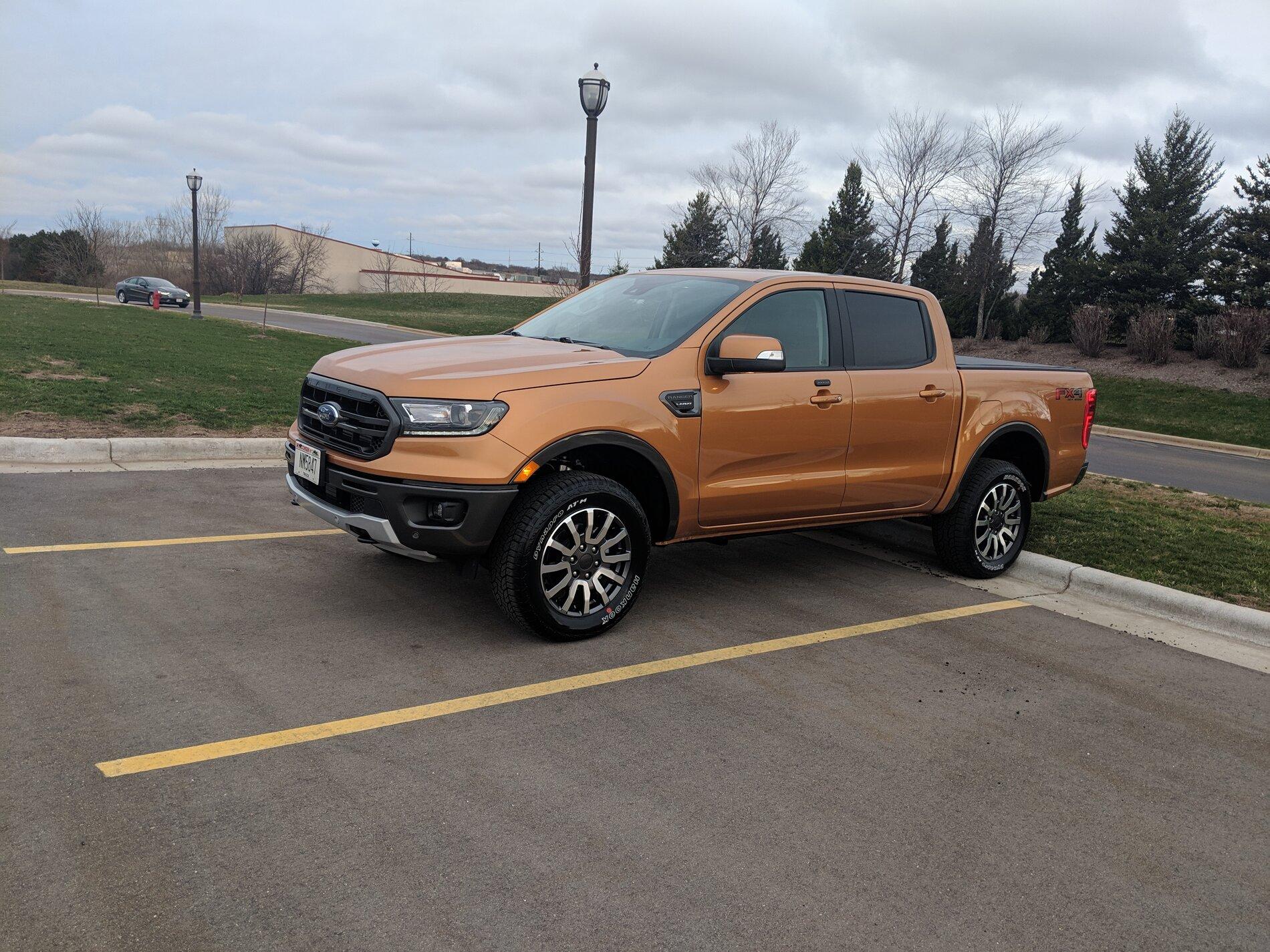

Hey all,
I wanted a small levelling kit around 1", I like SOME factory rake (but not the crazy rake it comes stock with) so the truck doesn't squat when I have a load. I couldn't find anything that was 1", I considered getting the readylift 2" level and throw away the bottom spacer... but $200 is a lot to throw away half of the kit. I also didn't want to over-stress the UCA Ball joints or replace the UCA so something smaller is right what I was looking for. I settled on this $25 1/2" Wulf suspension spacer:
https://wulfsuspensions.com/product...rd-ranger-2wd-4wd?_pos=3&_sid=da970ff7a&_ss=r
I personally would NOT recommend the kit. It didn't even come close to fitting... I thought the picture was a stock photo, but it's not. It's missing a hole and the existing holes aren't even close. I had to rework it for about 45 minutes each to fit, then repainted to avoid rust. I thought "oh its only $25 I'll throw it away if it doesn't work"... well I didn't take into account that I'd have my suspension ripped apart before I realized it wouldn't work. But... now that it's on I'm VERY happy with it. I still have 1.375" of rake, but it improved the stance of the truck considerably and I cleared 265/65/R18 Falken Wildpeaks no problem.
FWIW 2x of these spacers will not fit and still give you thread clearance for the top of the strut, I was hoping to get 1" of lift that way, but had to settle for .5".
Before/After pics attached, I have a pic (in order) of Stock, Level with Hankooks, Level with Falkens
