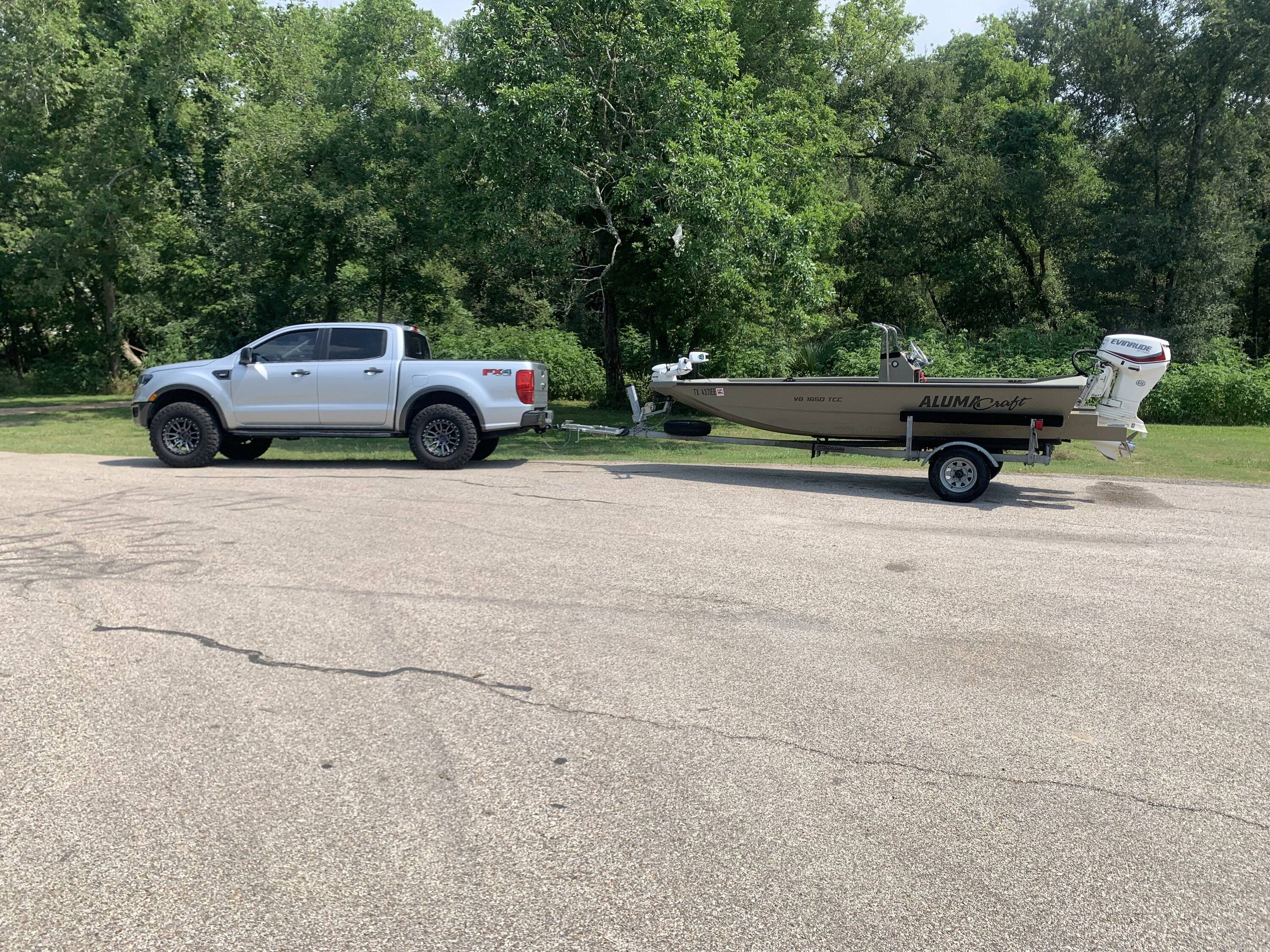

Here is my Ranger with the 5100s set at 2.5”. I tow a smaller 16’ aluminum boat and it has very little squat on the truck.
Thanks for the visual. There is some squat and my skiff is a 95 Hewes redfisher which I suspect weighs a bit more than your so maybe best I stick with a 2" rise? Opinion?

From what I do know you should be fine for the most part. That said I would recommend not going more than 2 inches.of level. Why you ask? Well you do have a truck and I know there are times you will load
the bed and tow from time to time. This will help prevent you from the lovely Carolina Dog Squat when loaded.
I'm thinking the same. Two inches it's likely going to be the way I go
