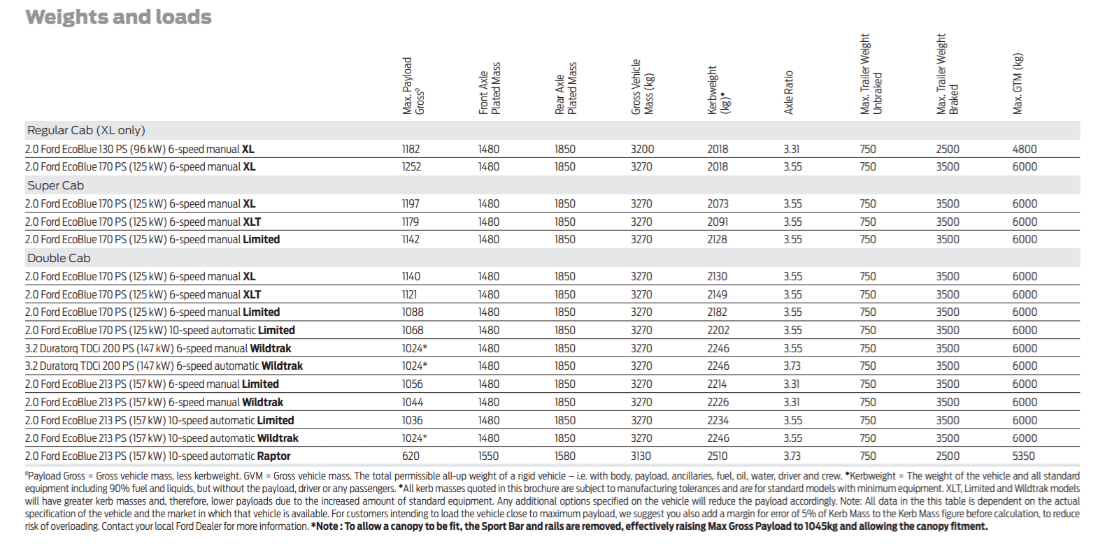

@P. A. Schilke
Here is a question for you:
Why does the European version of the ranger have such a higher payload?
1140kg = 2513 lbs
Towing capacity is identical.
Is it due to the 2.0L Diesel?
7,083
37,193
@P. A. Schilke
1140kg = 2513 lbs
Hi Mike,
Not 100% sure, but likely the diesel motor... Since the Ranger was an Aussie program, and remains so today... there is not much info to understand the total differences between the ROW and the NA Ranger....
best,
Phil Schilke
Ranger Vehicle Engineering
Ford Motor Co. Retired
rear axle weight rating is around 600lb higher than the US version. rear suspension was one of the major changes they talked about when they brought it over.
