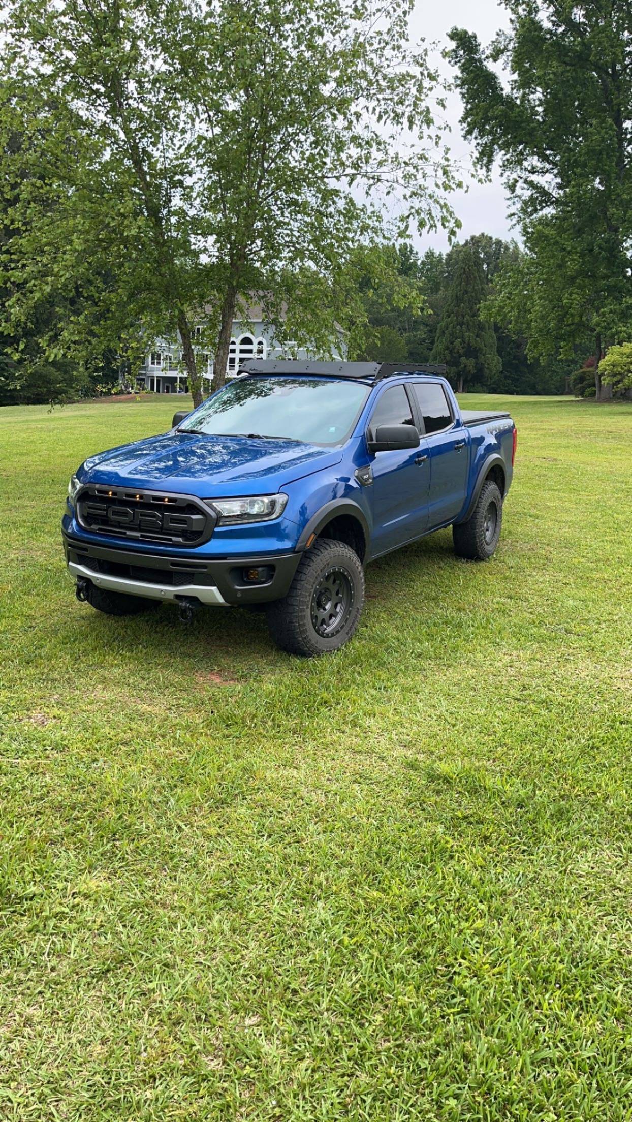

2019 Ranger XLT crewcab 4x4 with BDS lift. Advance Trac error has been popping up, which disables all safety sensors. Took to dealer, and they said my tires were too chopped and needed to be replaced. Out on new tires, error still occurs. Put on 4 new ABS sensors and error still occurs. What would be next to check??
