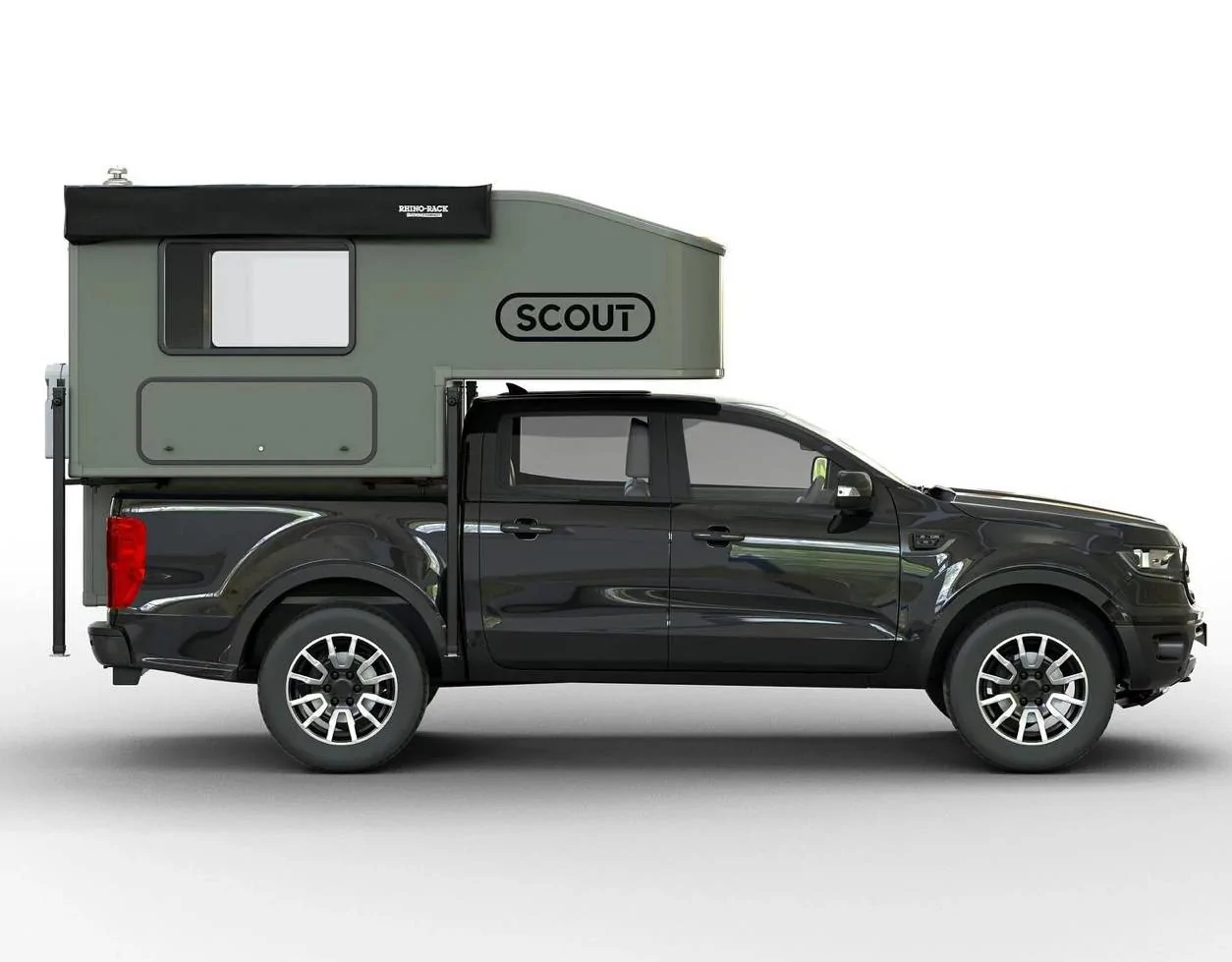

That looks nice, but is also the reason Ford states in the manual:
USING A SLIDE-IN CAMPER
We do not recommend using your pickup for carrying a slide-in camper.
Wonder how Ford feels about the total front facing area of this setup

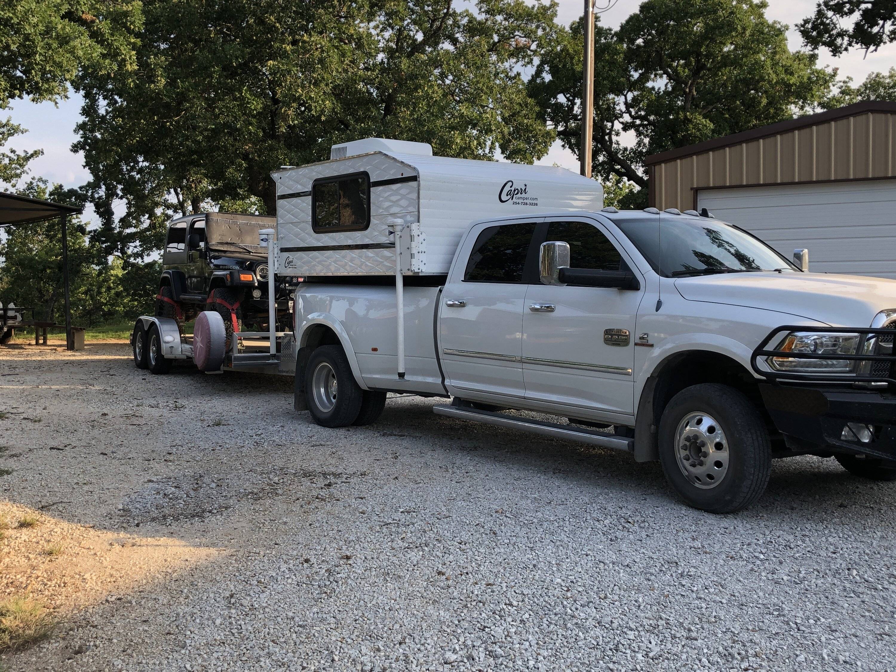

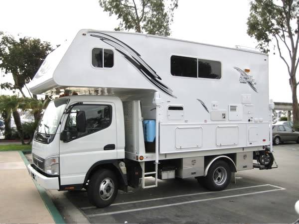

Years ago, before the "lawsuit happy customers and attorneys" one of the big selling points for a pickup was the ability to load/carry/use large and heavy slide in campers.
And, like the ones I pictured, some were very large, very heavy, and top heavy....yet people bought and used them for many years.
Properly set up, the Ranger would have no problem handling the Scout....Just my opinion....
The dry weight of the Scout is less than the tongue weight of our travel trailer which, when hooked up, places that weight on the Ranger. That plus what I carry in the bed, and our interior people and pets puts us at the loaded weight of the Scout.
High center of gravity...maybe. But no worse than driving with a 24 foot, 9 foot high shoe box shaped trailer.

Kind of my point, but also, the OP campers COG is likely in the bed rail area.
A balloon with lead weight tied to the bottom looks top heavy.
Sail area is a different matter. I drive a medium roof height Transit van so I am well aware of that effect.

640lbs dry...probably 850lbs + loaded...that's almost light...
It's not the weight, it's the height. Rangers already have a high CG, adding something like that raises the CG and leads to instability.
and now let's calculate all this again with the 6cm wider track that everyone here has anyway because otherwise the car will sway even empty like a Venetian gondola
