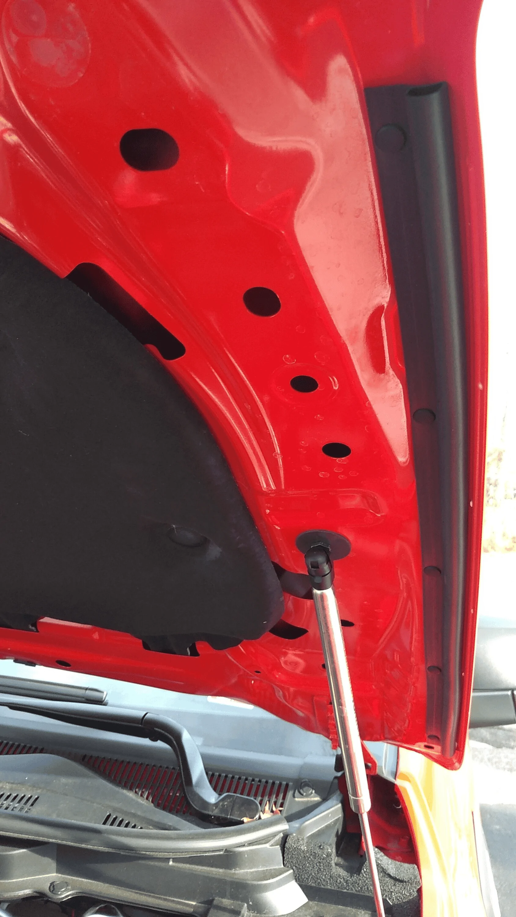

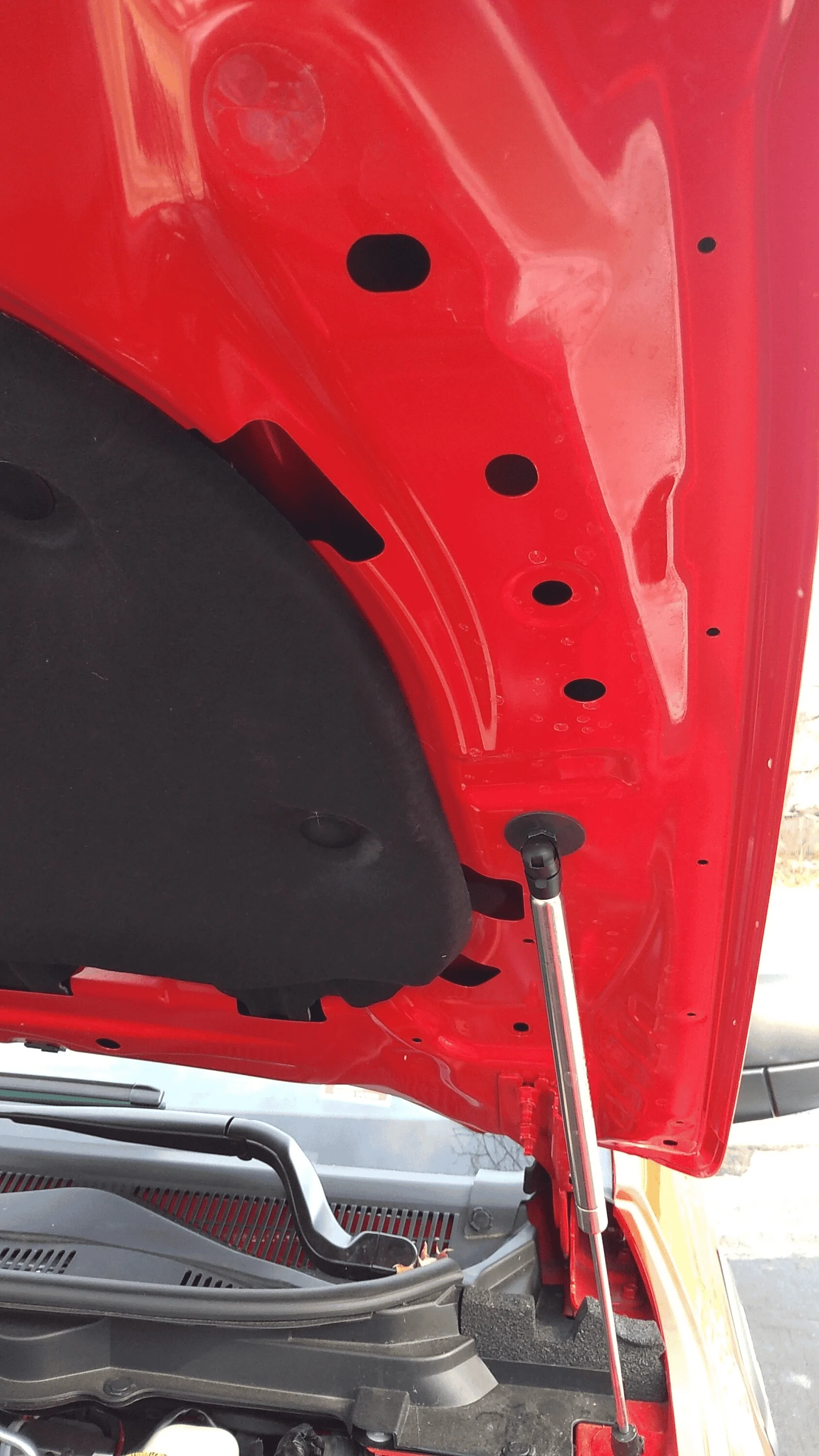

And check your hood side weather stripping for better external noise mitigation. My '22 didn't have them and it was pretty economical to add them.
Was this a deleted item that we missed? I see the holes to mount those in the 'before' picture.
You got part numbers?
4,554
23,156
Sorry, I had linked the words:
https://www.oemfordpart.com/oem-parts/ford-side-weather-strip-kb3z16a238b
From my order, it looks like the part number is only for one and they fit either side:
KB3Z-16A238-B​
Side Weather-Strip​
$29.58​
2​
$59.16​

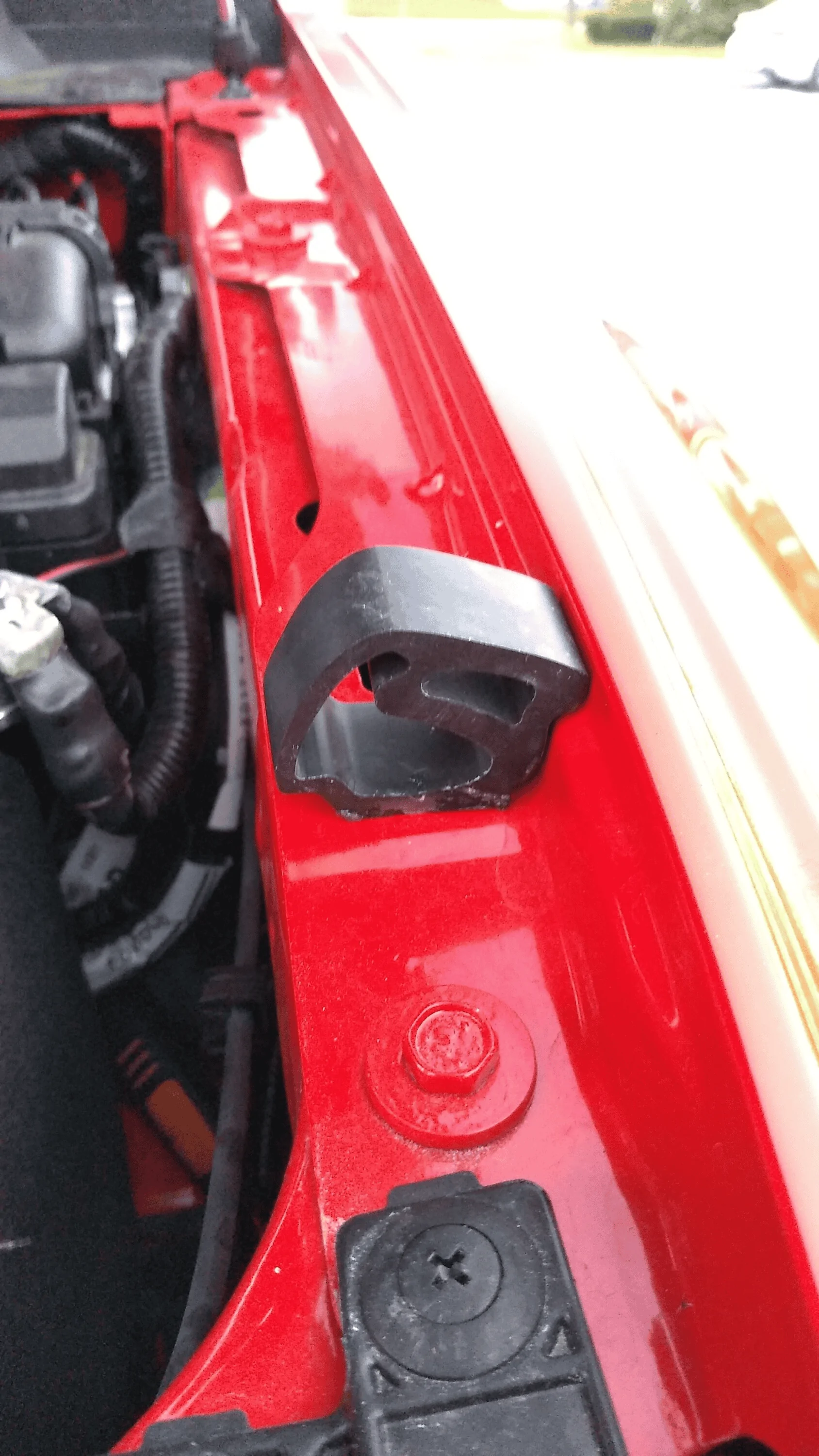

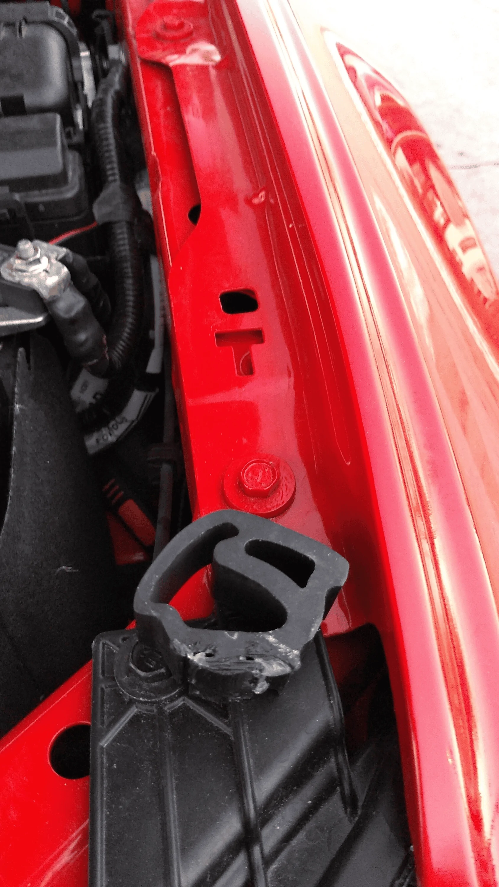

And .... mine was also missing the hood bumpers! =(
https://www.oemfordpart.com/oem-parts/ford-bumper-eb3z16758a
EB3Z-16758-A​
Bumper​
$6.14​
2​
$12.28​
