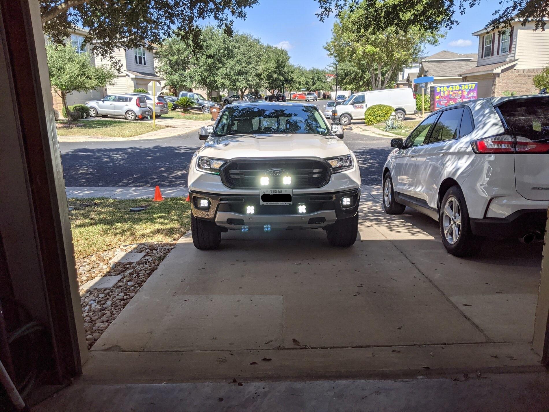

I added some more lights. ?
The Ditch lights has its own wiring harness and relay. The other 4 near the license plate is hooked up to a heavy duty wiring harness and relay. This way I can add four pods to one wiring harness.
All relays are controlled by the OEM fog light switch using the positive trigger method. I press the button, all lights turn on. But once I get the Bluetooth relays, I'll be able to turn on/off the ditch lights and the 4 near the license plate independently.

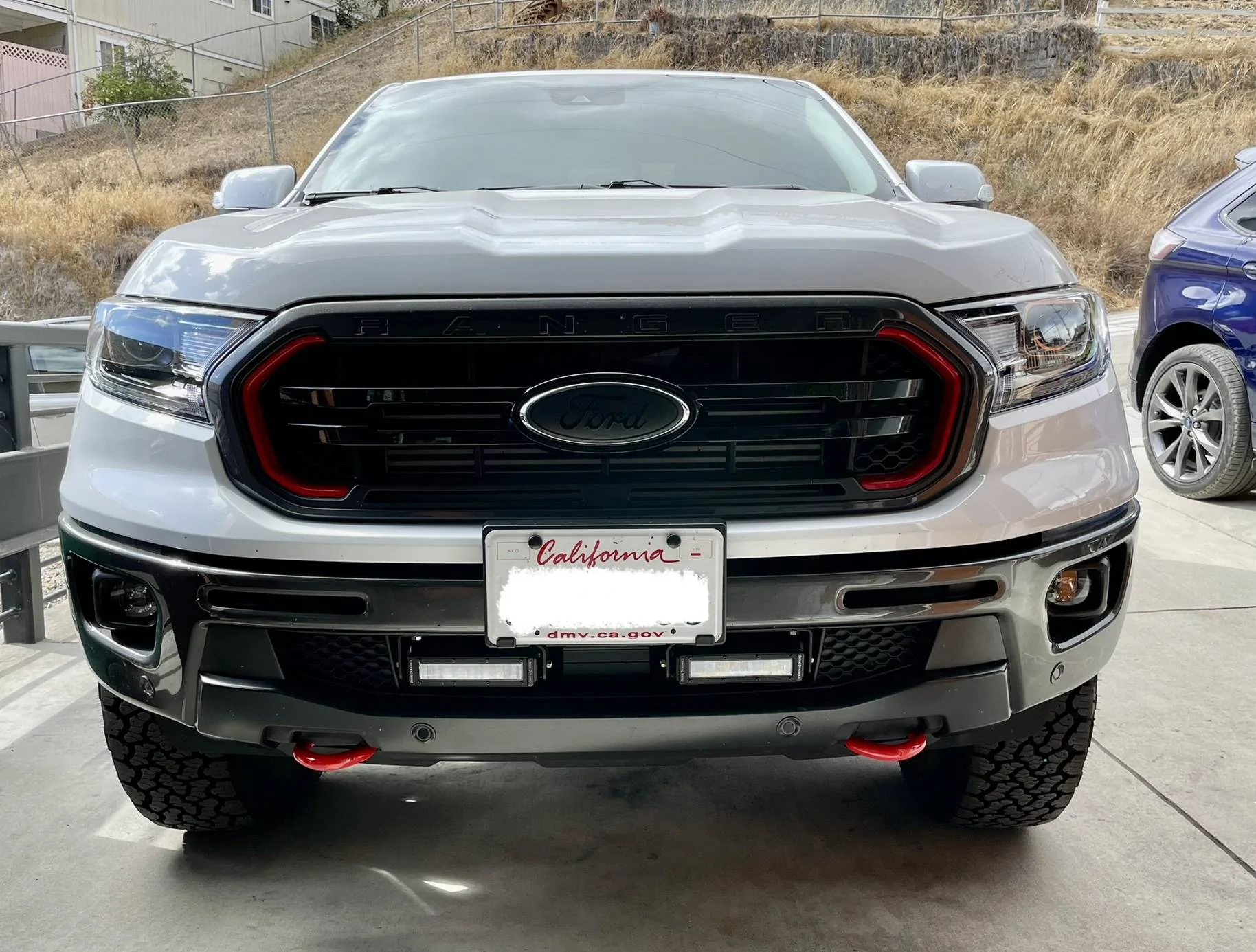

No worries. I ended up buying them in the SAE fog pattern and I’m very happy. They are extremely bright.
That looks sweet!
Is your lower valance painted Black, or color matched to the magnetic gray color, or???? I like that, mines Silver, and I'm going to change it soon, and paint my tow hooks.....
MapMaker7
Aug 14, 2021
SF Bay Area
2021 Ford Ranger Tremor
That looks sweet!
Thanks, sorry for the delay. Yes, It’s black. Came that way from Ford; maybe it’s standard on the Tremor.
