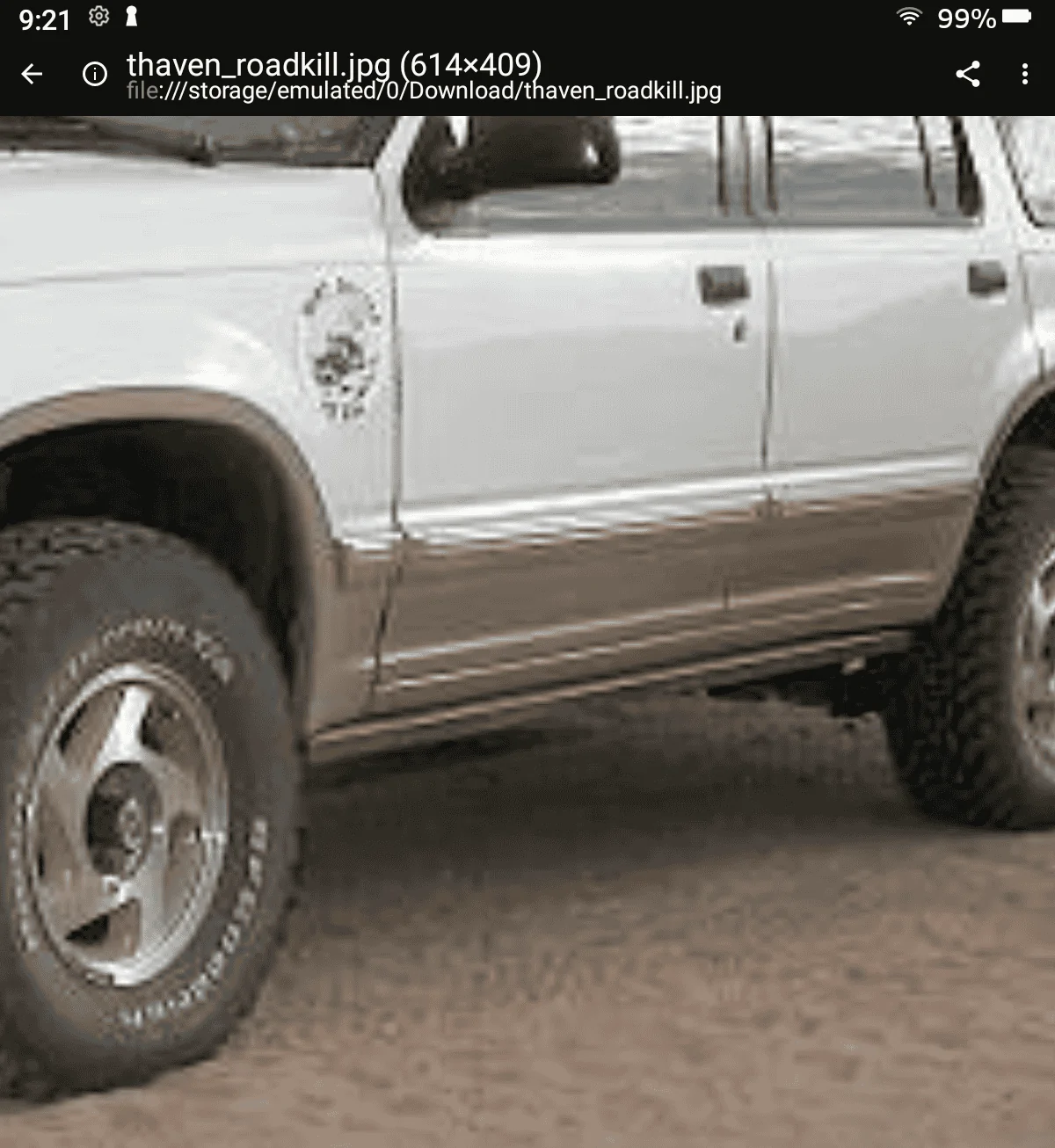

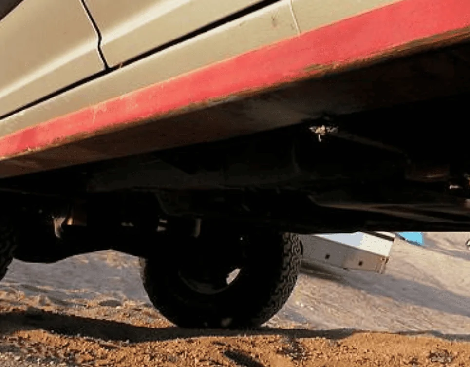

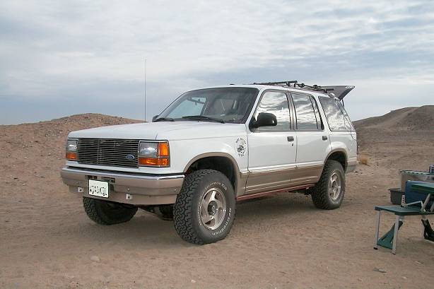

Many moons ago I mounted 2"x3" square steel tubing to my pinch weld after high centering once and slightly denting the rocker panel. 1995 Eddie Bauer Explorer 4x4 with 3" Dick Cepek lift.
It worked very well on many rock crawling runs. They were scraped like crazy on the bottom but protected the paint!
Go for it!

I bounced off of those rails many times on rocks and dirt. Maybe find stronger, but they were fully effective, and square steel tubing is very cost effective.
Depends your budget and skills.
