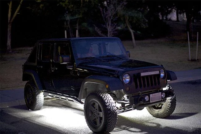

How did you wire them?
Thanks! The set for trucks has 8 total lamps. Four have 20 foot cables and other four have 10 foot. Start at the rear and positioned my first set on each side of the frame attached high enough where they won't be the first thing to make contact and worked my way forward while managing cables with zipties to keep them neat. Once all the cables meet up at my Trigger power on top of the battery, I solder them all together in parallel against the primary male plug and shrink wrap carefully. After that, it's literally plug and play. Through my iphone app for Trigger 6, I can adjust the brightness and make them flash as well...:)

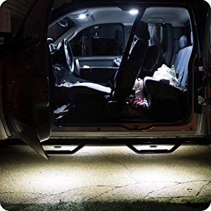

I used these same Lux Lighting LED's in replacement of the LED's that came with my AMP PowerSteps. Like you, I did the research and found the mag-mount option to best fit my needs.
I ran the wires thru the frame and stuck them facing outward. You literally need both thumbs to reposition the magnet/LED casing. They won't move unless you move them! So for Rock Lights.... they will ROCK!
