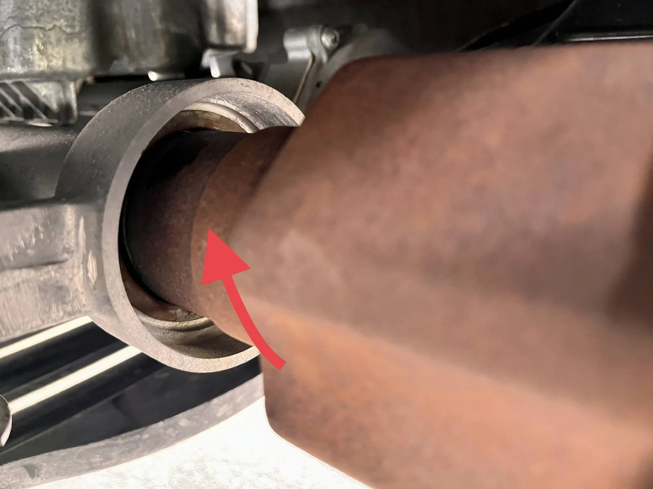

I just replaced my front coils on a 21 XLT FX4 and despite my best efforts had both CVS separate. I was able to get them back together. On the right side though, I am worried that the axle came out of the diff and didn’t reseat. Is that even possible to get everything back together in that scenario? I have run 4H and 4L and there wasn’t any noise or binding. There is a sound similar to the guard on the disc rubbing which I will check.
Can someone take a pic of their right axle or look at mine and tell me if it looks like it’s fully seated?

Whew I answered my own question. Probably just knock the dust shield so it’s rubbing the disc.
here’s a video showing it
