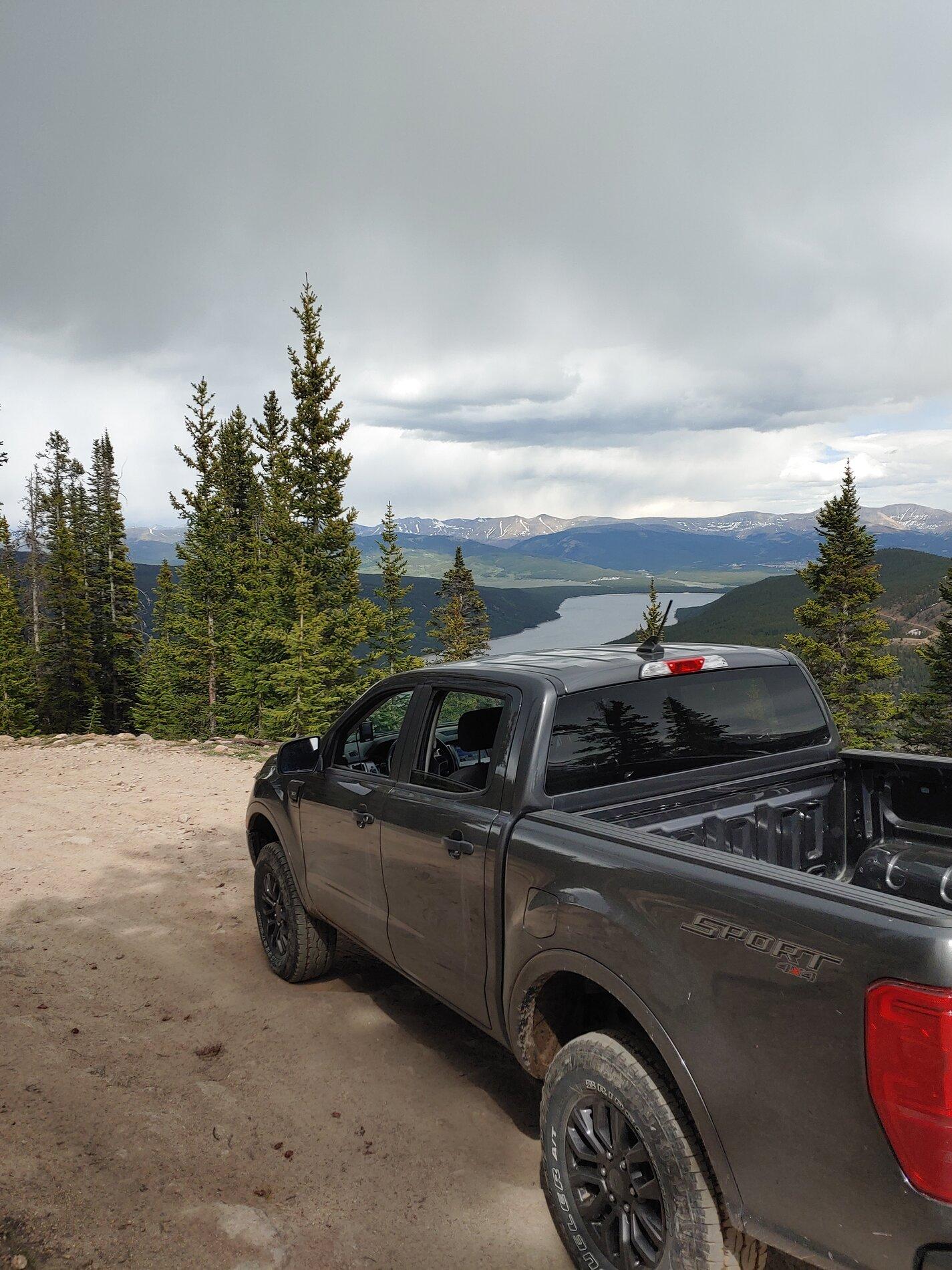

So Ond Man EMU has a lift kit for us with the EcoBoost engine. I actually have it and I can tell you the lift is nice. How much does it lift from stock in the rear? 1.6 inches. Doesnt sound like much to most but is is enough for Offroad. Here are some pictures of my truck with the OME lift!!
