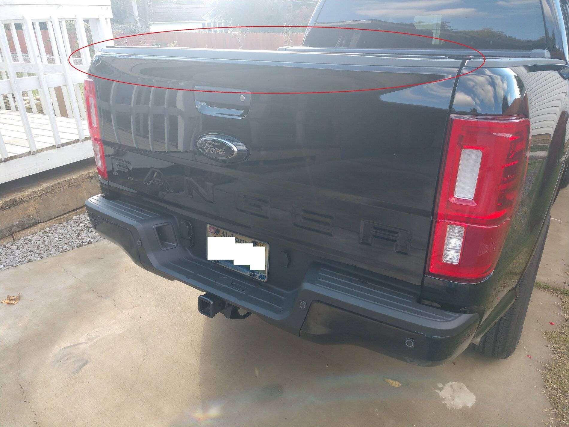

Simple question? Does anyone know how to remove the factory tailgate cap? Apparently some Rangers don't have them, but mine does and I need to know how it's attached to the tailgate and hopefully how easy it's unattached?

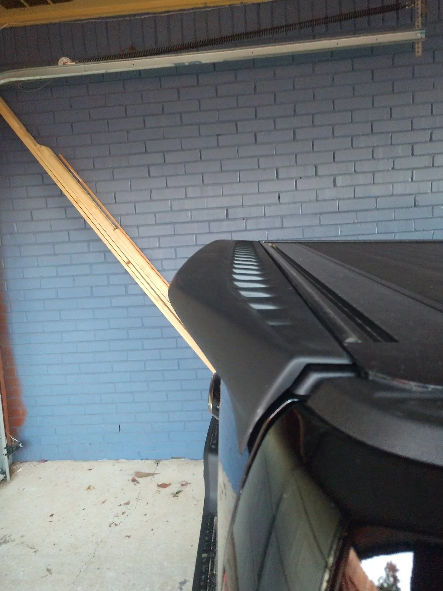

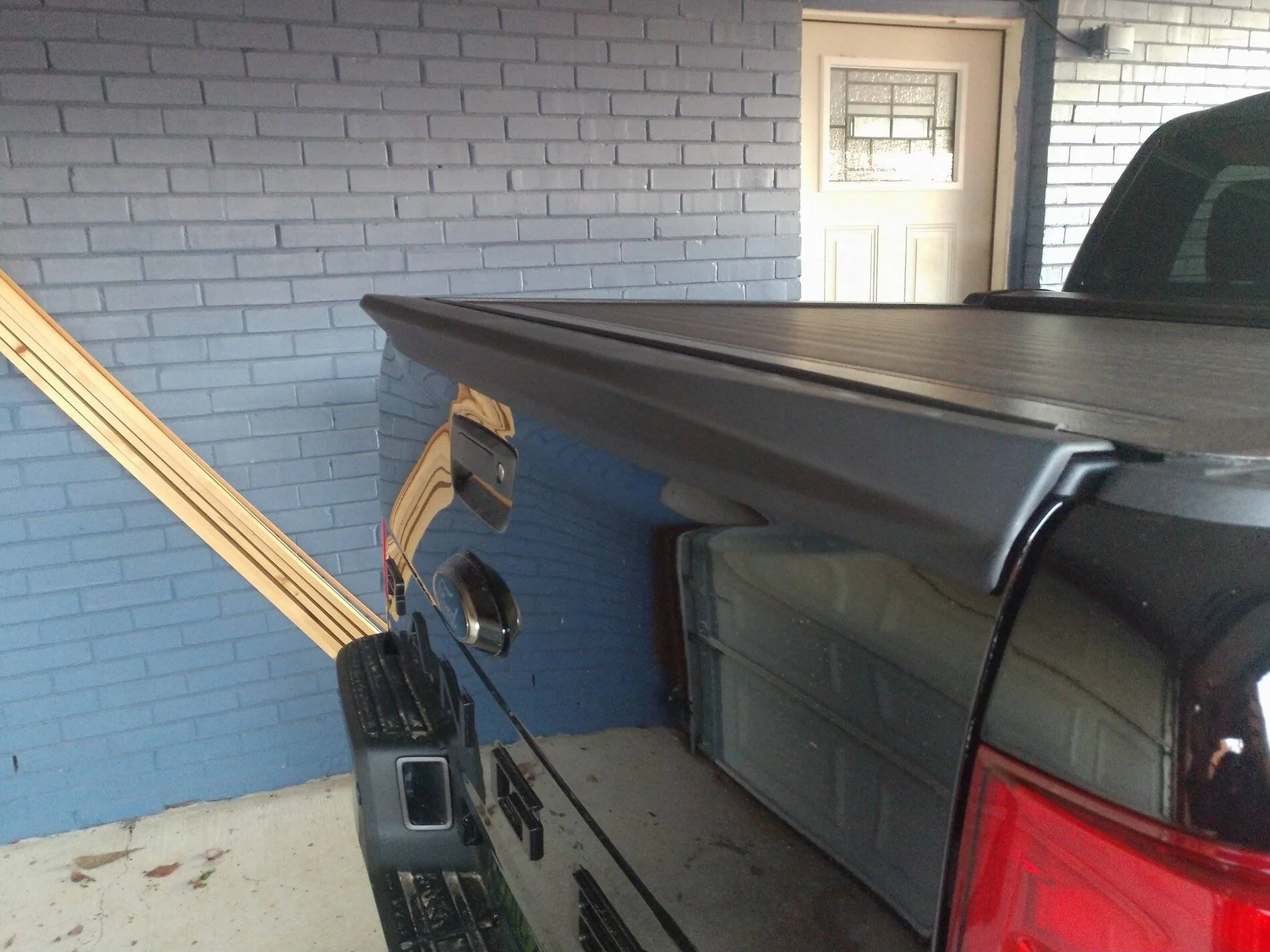

Alright, it's been confirmed! It DOES go over the existing cap. It's been too cold to mess with it most of this past 5 days off, but once I took it out of the box and laid it on my tailgate, it's apparent!
I did, however, call Air Design today and what they told me really doesn't surprise me one bit, LOL! They said they didn't know how to install it....
They gave me the number for Billy, the guy that installs their parts on other peoples' vehicles though. I called him and he confirmed how to install it :) That's good to know, so maybe I can get it installed this weekend.
Here it is, just sitting on my truck.
