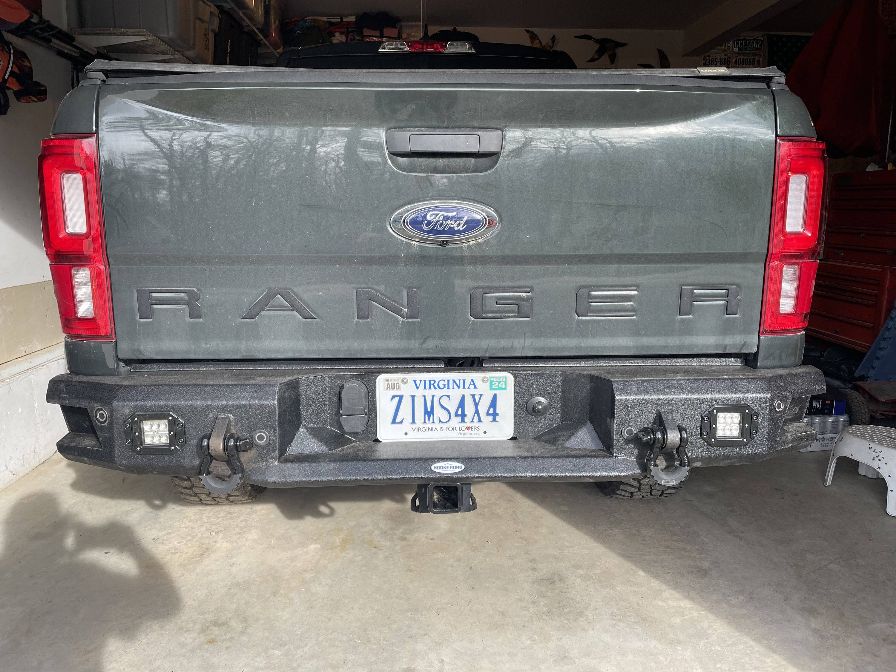

Recently got rear ended and am replacing the factory rear bumper with a Hooke Road bumper.
Has anyone removed their old bumper? and were you able to replace your towing package?

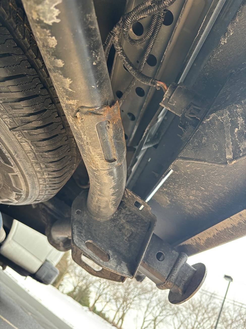

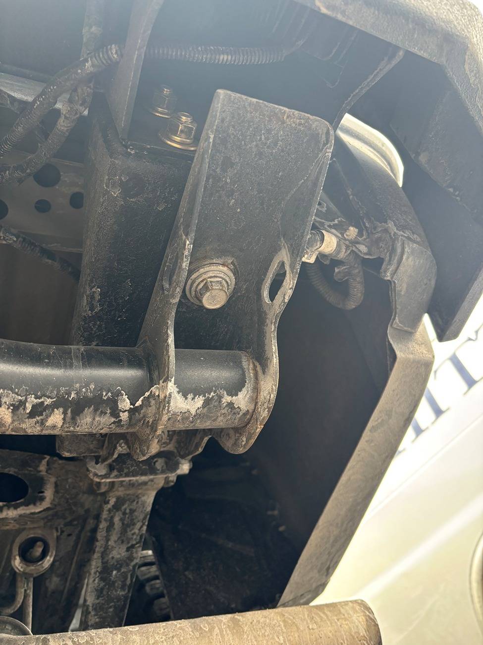

Gonna replace my bumper with one like yours. How did you resolve the hitch issue?
When we installed it we had some issues but we actually cut the factory bumper leaving the hitch. Grinded off and painted it. Then WITH A FEW EXTRA HANDS held the new bumper up first then what was left of the old bumper and attached the bolts. We did use some shims on the back bolts to tilt the bumper a tad downhill as the hitch will hit the new bumper. You could notch it but we went the metal shim way. I'm cheap that's what we did but i bet you can purchase a new hitch. if you need more photos let me know , i just took a couple quick shots of underneath.
