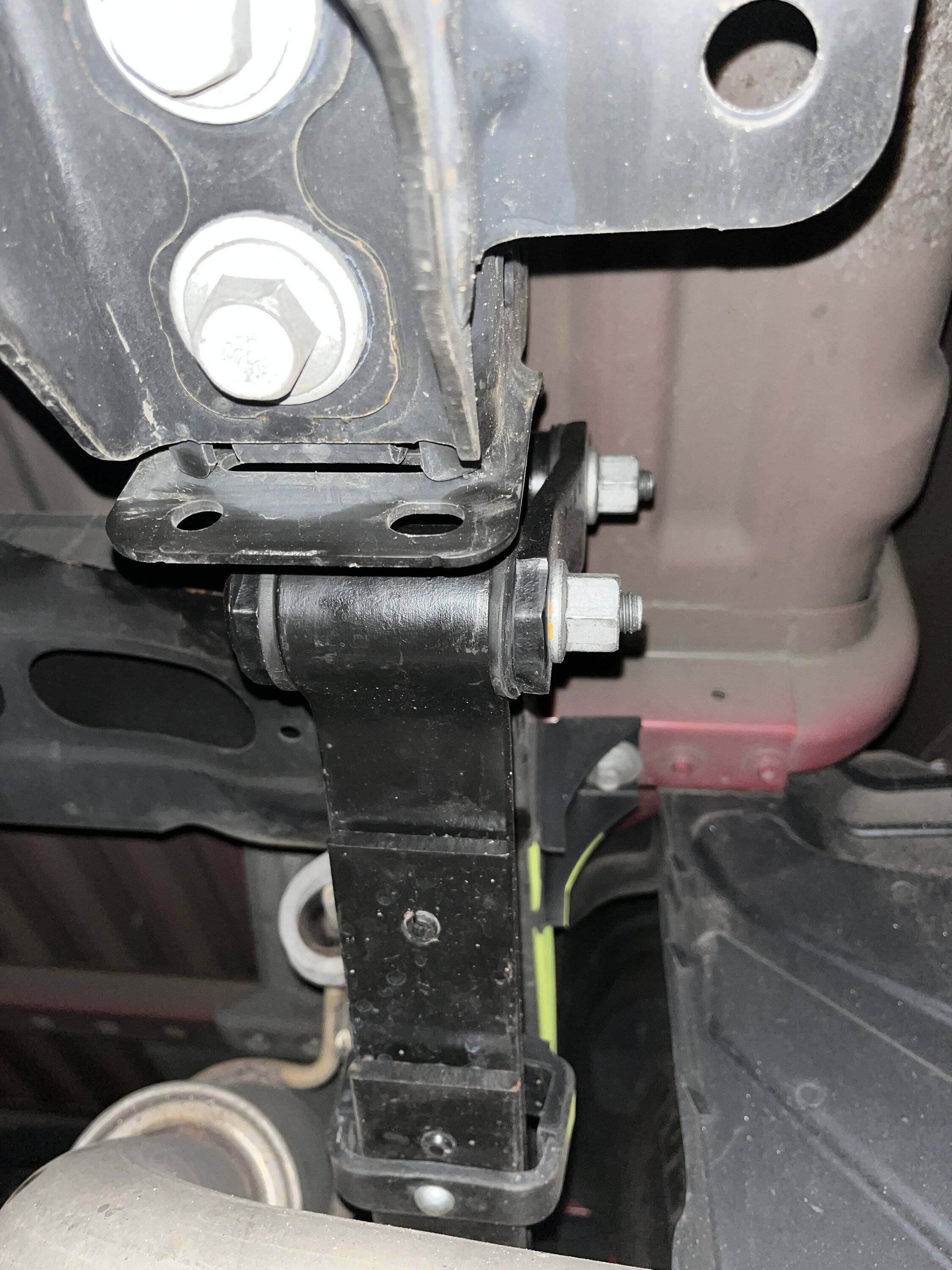

its puking it out.
bad.
you think the spray silicone killed it? i need help asap so i know how to fix this.

these ones definitely swelled up.

update- trimmed an 1/8” off, and now seats perfect. guess if the grease caused them to swell 1/16” each, it was enough to force it out.
