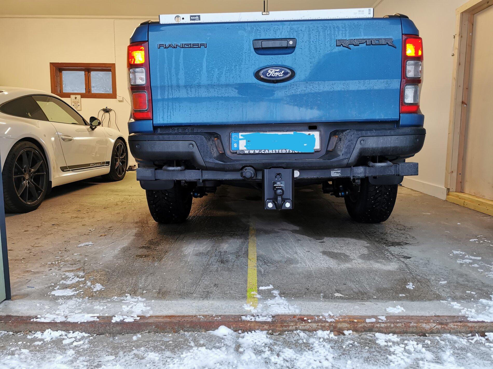

Hi fellow Ranger Raptor folk. I have a question. I picked up my new Ranger Raptor in mid December 2020 at the local dealer. I drove the 180km home and put in into my garage. On standing back I noticed that it was down on the left hand side. Checked the floor, but this is level, checked the tyre pressure , all good. I measured the difference between the left and right wheel arch and there’s around 5cm difference in clearance between the top of the tyre and the shell arch.
I immediately contacted the Ford dealer, took it back to be totally suprised by the BS they tried to tell me.
” The fuel tank, ad-blue tank, plus you sit on this side, blah, blah, blah”
Strangley they did agree that this is not normal and that they would contact Ford tech support.
3 weeks later still no answer.
And just to annoy me more, the 4 wheel forward transfer case was leaking after less than 500km. They asked if I used the 4 wheel drive, yes on snow and ice, not normal road. “ Ah, that’s why it’s leaking” Totally clueless.
So, does anyone have any idea what the problem with the difference from side to side could be? Some help or pointers would really be appreciated.

Is the 5cm difference at the front or rear or is it the same 5cm difference both front and rear?
Front is around 3cm

Front is around 3cm
Not 100% sure on the Raptor, but the tolerance for Ranger trucks side to side is +/- 8mm. 5CM and 3 CM is HUGE and way out of spec. If there is such a weight imbalance issue on the truck due to battery, fuel, DEF, etc. then the engineers should have adapted the suspension components accordingly on the left side of the truck. Can you imagine Porsche telling you what Ford told you as an excuse if you had the same issue with the 911?
Exactly. I really don’t appreciate the Ford dealer bs*ing me about this. The Fox shocks fitted to this vehicle should be spot on and the design takes into account the weigh dispersion of the components. I have looked at a bunch of other Ranger Raptors and there just fine.
