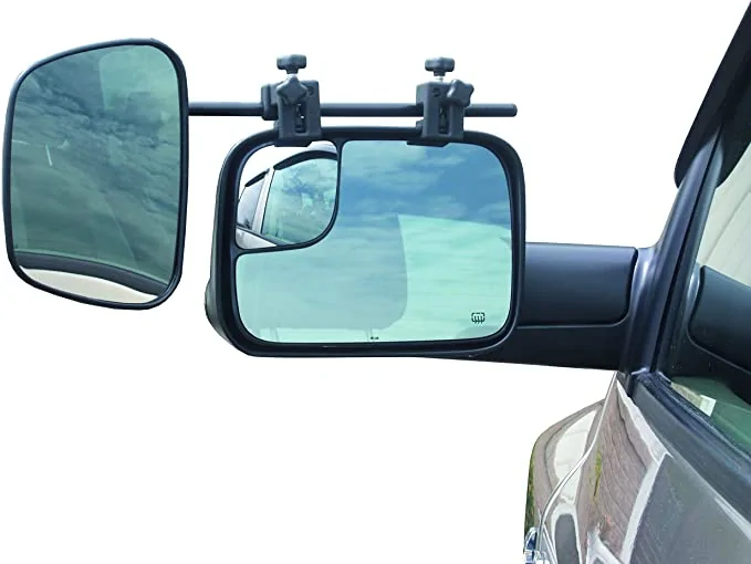

These are the ones I use. They work well for me. The strap-on ones don't work well if at all on our mirrors
Also I got an ail back from Clear View USA that they are working on mirrors for our US Rangers like they make for Australia. They said they hoped to have them out this year yet. So, maybe by next towing season for us northerners. Got my TT winterized, just need to get it in storage.
