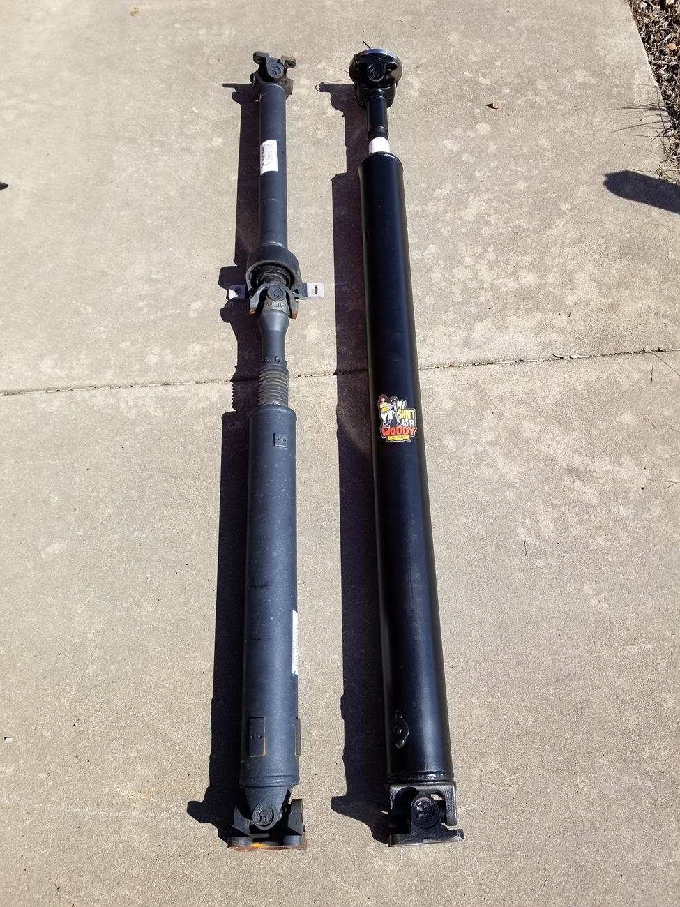

The thing on the right...will eliminate both the clunk and highway speed vibration...
Tom Woods one piece drive shaft...
Been looking into this. Definitely has to be worth the $700
Truck being 2019, I figured warranty done...for just a little more $$ you can replace the OEM with the one peice... I went thru several shimming episodes with my 2 pc. , never did eliminate the highway speed vibrations....when my Carrier bearing started to fail , it was an easy choice to go 1 pc...

Well guys I had the road force balancing done. And every wheel was off some. It helped forsure but I still have interstate vibrations so I’m really considering ordering the Tom Woods shafts.
