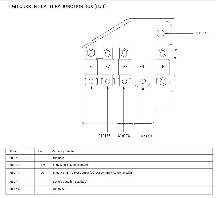

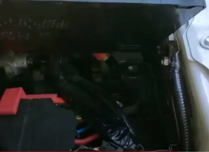

OK Thanks guys this morning in the rain I cleaned and dryed everything in the BCM and the BJB, reset back to factory settings, did the up and down thingy with the window, so far everything is working so THANKS
So, was there noted moisture in the BJB (Engine Bay)?
