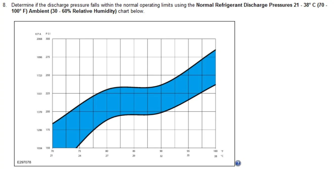

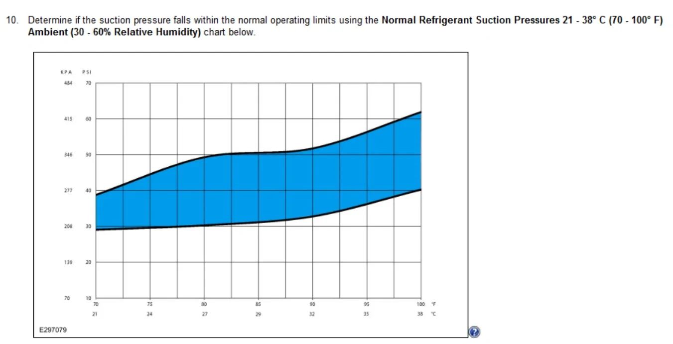

Anyone have the pressure vs temperature chart from service manual for the 2019 2.3L? I found the generic ones online, but on the F150 forums they are showing very different curves for different years and trims.
Just replaced leaking high side schraeder valve, topping system back up.

From the 2019 manual.
