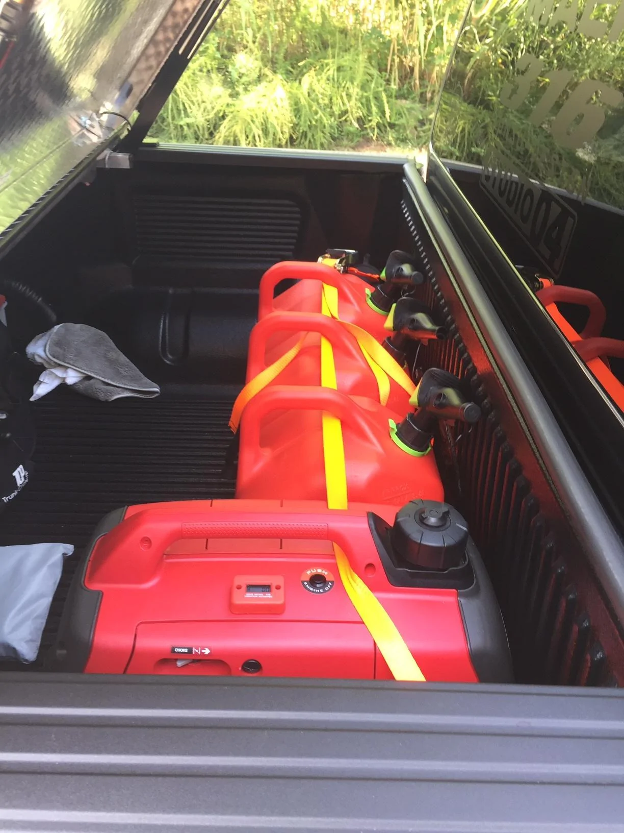

Extended fuel tanks seem out of reach for now...but, this'll do...don't worry, only one's filled:)
7,084
37,218
Boom instead of KABOOM?:)

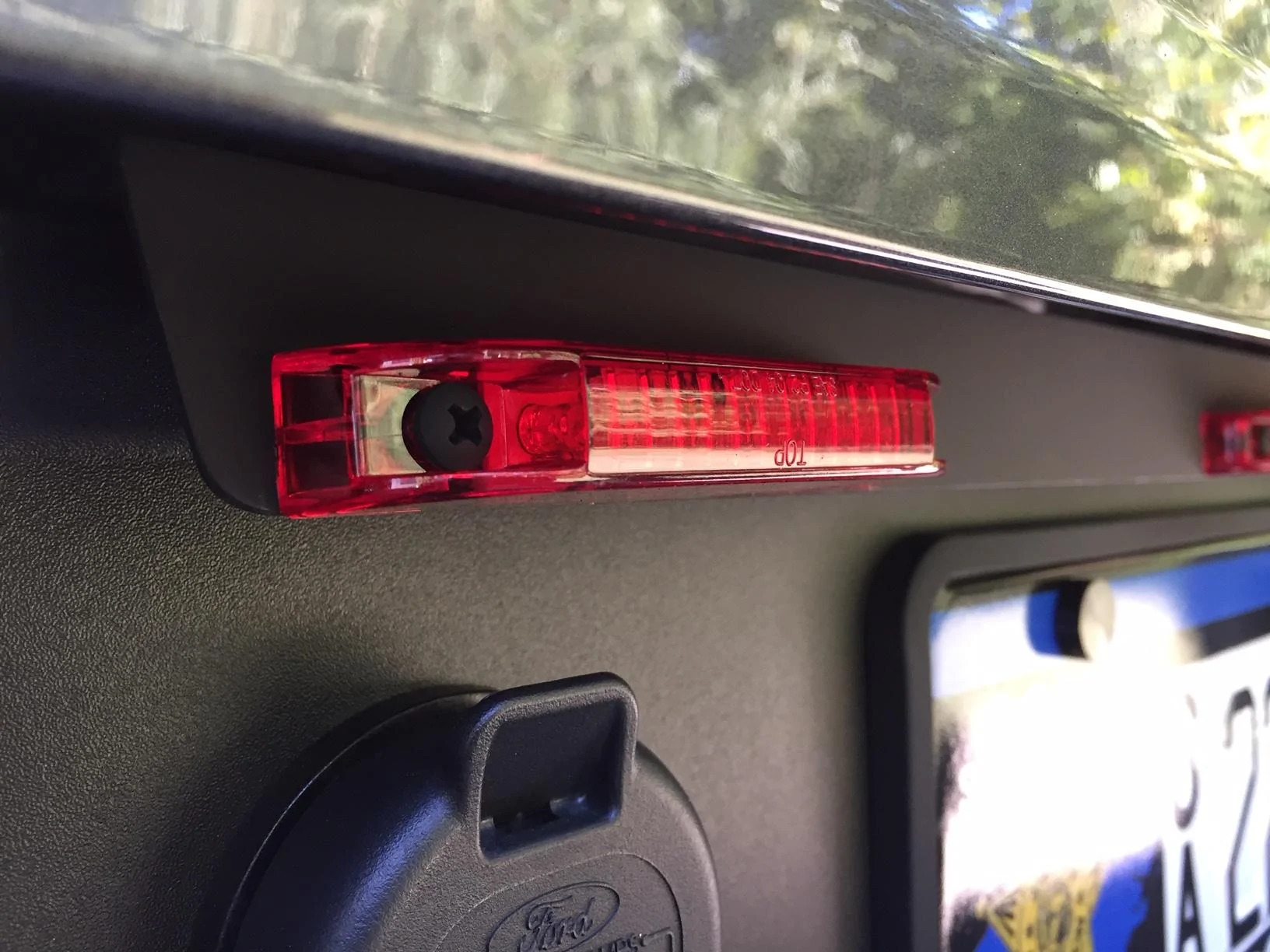

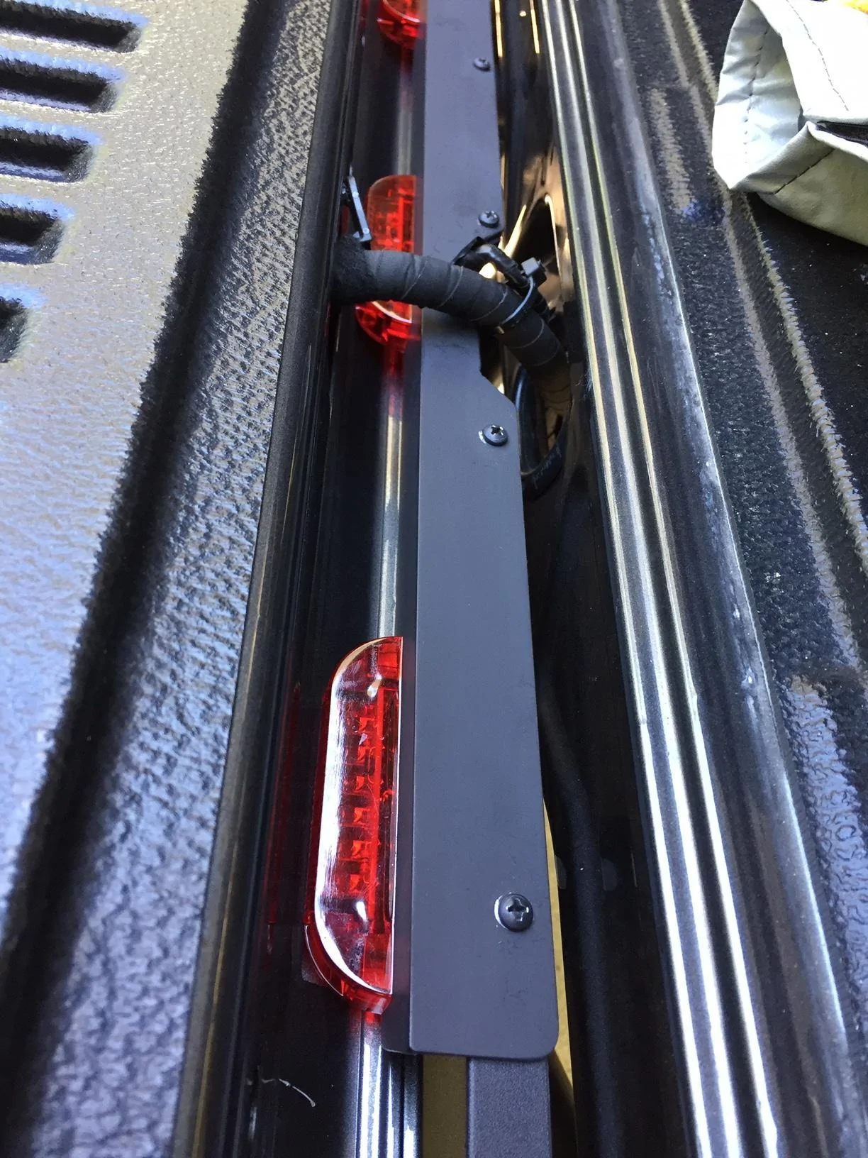

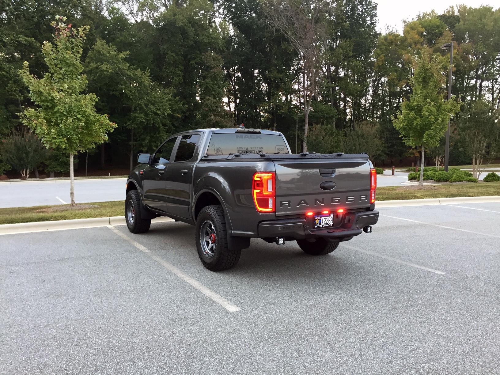

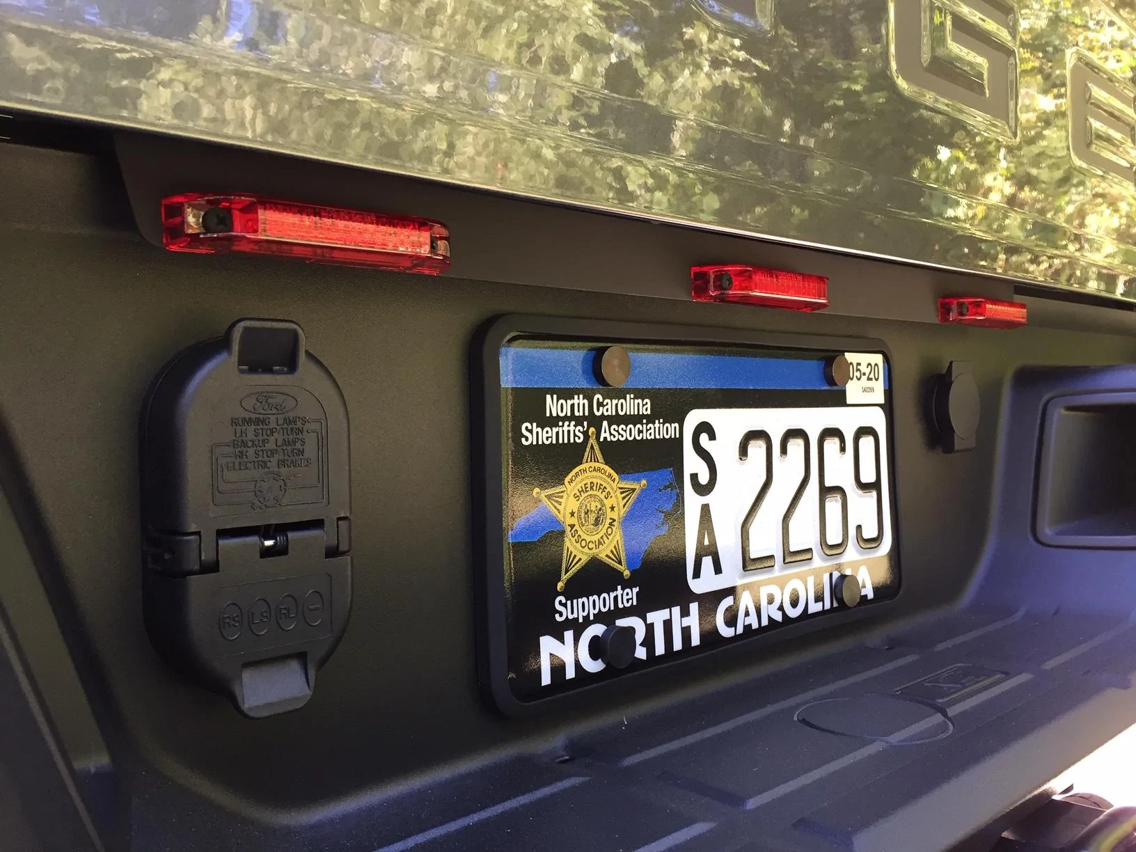

Update...red rear markers installed same as front grill LED...
Sharp eye might notice "TOP" on lamp is upside down lol...doesn't really matter as it's symmetrical...
LEDs mounted to 1" x 1" aluminum extrusion then attached to top of plastic trim...the tailgate swing clears the lights :whew::)
The LEDs are wired in parallel and cabled behind the mounting plate, run behind bumper and tied into license lamp...they don't serve as brake/turn but are always on with the markers for added rear visibility/safety:like:
