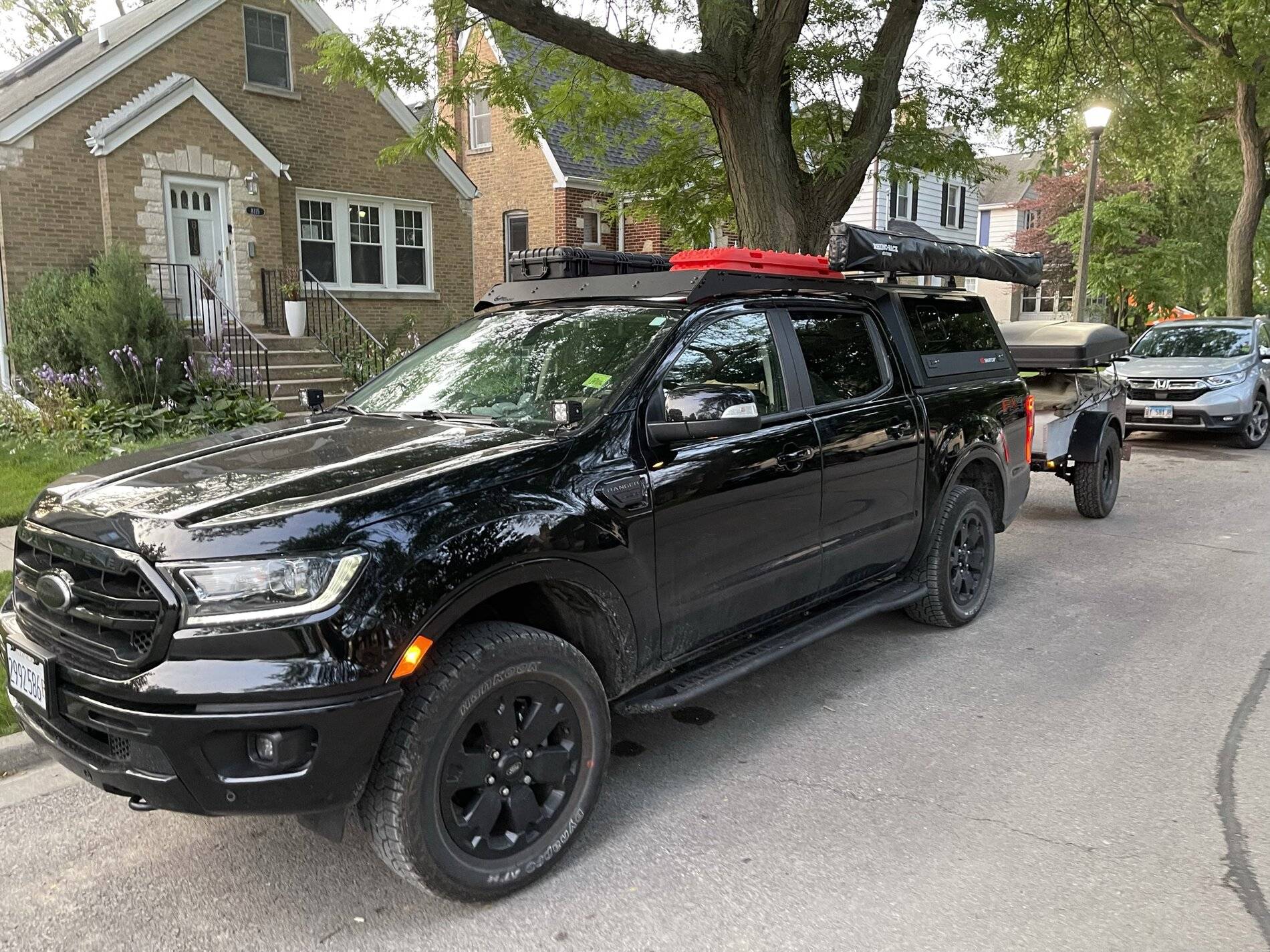

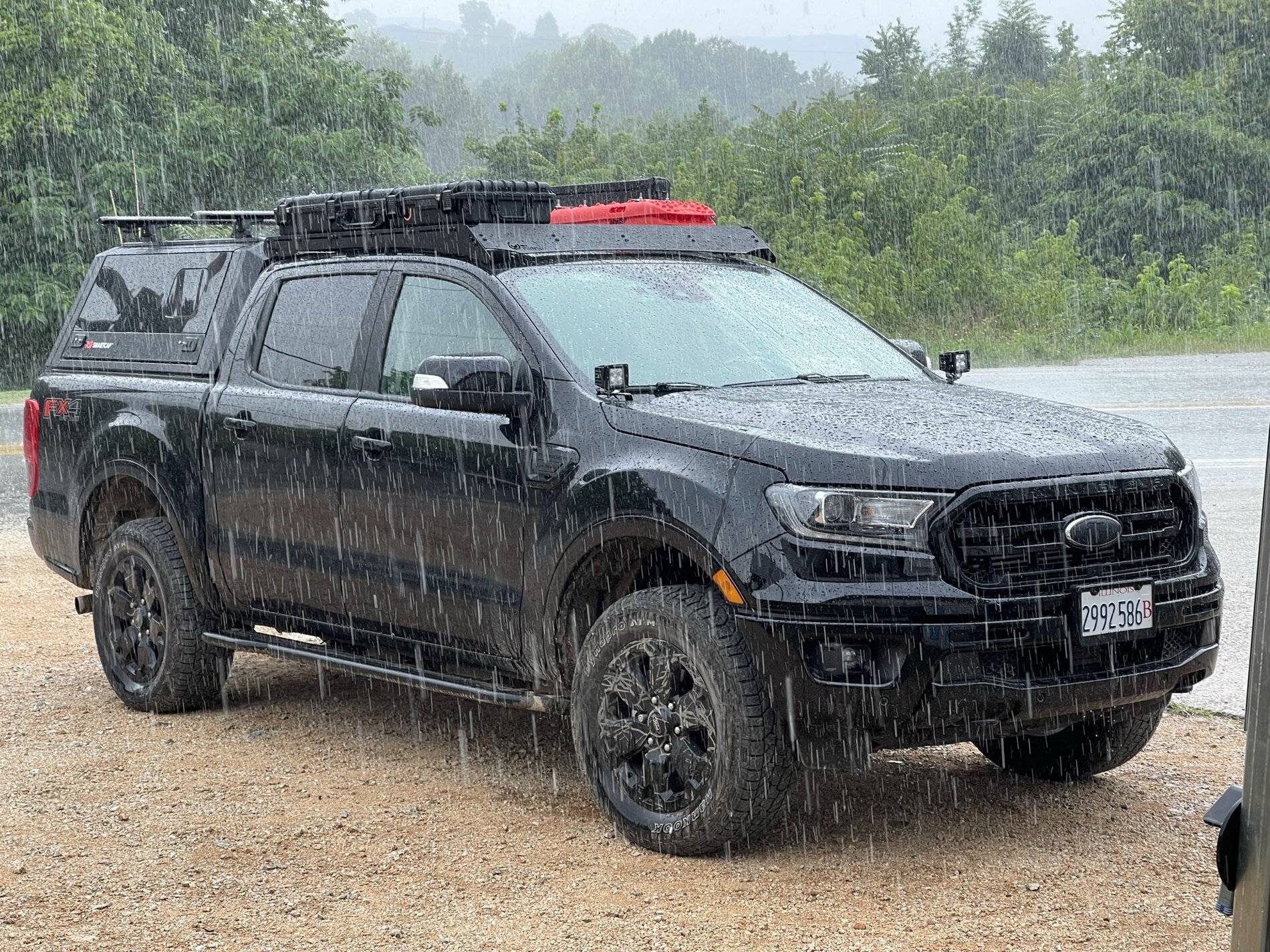

it's holding up well. Some wind noise, but any roof rack will generate noise (bought rubber strip but not installed yet)
Only minor gripe is the need for carriage bolts to attach stuff, unless you use u-bolts or drill holes (I have a rifle case and max trax permanently mounted), Cutting the strips that go in the gutter is painful ($$$ to replace) and still haven't found the right thickness 3M tape to attach the center portions
All in all very happy and it looks great.

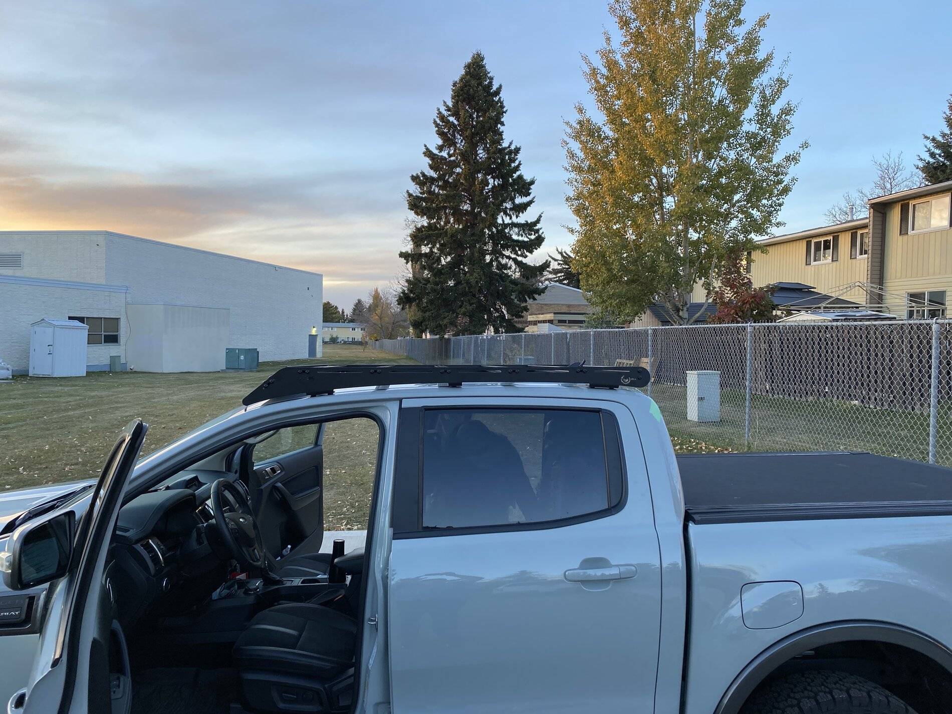

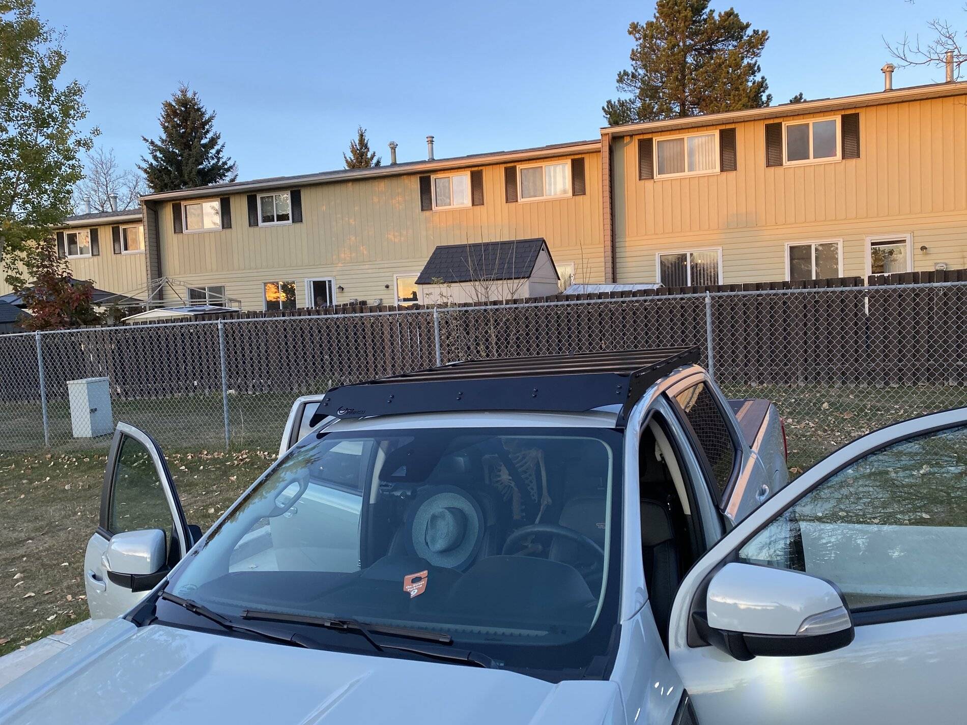

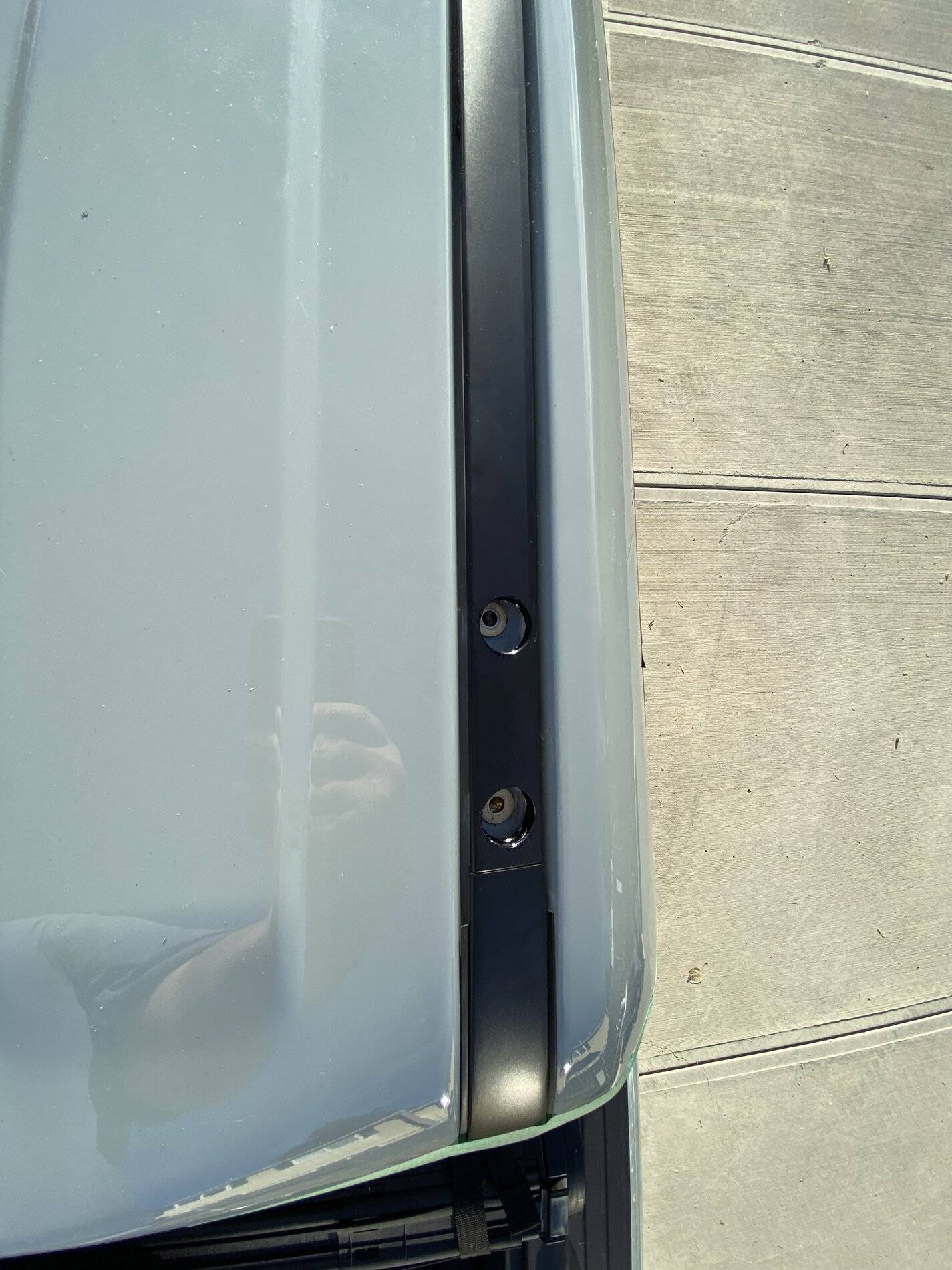

Got the rack installed. Drilled the gutter trim so it could be reinstalled. Really happy with how that turned out. Have only driven it two blocks since the install. Will see if I need to address wind noise.
Thanks again for the input.

Nice job Dan!
