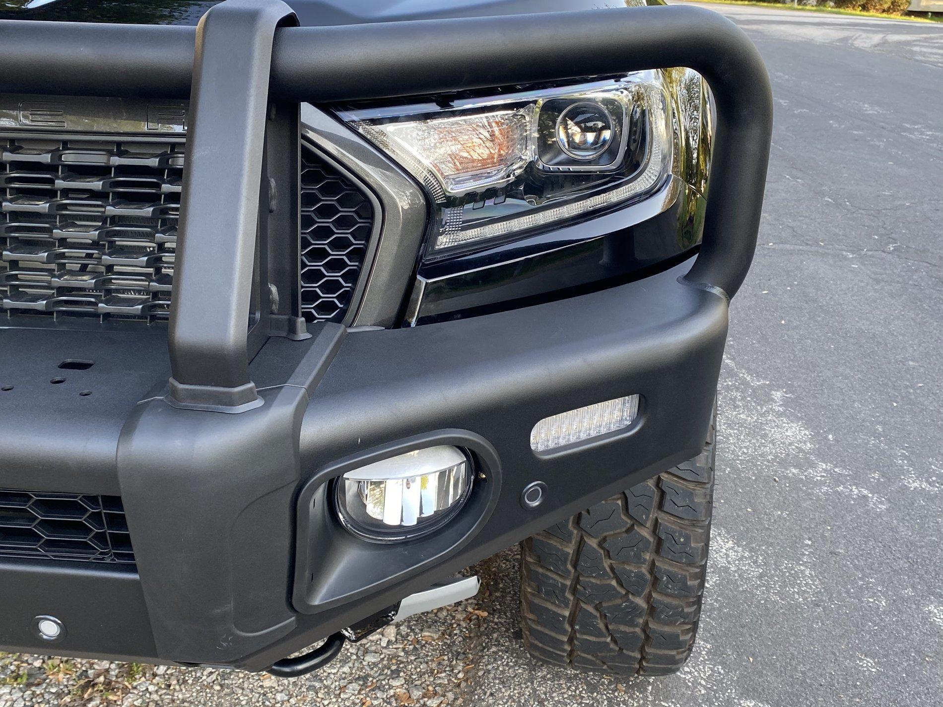

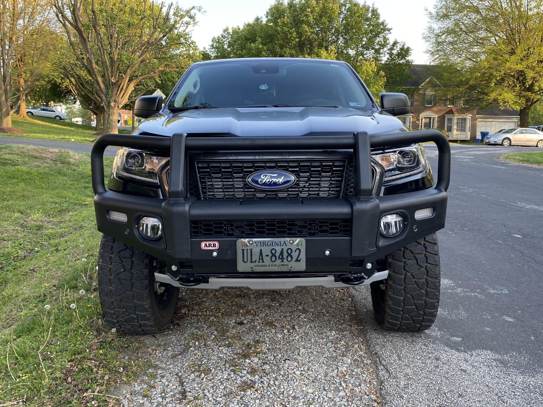

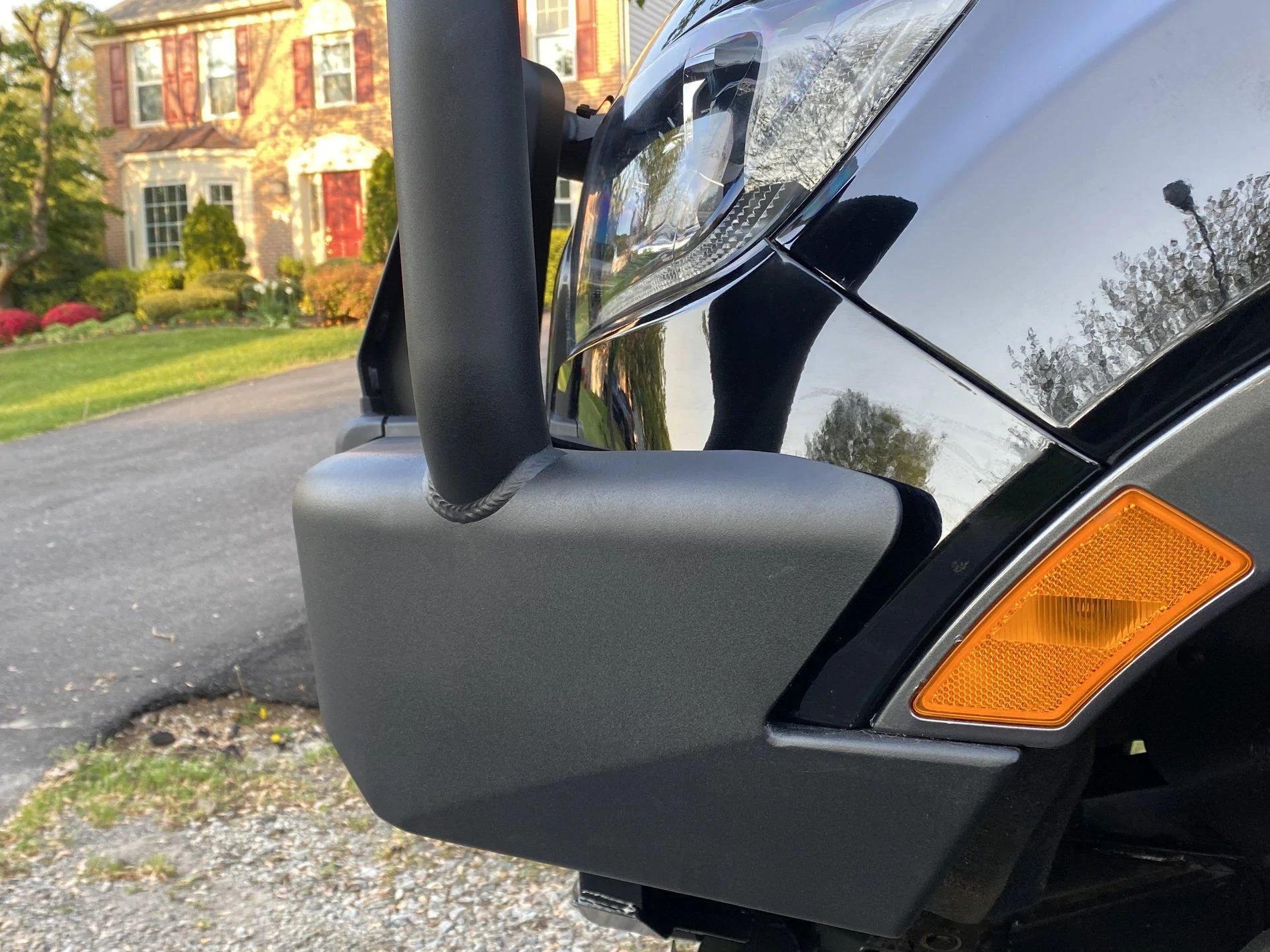

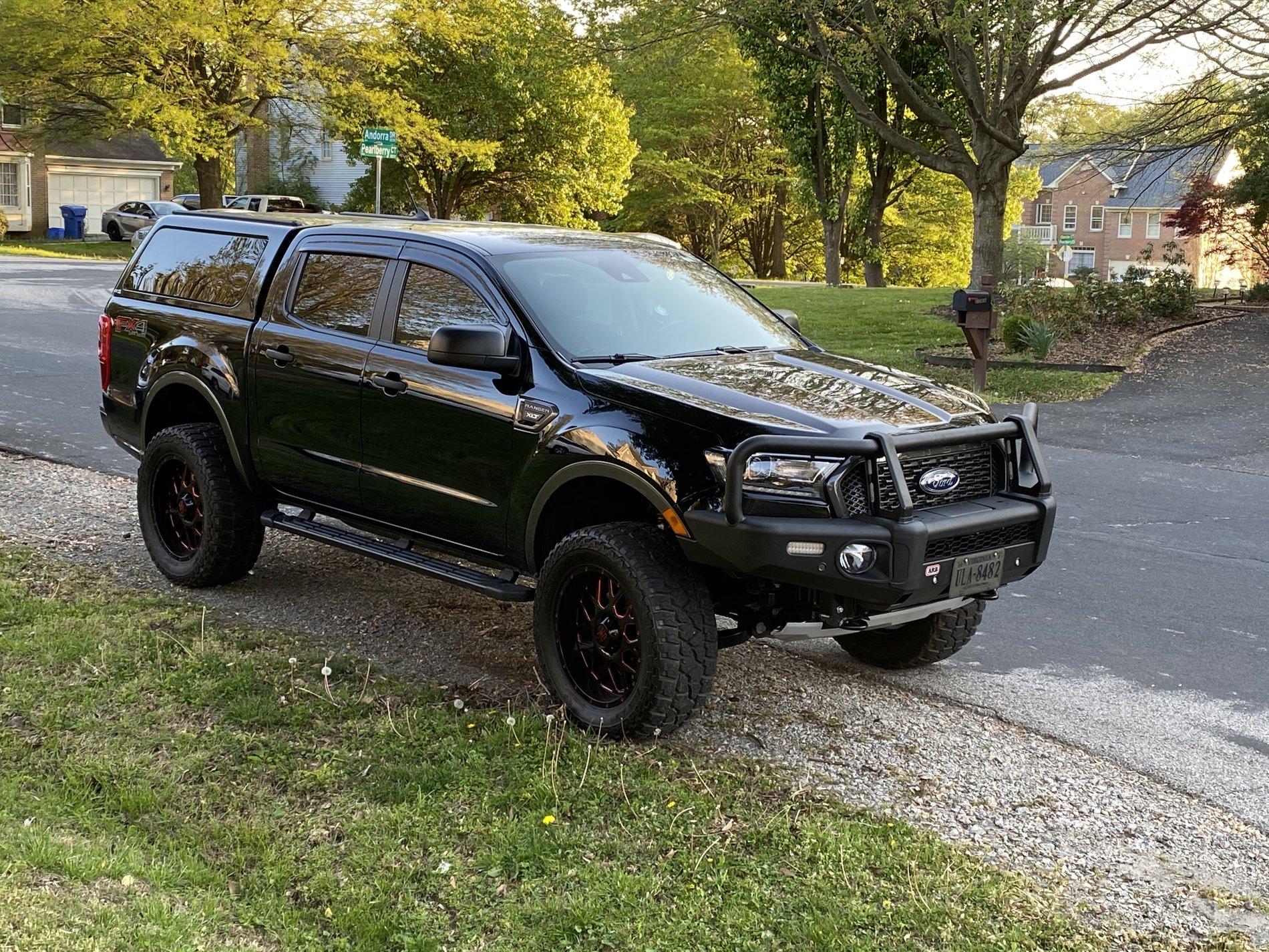

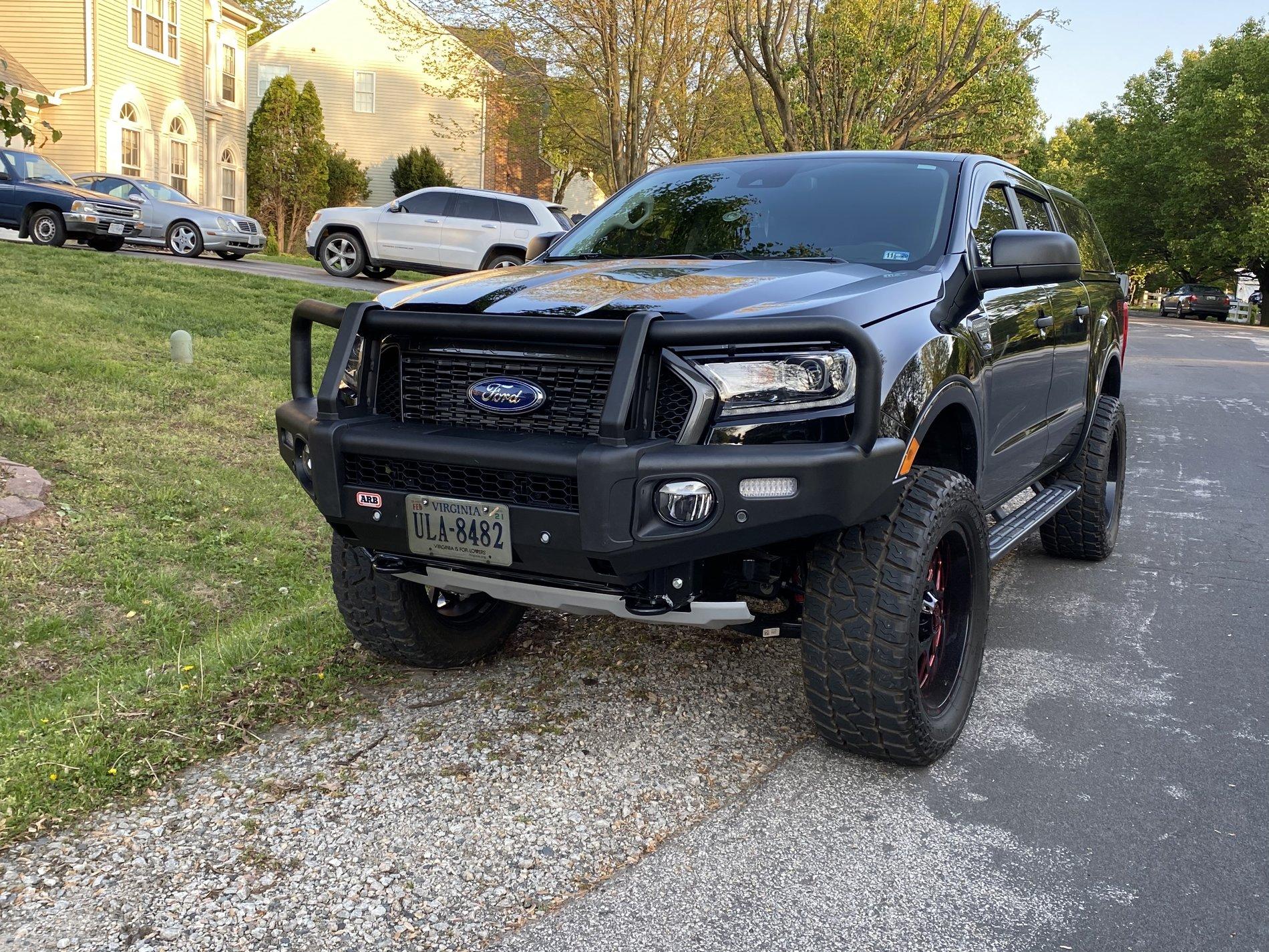

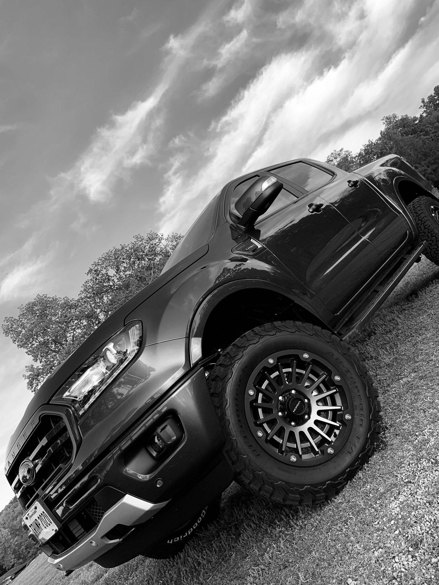

How was the bumper install? Did it require any cutting or was it a direct fit. Thanks
A local 4x4 shop installed it. I don’t see any evidence of cutting and they didn’t mention anything to me beforehand.

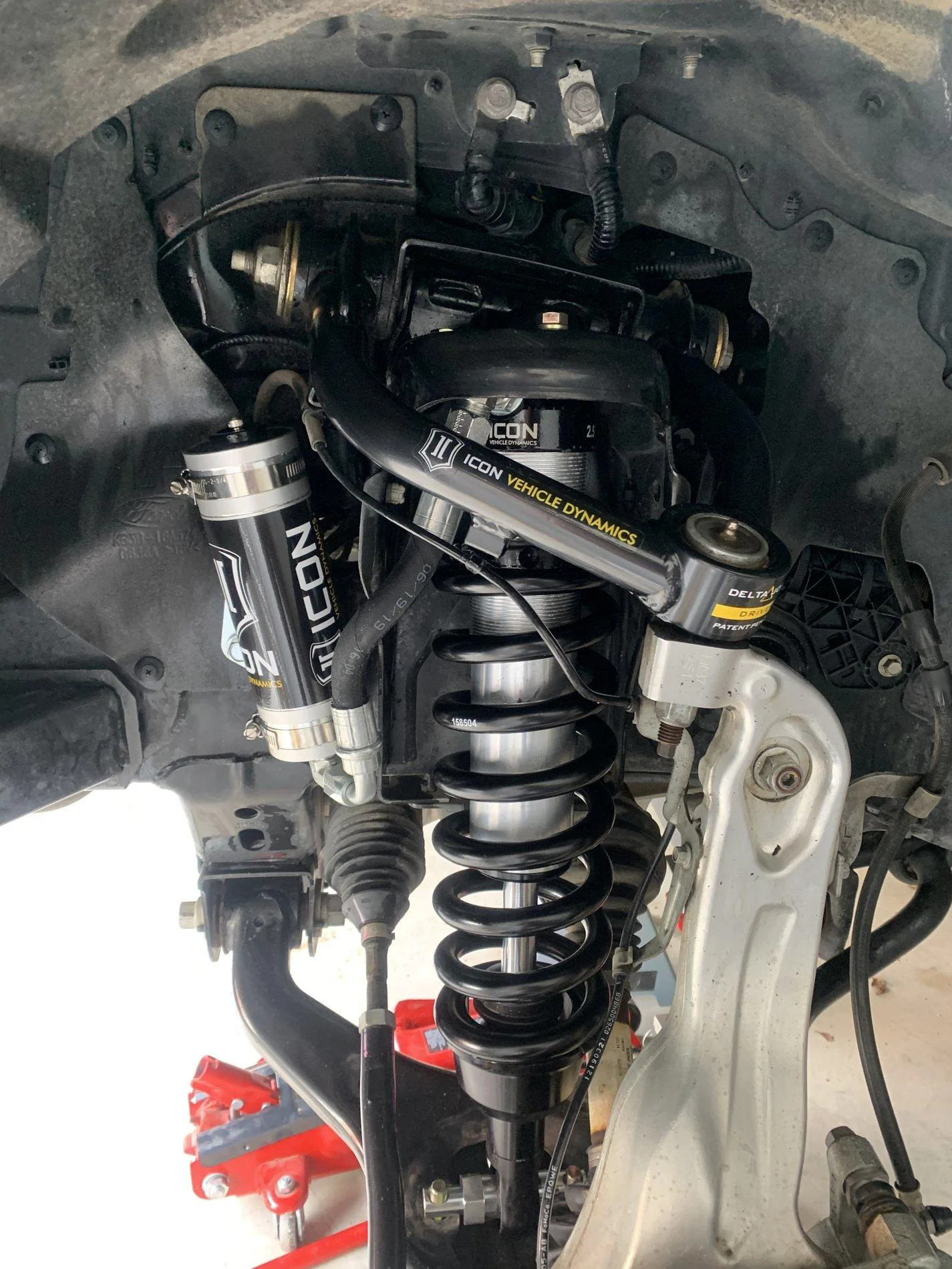

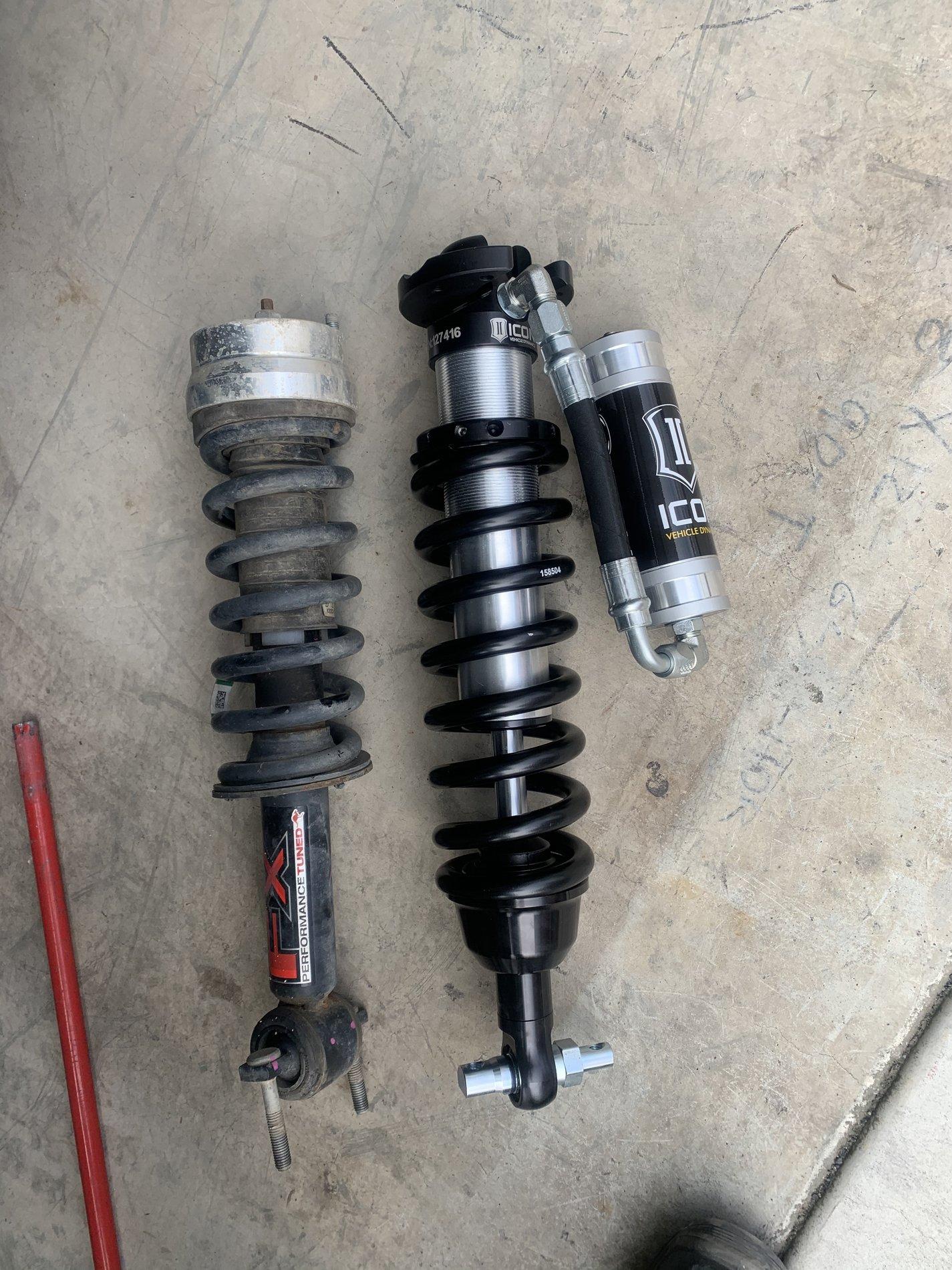

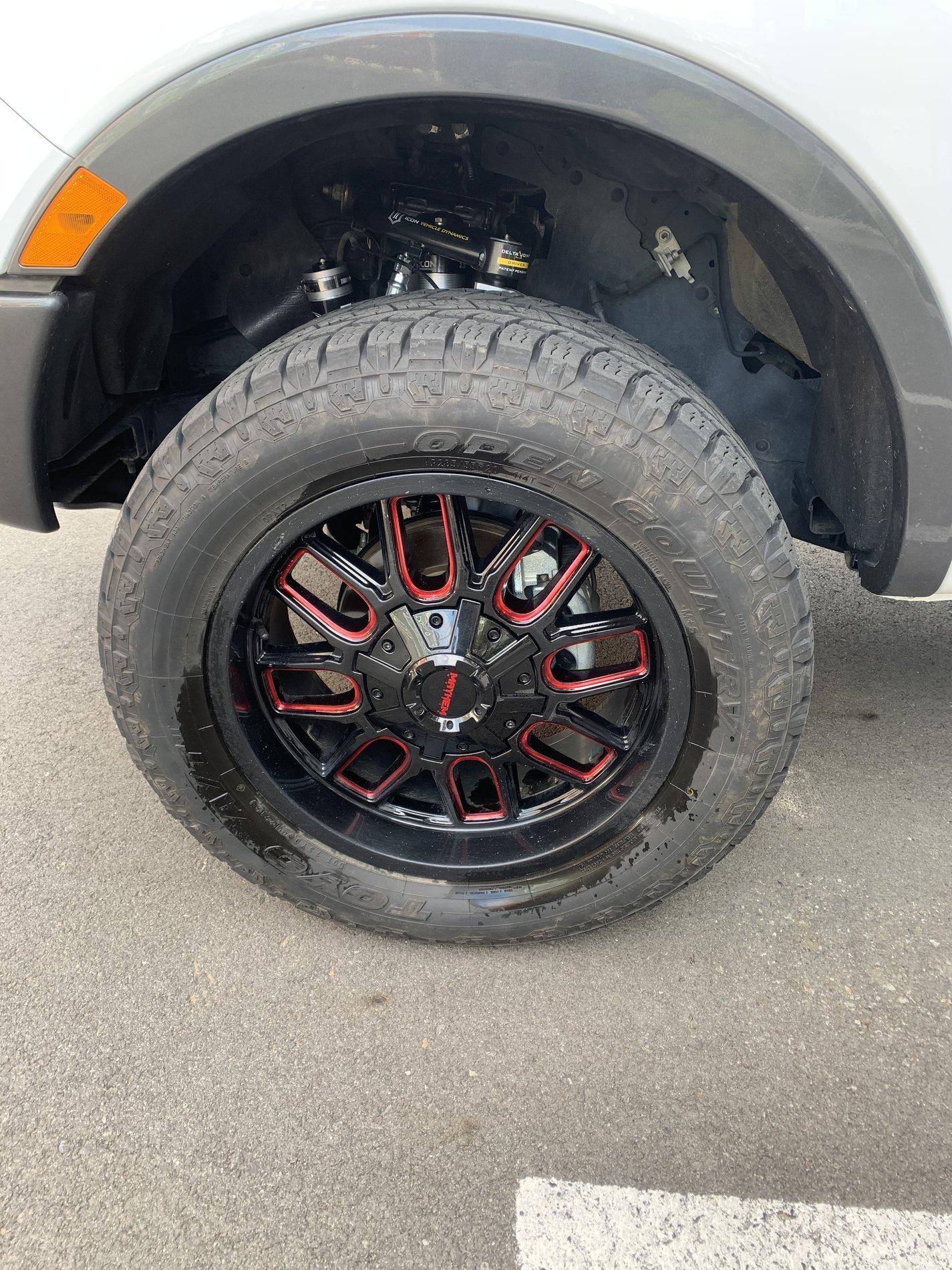

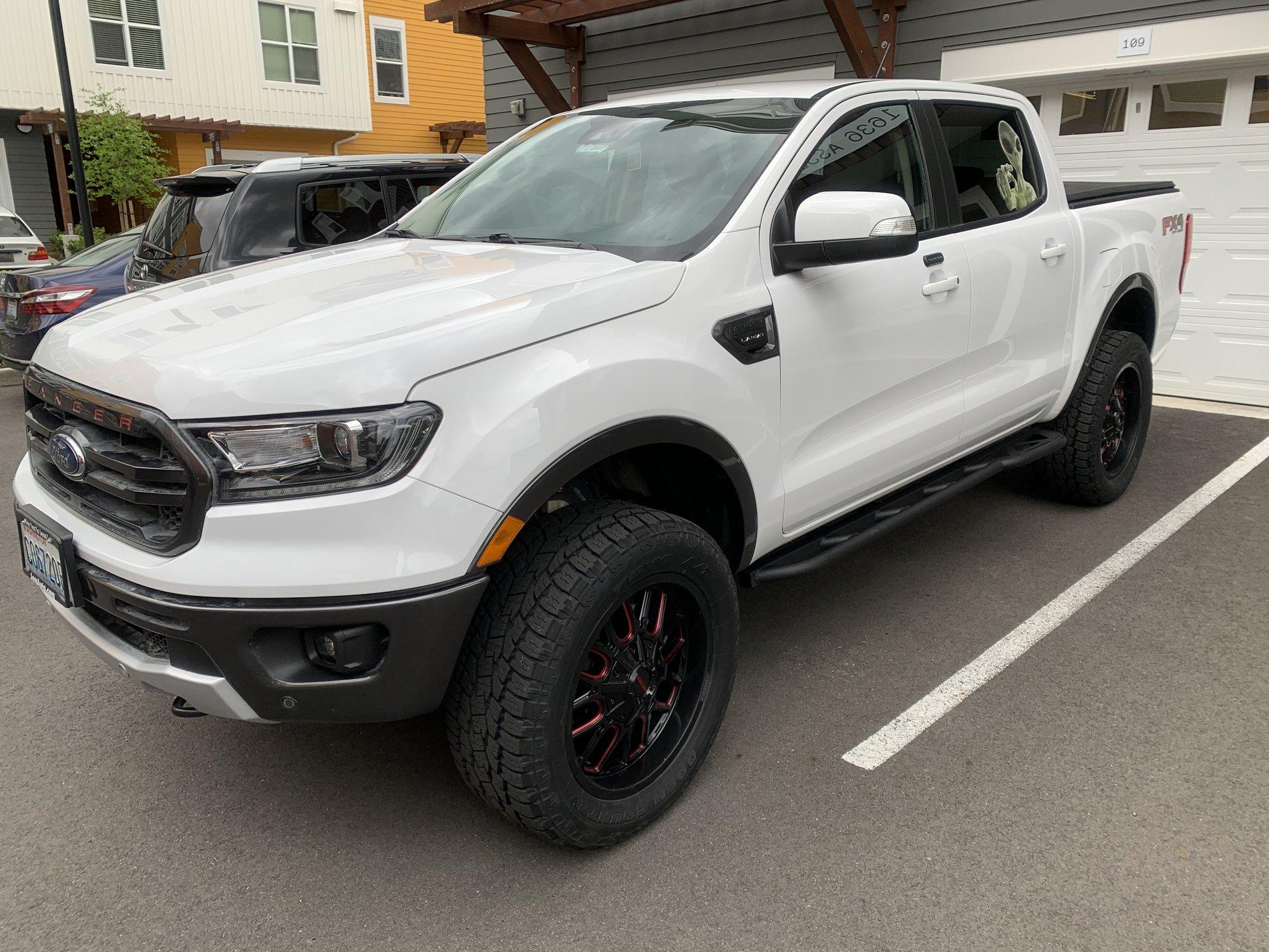

I Just upgraded to 2.5 Icon Extended Travel Remote Reservoir Coilovers from the 3” SST lift and it’s a world of difference! The handling is amazing!
At some point I would like to upgrade to these. Congrats!

It’s completely worth it! I was hesitant because I’ve seen reviews of stiff ride quality but they made them perfect for the Ranger. It’s well worth the money. Install is fairly easy although you do have to drill through your frame with an 11/32” drill bit for the reservoir mounting bracket. If you do the lift yourself just disconnect the brake line, wheel speed sensor line, sway bar, and then drop the lower control from the frame. If you do it the way any of the instructions say for the lift it takes about 3X the amount of time to finish and you have to overextend your CV joint.

Good to know!
