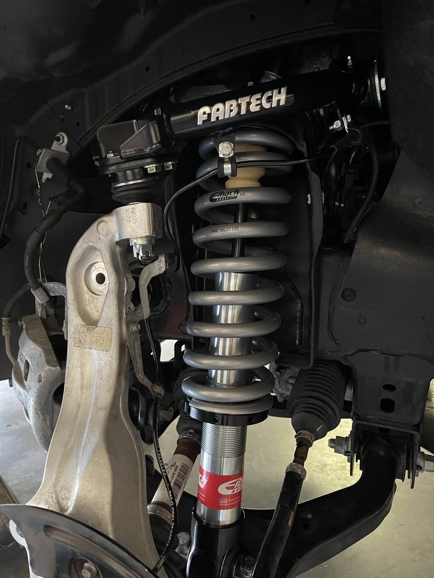

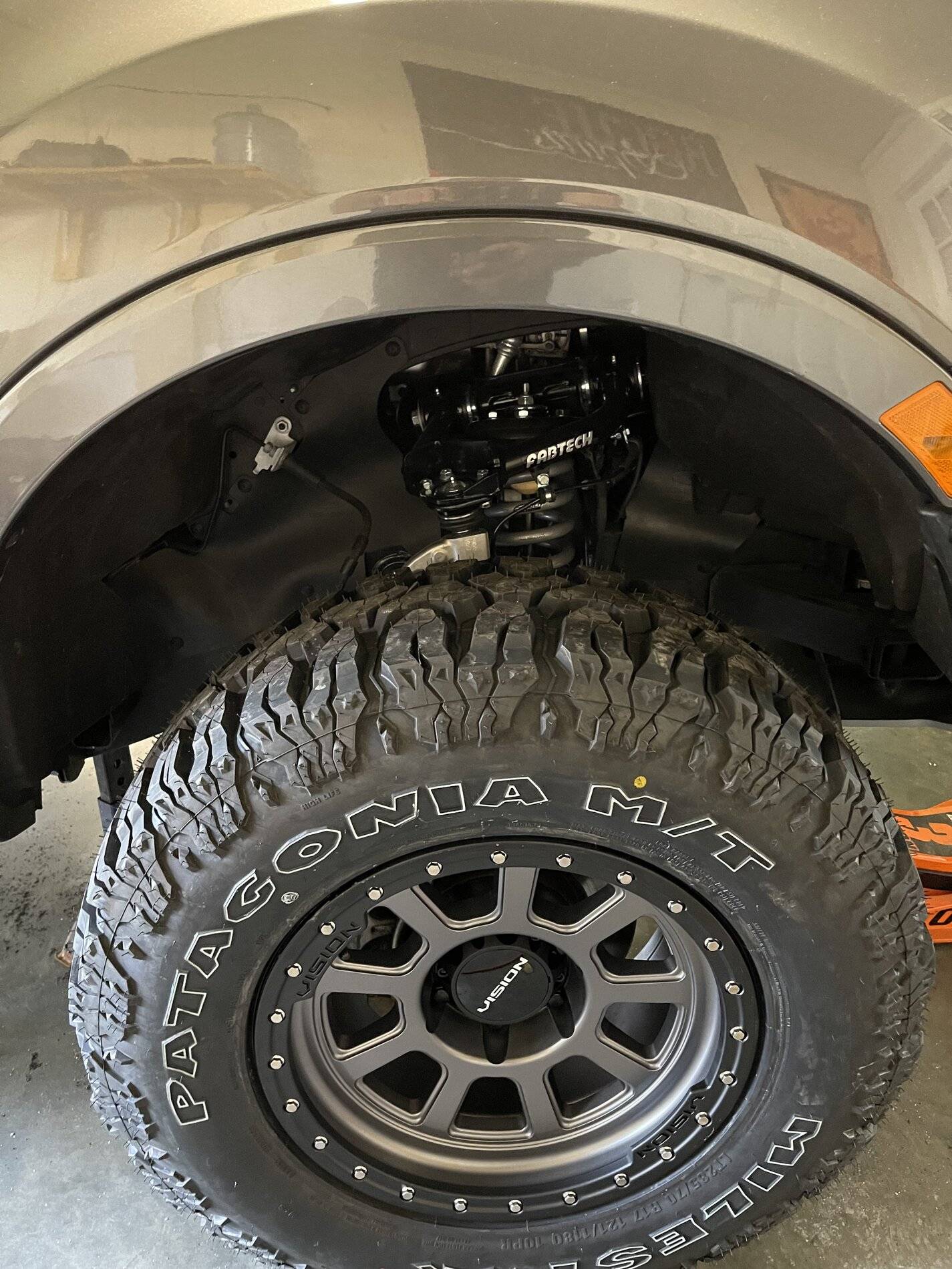

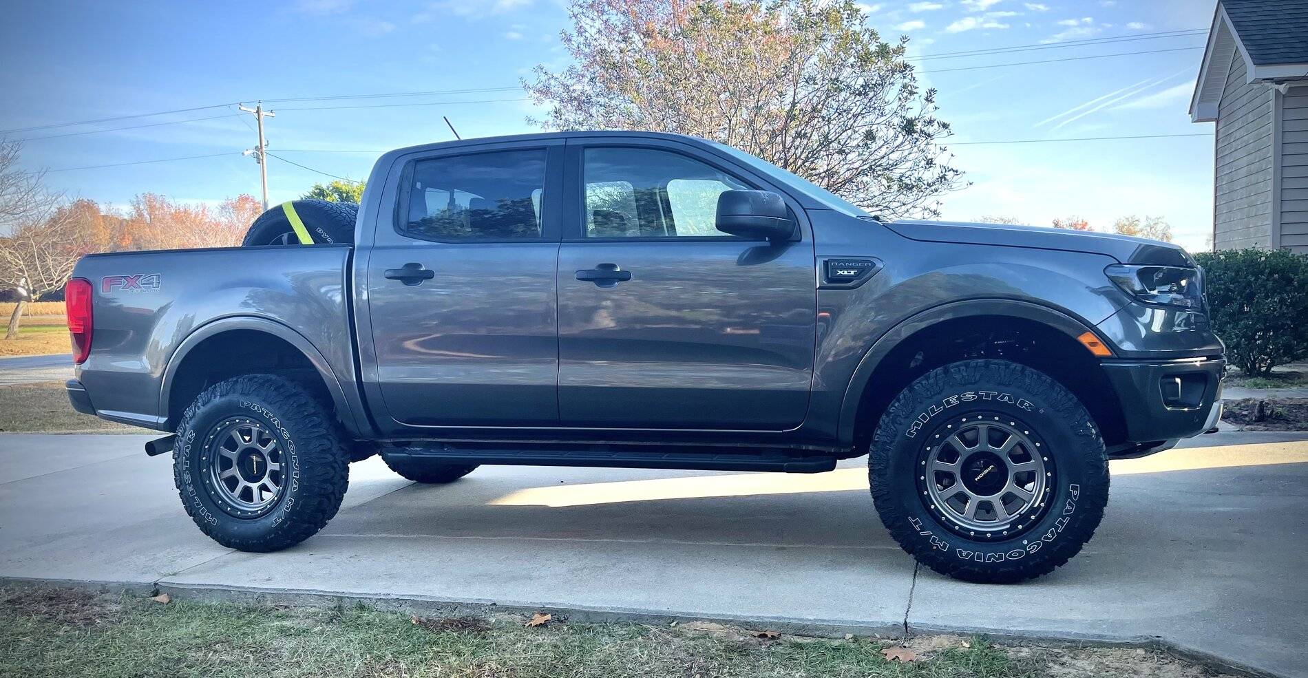

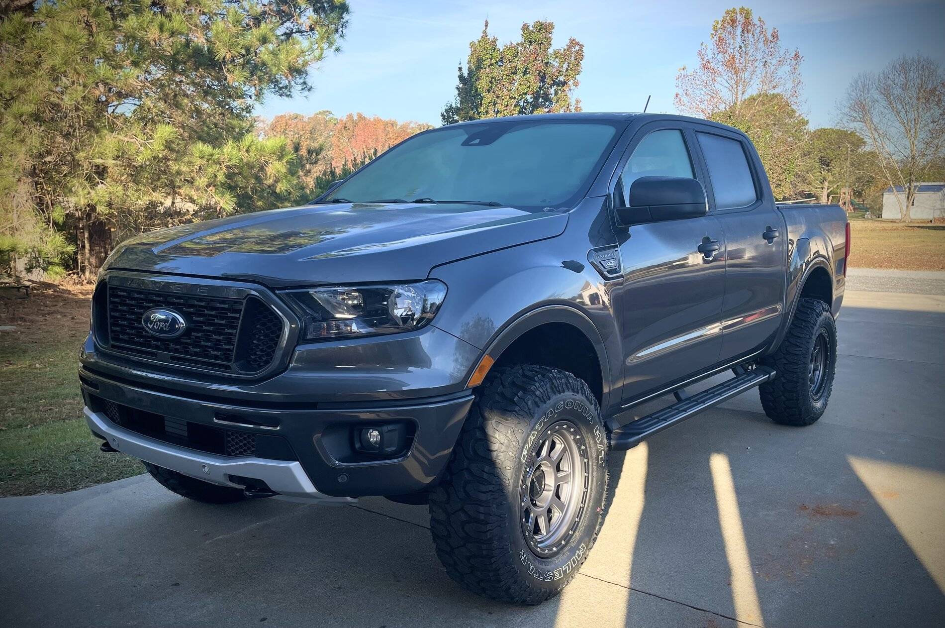

Busy weekend. Got everything installed yesterday. Parts installed. I LOVE how my truck looks and drives now.
Eibach Pro 2.0 adjustable coilovers and matching rear shocks front is set at 3 inch lift from stock.
Fabtech UCA’s
Fabtech rear 1.5 in lift blocks
285/70-17 Milestar Patagonia MT’s
Vision OJO wheels 17x9 with -12 offset
Crash bars removed.
SCT BDX for tire size calibration
Very tiny bit rubbing on plastic liner at full lock.

Nice setup Trevor. Nothing looks better than aluminum knuckles - I like those UCAs too - adding them to my list of considerations for the Spring.
I‘ve noticed a trend on this forum - truck owners from Northodox Carolina down to Florida seem to love the negative offset or huge wheel spacers - I see you have 17s but many also have 20” wheels. Not being a smart Alec, just wondering…is that a ”thing” in your part of the U.S.?

Thanks my setup has about 2 inches of poke. It’s about as much as I wanted. Yeah there is a trend here with 20 inch or bigger wheels with insane offsets. I hate how that looks. I trail my truck so I like keeping it functional.

Notice you removed the sway bar. I have the same coilovers. How does the ride feel? Been thinking of removing my sway bar. Thanks nice rig btw

I kept the sway bar, that picture was taken during reassembly. I have considered running quick release links when I go crawling.
