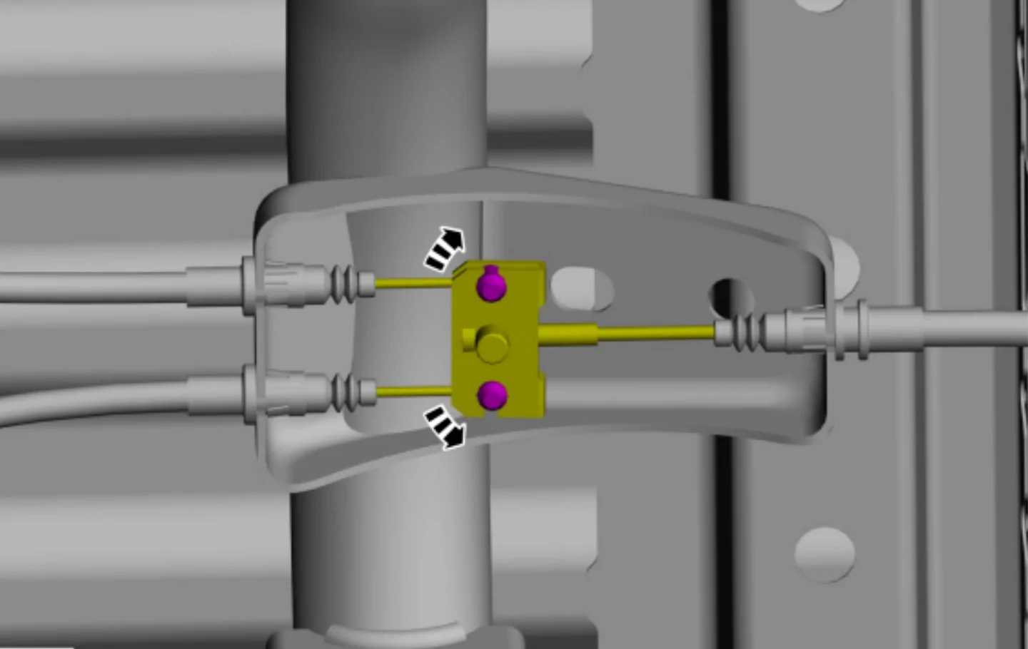

Just a quick screenshot to add to airline tech's post.
An easy thing to see is the equalizer (I think it's called).
This is the "Y" mentioned above.
Check to be sure it's similar to the picture, and not cockeyed/rotated.
edited - oops forgot the picture.
