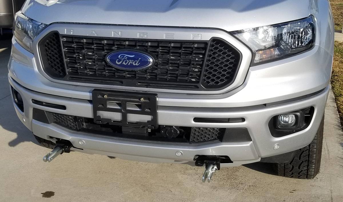

Those are toy tow hooks. I wont paint them until they get scratched up pulling toys out.

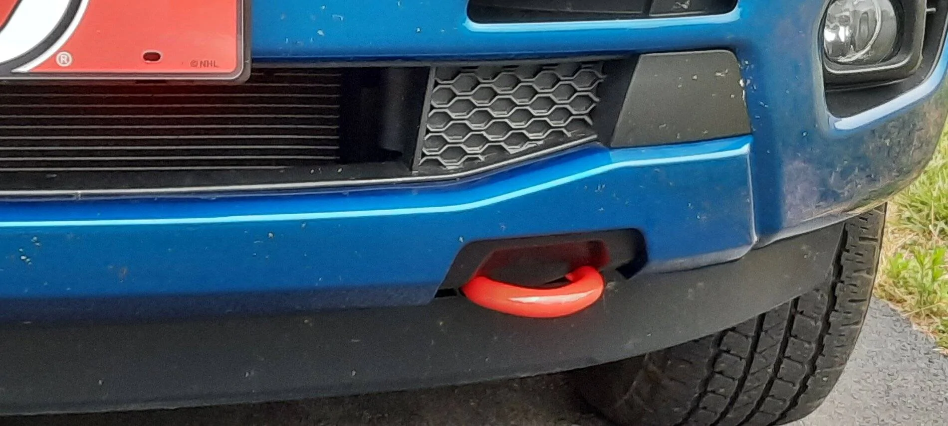

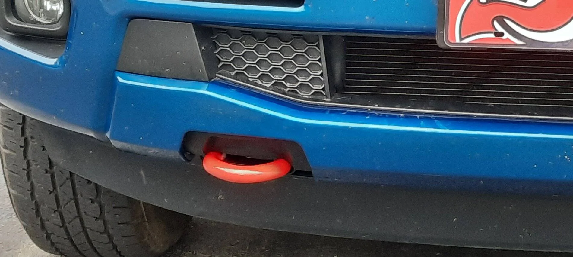

What paint brand and color did you use?
Rust-oleum Strawberry fields and a 1k Clearcoat.
sanded the part 600 grit
sprayed 3 coats of primer
sanded with 800 grit
3 coats color
3 coats clear

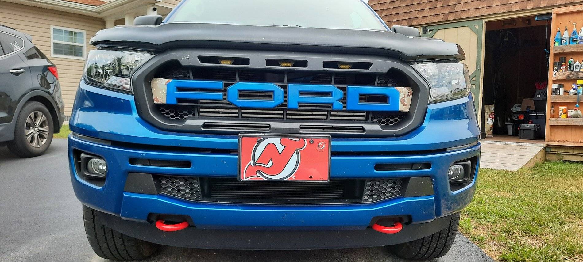

Painted the tow hooks red. what do you think?
That does not sound like fun.. You did not get the air compressor out and get the spray gun out and do it?
How do you like that bug shield? I would spend money on the Putco lower grille to protect your intercooler. I also would like to know where you got your grille lights...
Looks good, keep us up to date on how well the paint holds up to the seasons.

grill lights came with the grill. ordered it from Australia. like the bug shield installed easy, no drilling.

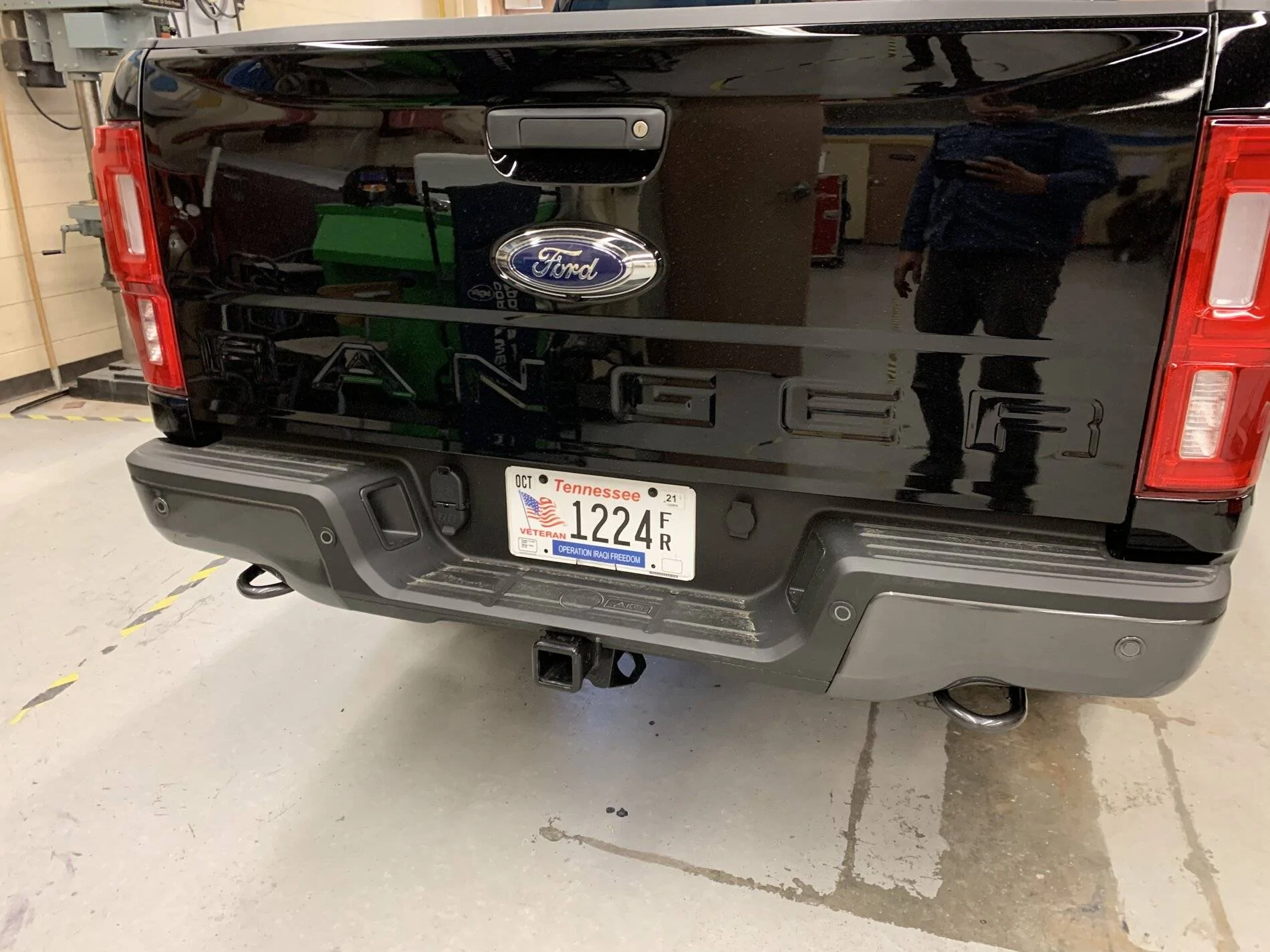

I made some shackle mounts for the front and modified these to go on the back.
