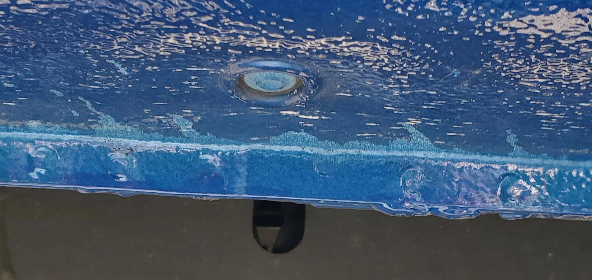

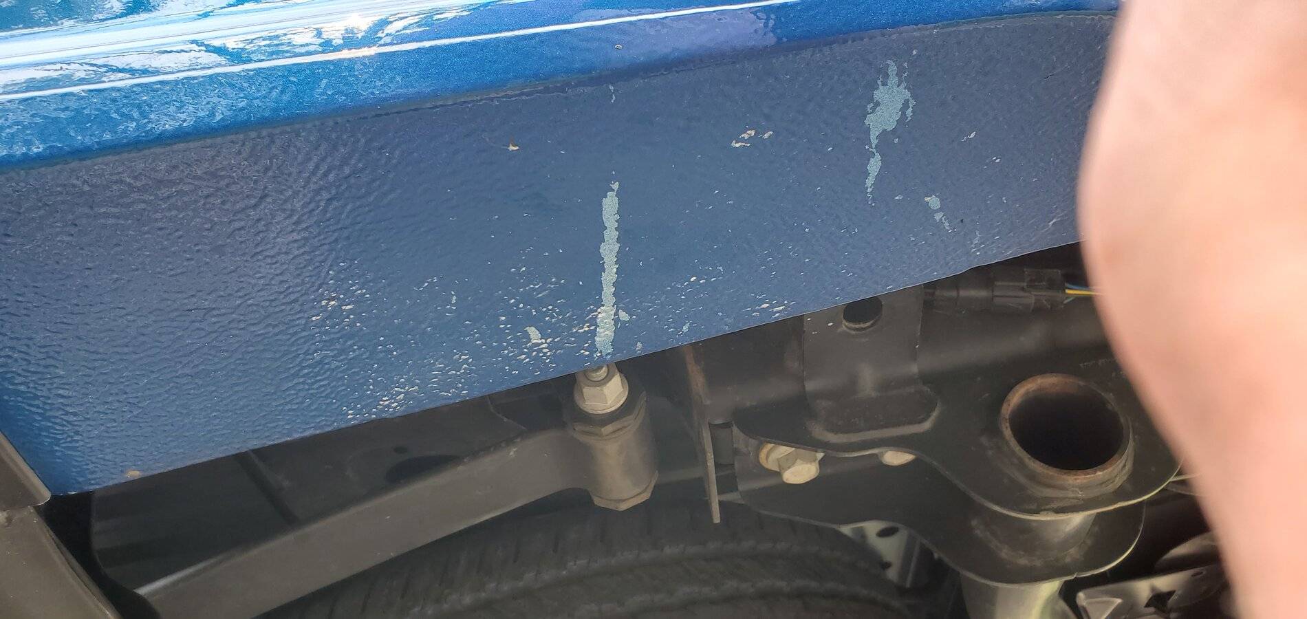

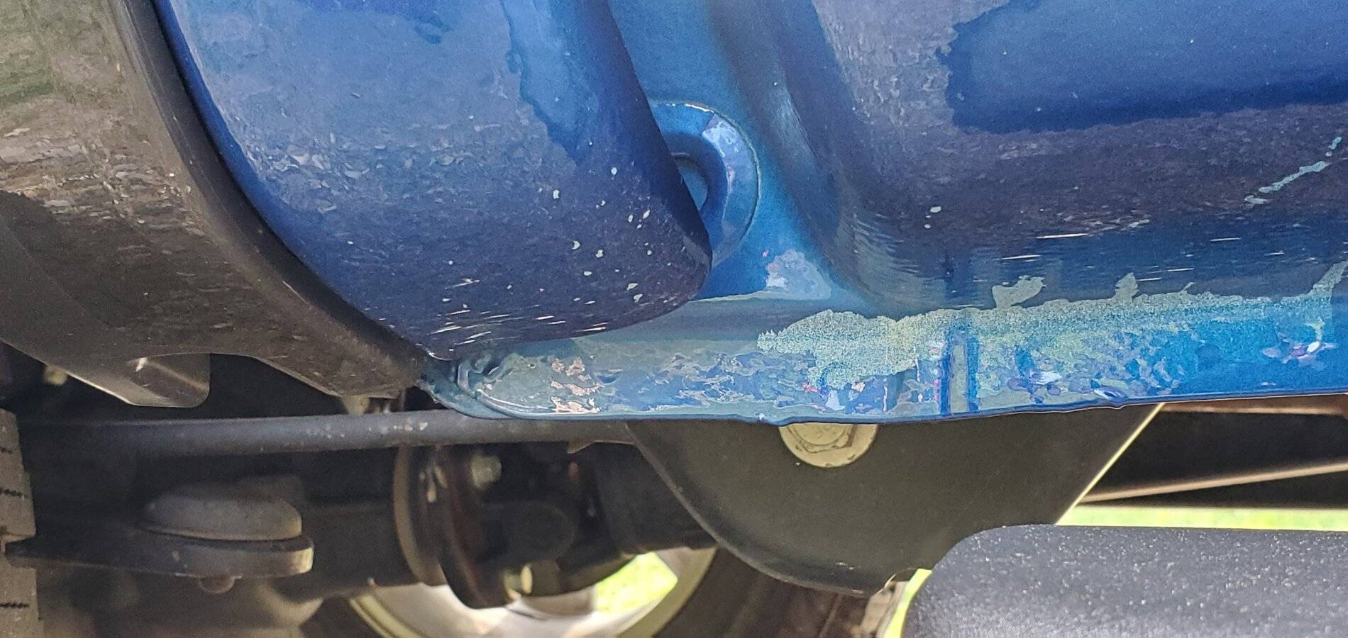

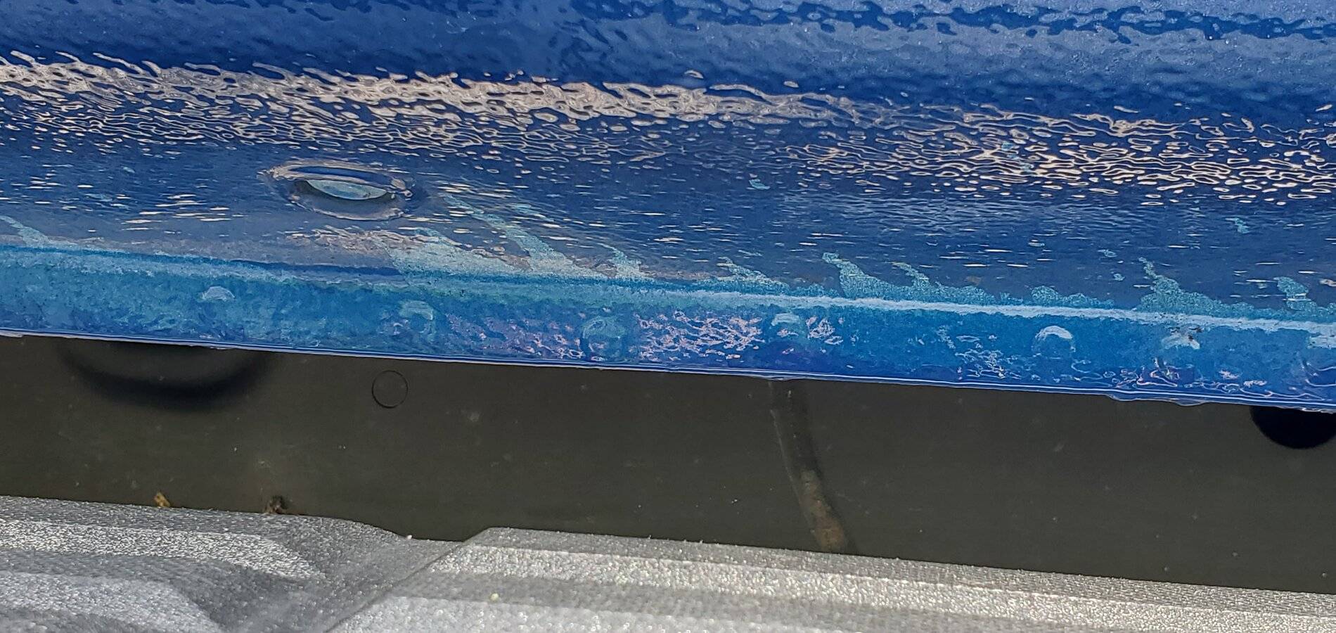

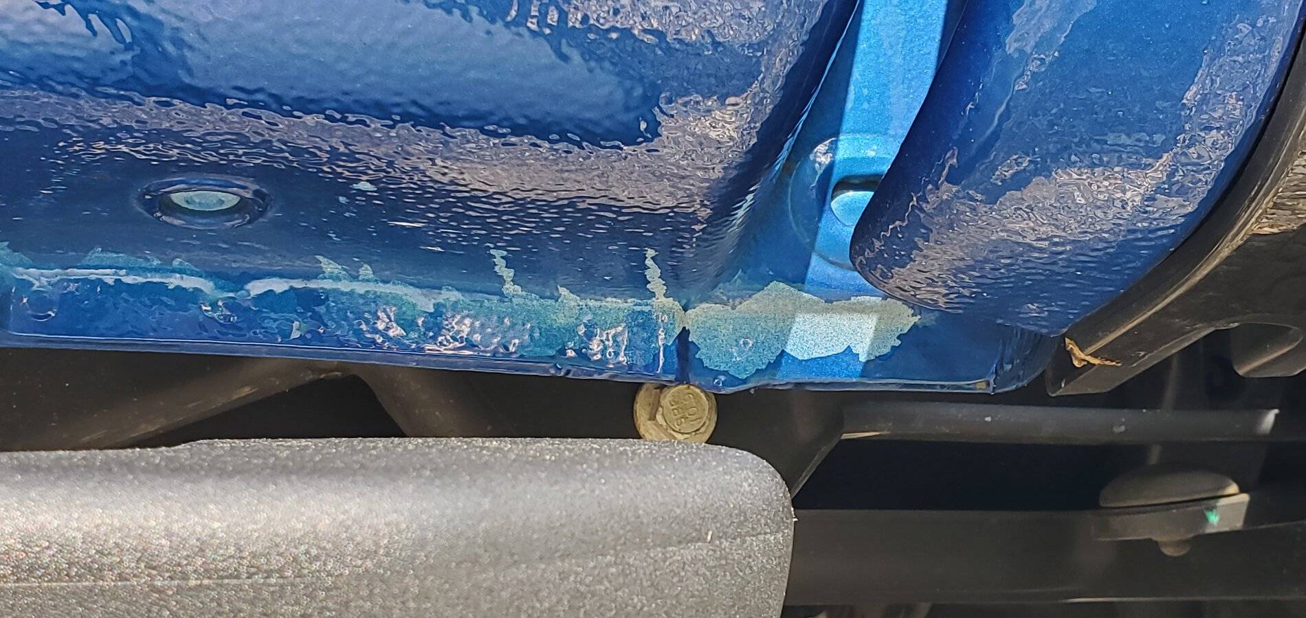

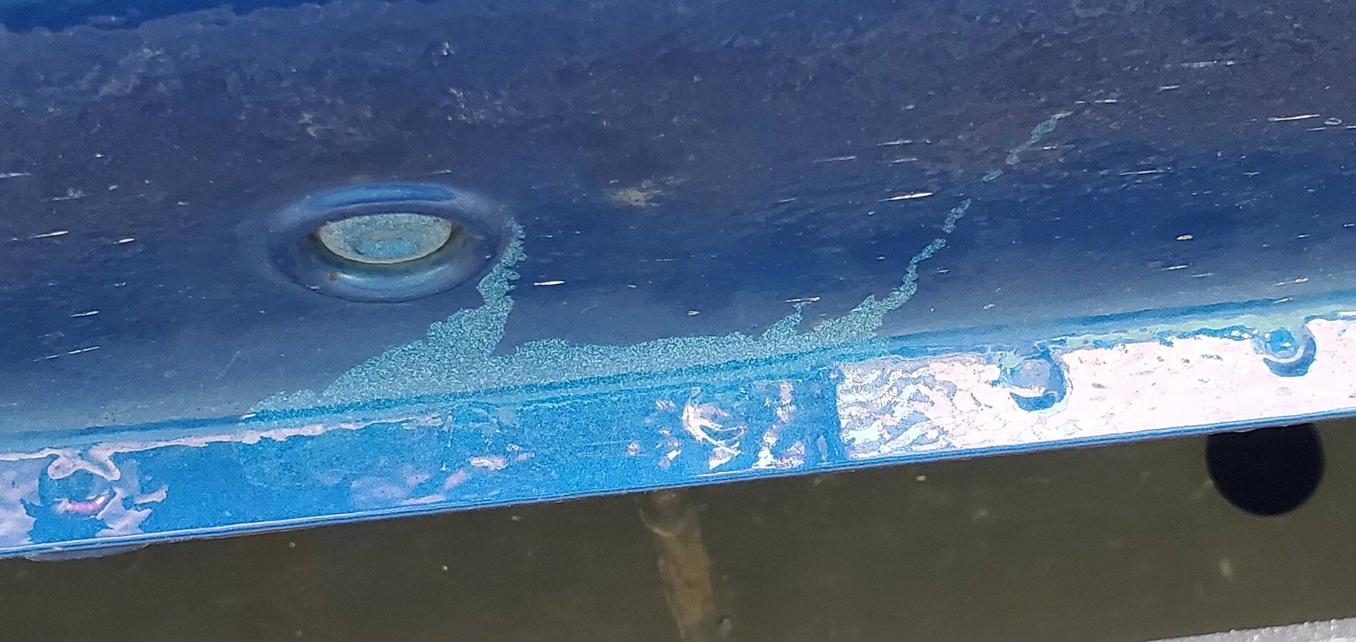

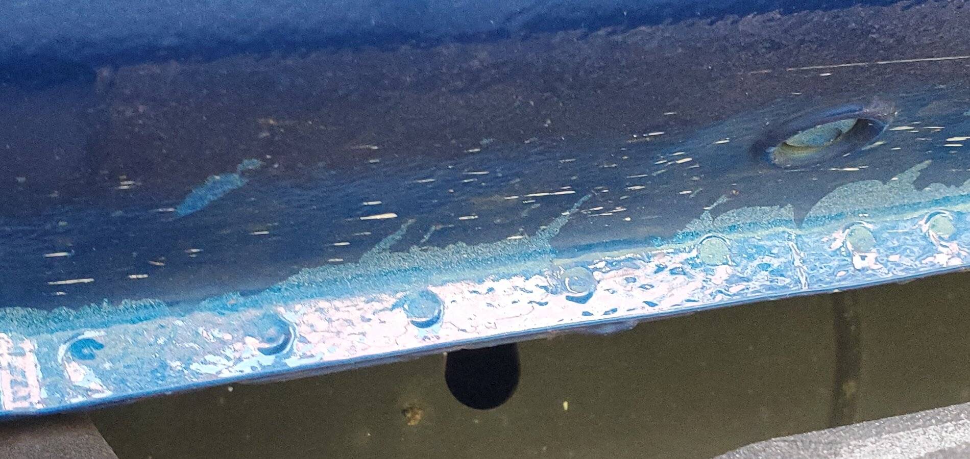

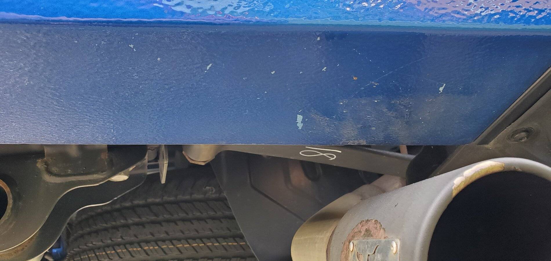

FINALLY after 5 months of battling the DEALER not ford, my truck is at body shop to get painted. The paint was peeling on the Rockers and the bedside, pretty significant sad part is I had to show the service department how to submit the claim to Ford and then I had to wait two months for a loaner vehicle because it will take 2 to 3 weeks to paint the entire truck, you gave me a tiny ass ecosport to drive around, I miss my truck already

Yikes! Looks like contaminated body panels.

you've got the standard rock chips and scratches which i am sure they would have fought you on.
I have no idea whats caused that other frosty looking mess though.
contamination before the paint or clearcoat was applied?
some sort of contamination from the road or the environment?
either way, glad you are getting it looked after. Im sure in a year or two it would be looking much worse.
From what I'm told. Ford put a rock guard coating on and THEN painted over it without using a primer 1st
