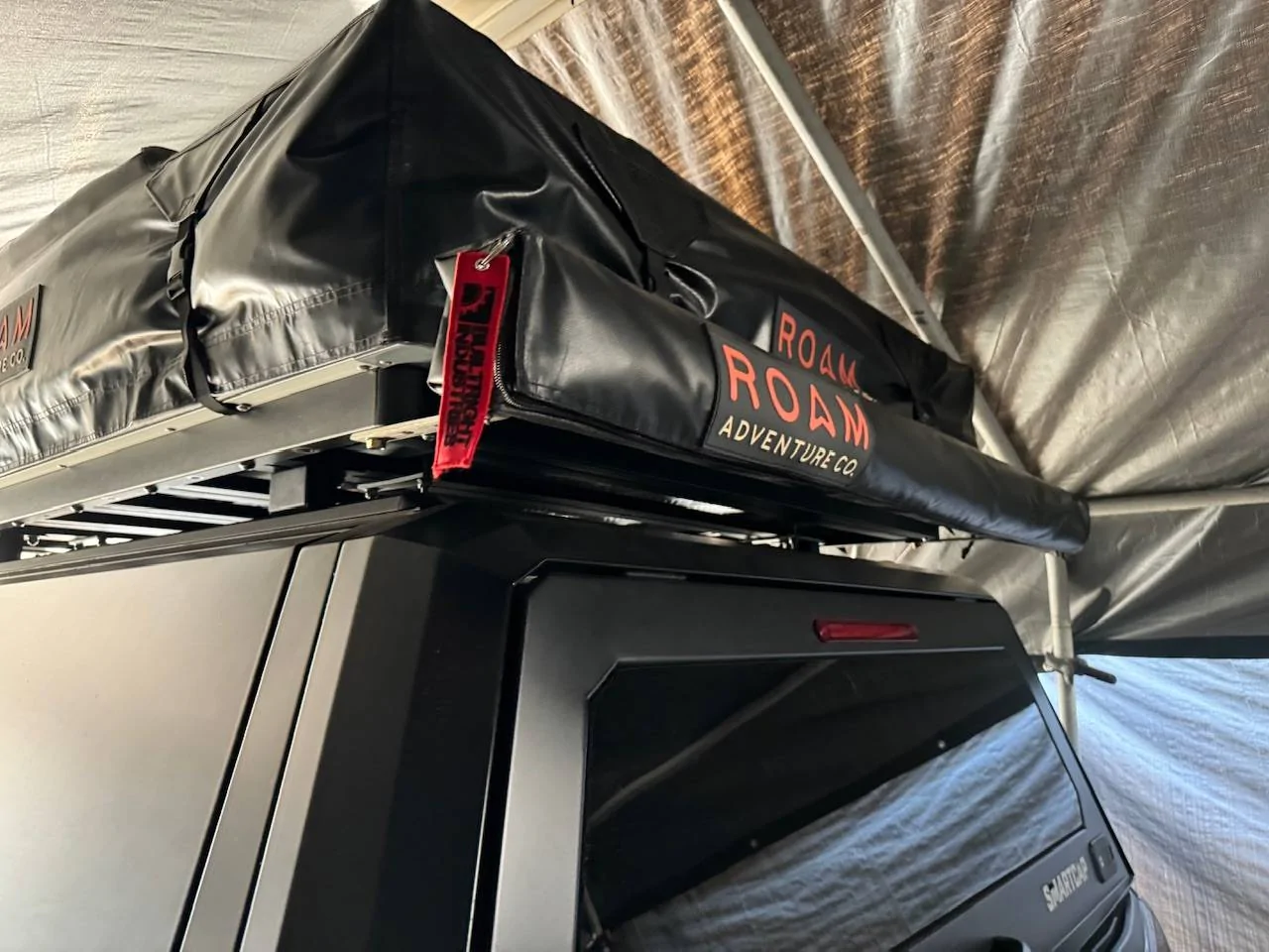

I also have RSI smart cap don’t baby it too much. But I do periodically re toque bolts just part of maintenance. But haven’t noticed anything major also have the rack installed on top and vagabond Roam RTT tent on top and 4’ awning. Where did you get caps for locks? You just contacted RSI directly on bought them on a website?
