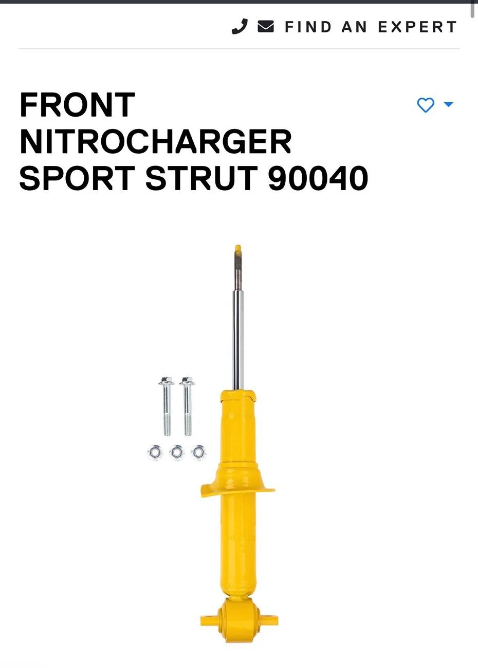

Hello all,
I am wanting OME front suspension but not the entire kits that sell. I have a 2023 FX4 ford ranger. I am looking at these 90040 struts but can’t tell in the description or specifications what kind of lift I get with these…. Anyone know the answer? I am wanting a 2.5” preferably. Okay with a minimum of 2”
If anyone is running these, tell me how you like them!
Thanks in advance

If you want the lift, then you will need the springs as well. The front with the correct spring will give you around 2.4 inches of lift up front. If you do not have a Winch or Bull Bar up front the. The light springs will do just fine. If you have a Winch and Bull Bar the. You will need the heavy duty springs.
Keep in mind this is meant to work with Old Man EMU Springs only. Mixing and matching random parts is a no go here. Also I highly recommend getting the correct kit for the rear to have the entire truck match. It will make a difference
