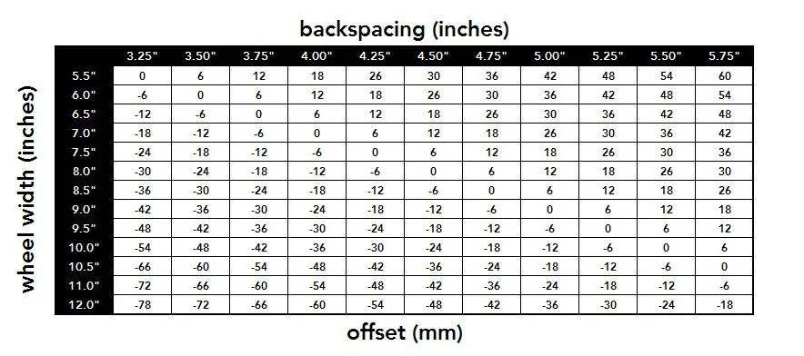

Here's an offset/backspace reference chart for quick reference:
