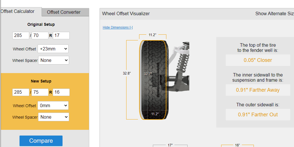

Wanting to pick up some 285/75/R16s and a 16x7” wheel with 4” of backspacing and 0mm offset. Will it clear the stock suspension?

Not sure on suspension since my tremor has a few different pieces there, but you may need to cut or remove your crash bars with that size if you havent already done so. I think it clears your knuckle but not sure. Depending on your lift or none for that matter you may also hit the fender liner.
For reference the original setup is my current tire/wheel on mine and that hits the crash bars if i hadnt cut it.

Being a 33 inch tire you are already going to have problems not counting the offset....... Bad idea on stock suspension....

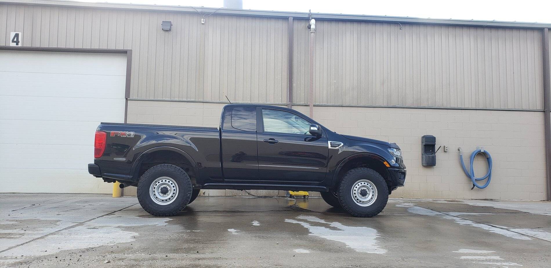

I used to run 16x8 0mm offset wheels with my 285/75R16's. I ended up buying a set of used OEM 16x7 steelie for $100 and have been much happier with the setup. Crashbars have to be addressed for sure at 0mm offset. Rubbing on the front FX4 air deflectors, so those have to go. Rubbing on the mud flaps and the back of the front wheel liners. Current setup in the front is;
Fox 2.0's set at 2.5" above stock
Fabtech UCA's
Fabtech Offset Crashbars
(OME Medium Leafs in the rear)
Fabtech UCA's
Good God that is sexy looking! So those are the factory ranger steelies? I like your sliders too!
Thanks! Yes, just the Ranger XL steelies. Seen guys running Tacoma steelies as well. Almost went that route before stumbling across the XL steelies.
Yea I saw some one with taco steelies earlier today. I’m gonna go with whatever I can get cheapest and go that route. Thanks man!
