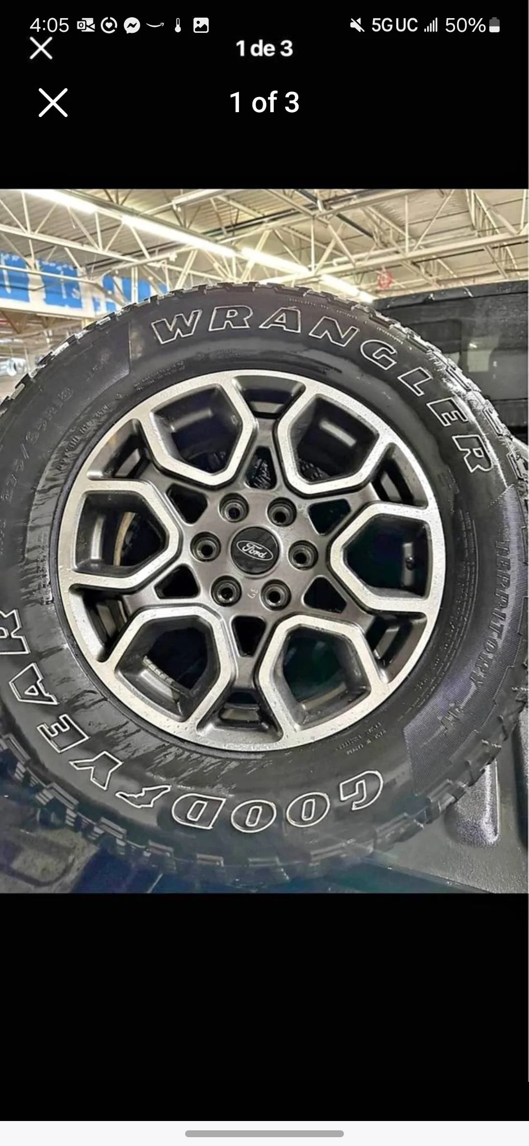

Hey fellas, were these wheels an option for the rangers? I've either complicated it by going cross eyed or thinking they were bronco options. Possibly have a decent deal and wasn't 100% positive they'd fit if bronco wheels. Appreciate the help.

Looks like this wheel is OE on F-150 and Expedition 2004-2021. Bolt pattern is 6-135. Will not fit the Ranger. (6-139.7)

There's a thread on here of a guy putting bronco wheels and tires on his ranger an they look good. I think they are the wheels on the big bend like I have. 17" grey with 255/75/17's 32" tall.
He said they fit an cleared fine. They have the same backspacing as the ranger wheels. Other packages might have larger tires an different offset an Sasquatch wheels come with 35's so no an easy fit.
