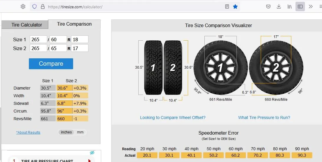

Those numbers are off from Tire rack.
265/65-17 vs 265/60-18
The tread will be the same on both tires (that's the 265 part, measured in mm).
The 18 is 0.1 inch smaller diameter.
They are so close, you could use one as a full size spare. No problem switching between the two sets, you will have no noticeable difference at all.
