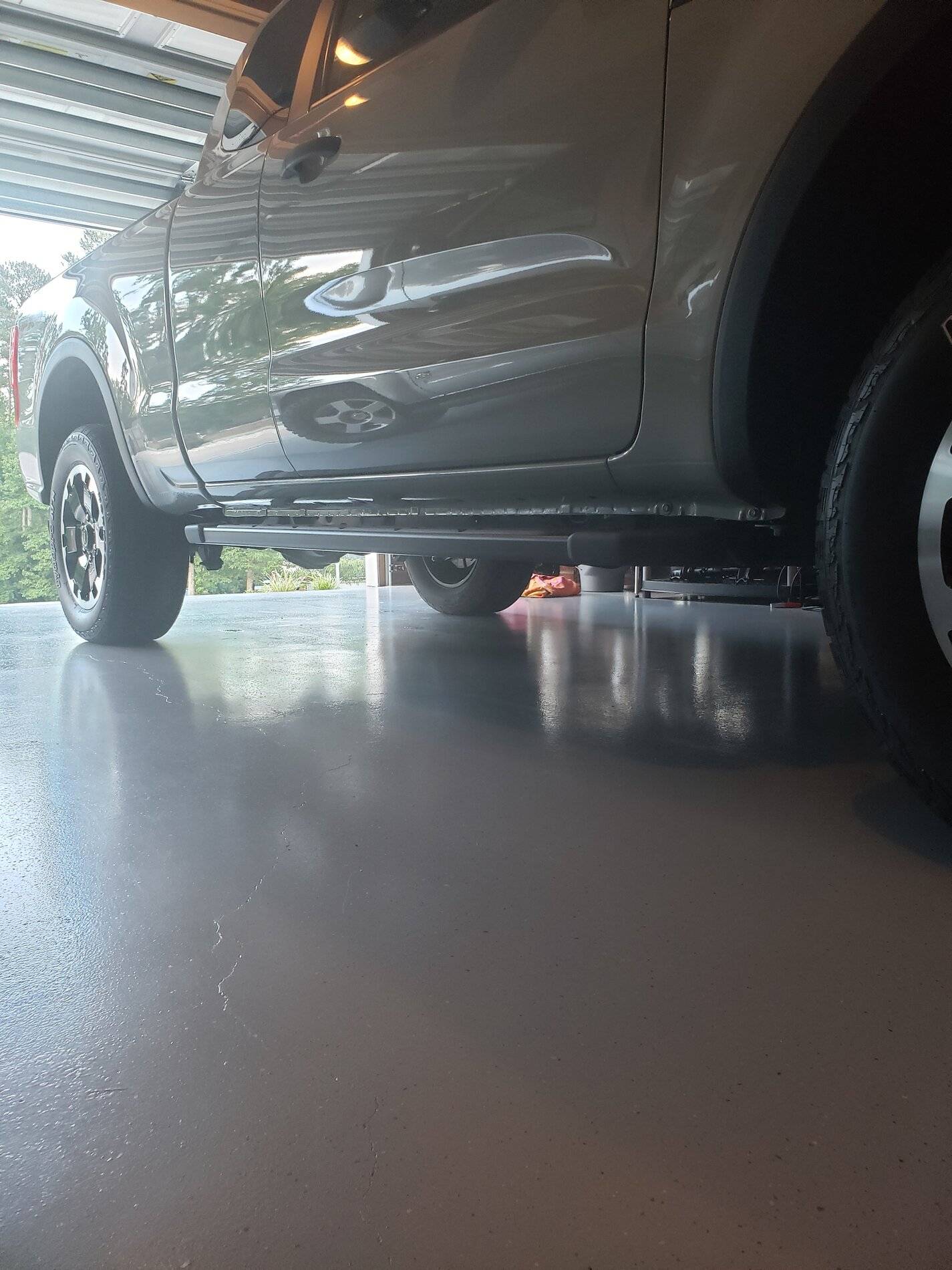

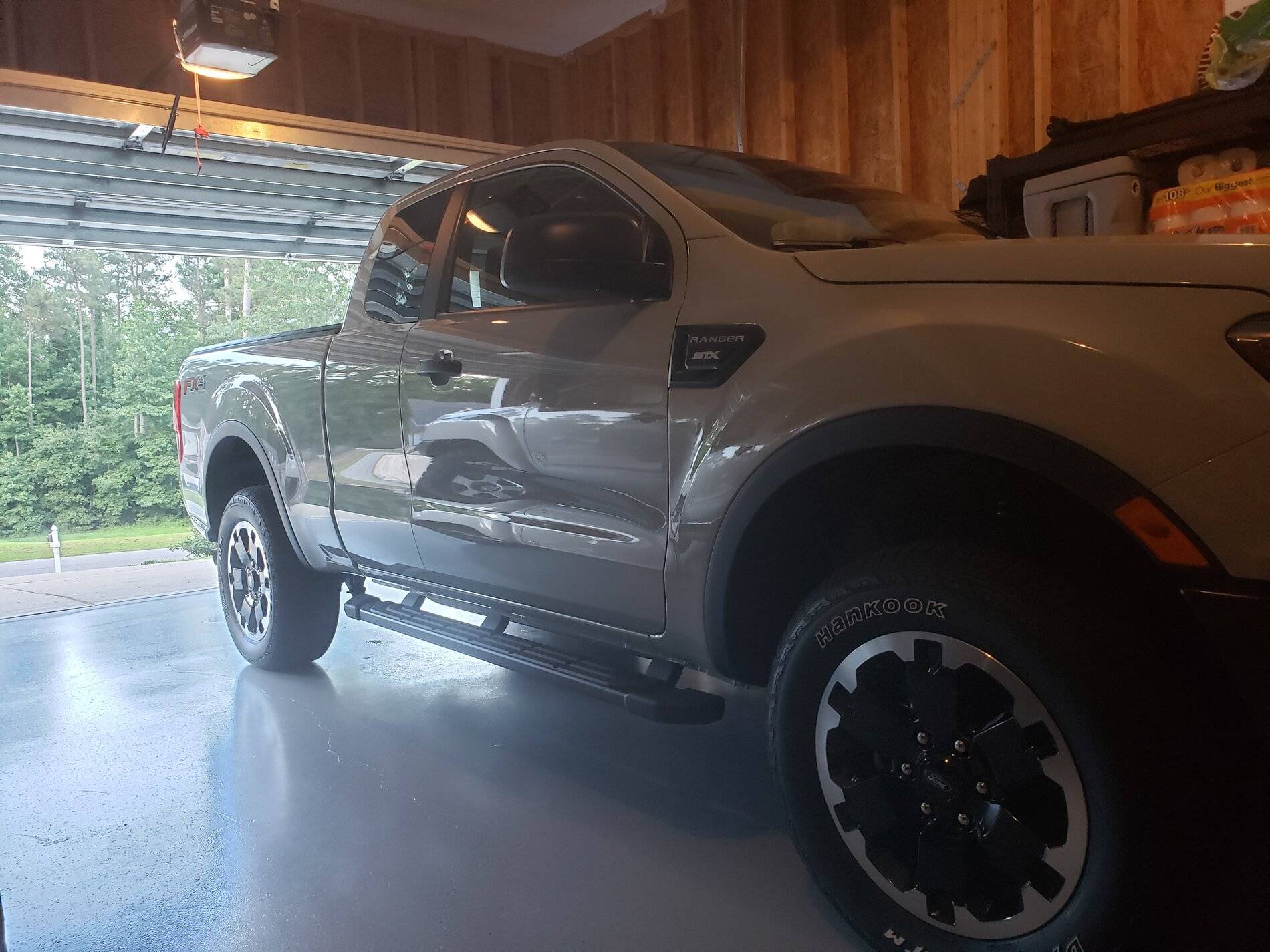

So I just installed the oem 5" rectangular side steps. Got them for like 200$ with ford pass points on new truck. Before I got them I shopped online. Looked at trucks that had the oem steps. Looking at them, the only part of the steps that hang lower than the frame rails are the brackets. I see posts out here saying they are bad for offroad. Yet they don't hang lower than the frames. I've watched tfl do crazy stuff in their YouTube videos with the steps on, and on a stock fx4, which I have. My thoughts are that if the bars are gonna hot something the frames will be hitting too. If the bars weren't there you would aquire lower panel damage. With them on they have to bend first before doing so. Anyhow, I have zero plans on doing hardcore stuff. I think they look good. Will allow me to get to roof to wash it. And will keep some road debris off the panels. Rokblokz on order though. Thoughts?

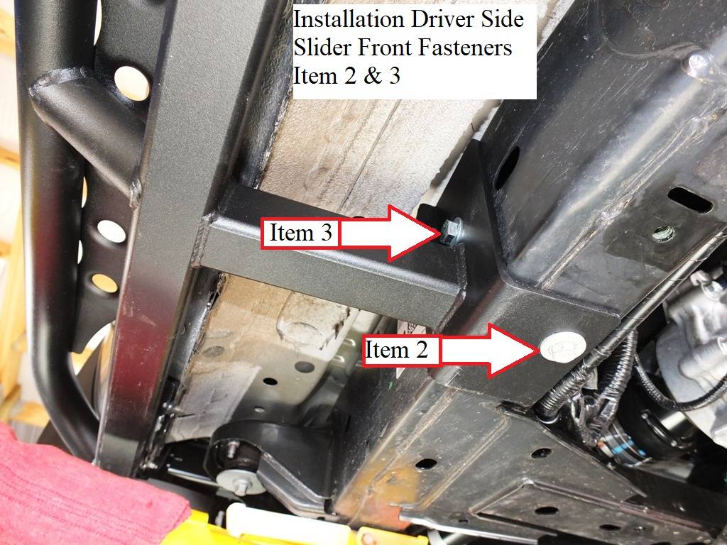

3/4" bolts.... that's a typo, right.​
OEM / Aftermarket side steps attach to the sheet metal cab, see below photo. Also, see the sheet metal bracket?
Rock sliders, good quality rock sliders, bolt to the frame of the truck. These sliders are so strong they can be used as a jacking point to lift up the truck. Look at the structural steel supports below.
ShrockWorks rock sliders are extremely strong. They are constructed of 2" square tube with a 0.1875" wall and 1.75" x .0.120" wall DOM round tubing. They bolt directly to the frame using 1/4” thick, gusseted mounting plates that tie into both the side and bottom of the frame. This nets you a stronger frame attachment vs. simply bolting to the side of the frame. They make great Hi-Lift jack lift points and will easily withstand impacts from any obstacle you may come across on the trails.
