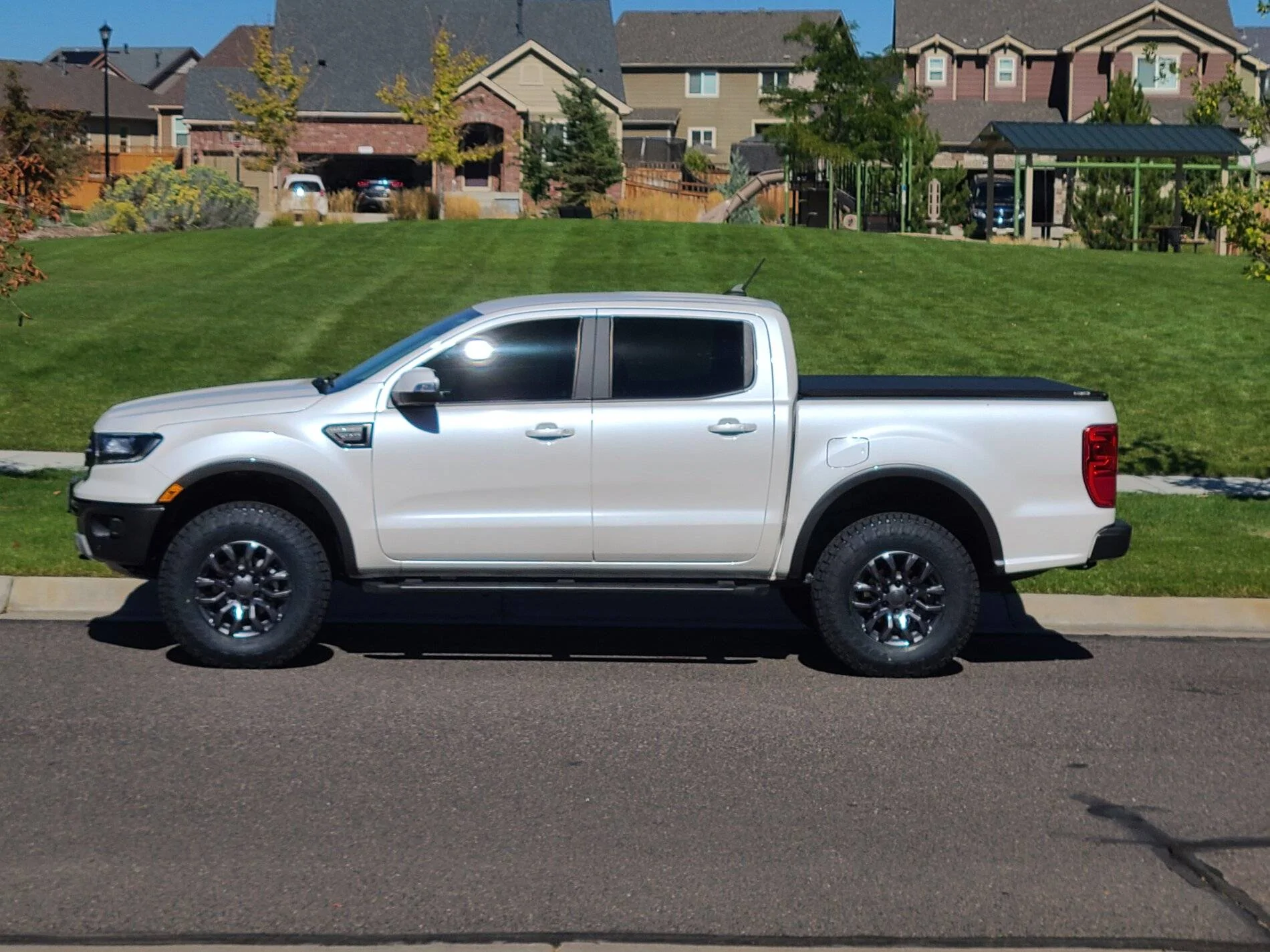

I wanted something simple that would maintain full off road capability so I went with 275/65R18 Falken Wildpeak AT3's on the 2.5" Torch Off Road front leveling spacers .
I've hauled azz through the pasture a couple times and nothing scrubs .

Ooowee now thattttt is very appealing-- this might be just what I'm looking for. Gotta get me the black wheels too, love the darker look <3 Your truck looks nasty dude and I mean that as a compliment!!!!

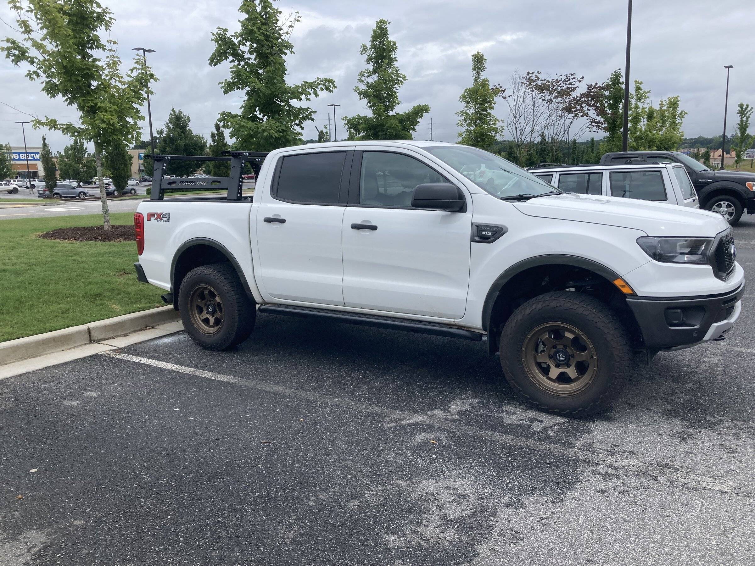

So, I just wanted to weigh in on your overall picture. If you want those big sexy tires, and you are considering spacers, that is where my story may be helpful.
I had some 265/70/17 Big-O tires on my stock Ranger with OEM wheels, and there was no problem. I bet if you put better looking tires, i.e.: Ko2, Duratrac, AT3's (Depending on what you drive), on OEM wheels you would be fine. But as you consider moving those larger wheels further from the vehicle, there may be issues.
Here is where the story gets to be a bit more relevant. I have rims that push my wheels out about 1.5" inches, which is about the smallest spacer you are able to get without having to cut the studs on the vehicle. Or in other words, you cannot simply put a .25" spacer without altering the studs length on the vehicle.
My truck is currently leveled (2021 Lariat Fx4, Fox 2.0). My rims are 30mm pushed further out and when I put 265/70/17's on the leveled truck with about 1.5" offset, I had rub on the crashbar at full lock in reverse.
I ultimately replaced the crashbars with BDM bars because I DO NOT want any rub under articulation while off-road, I want to keep the security of having a crash bar to pin the tire in worst case scenario event, I plan to move up to 33's next time I need to buy tires, so the space will be used eventually.
Ultimately, my advice is just to consider how all the pieces of the build may work together in the end, and if you are not willing to modify the vehicle (studs or crashbas), then you may want to plan for that from day 1.
