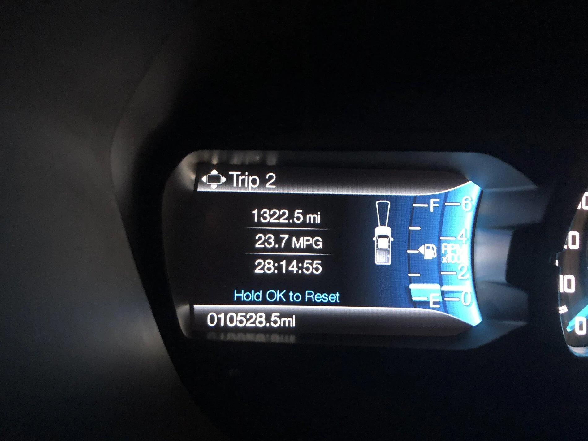

Been using livernois since about 3k miles. I've absolutely forgotten what the truck feels like when stock. Using the soft-shift towing tune 87-91octane on 87 octane. No complaints!
26,388
132,995
Based off the livernois thread- alot of guys seemed to have improved gas mileage, is that not the case with you?
When I added my tires 265/70/17 and 2.5" level I noticed about a 1-2 mpg drop. Since getting the Livernois tune I've gained it right back and even more on highway trips. You can see in my Sig I'm averaging 21.5 and my most recent trip I averaged 23.7.
