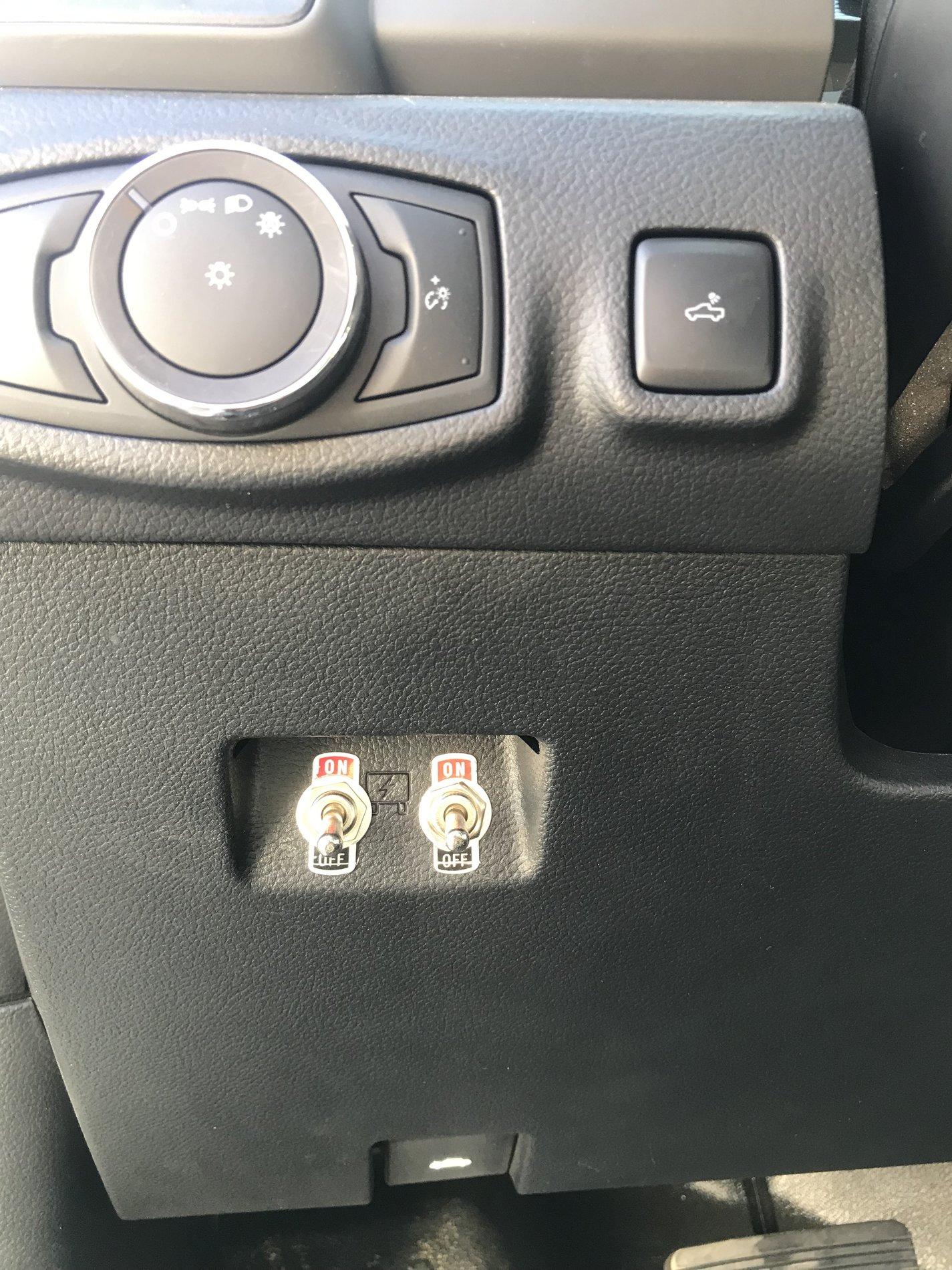

New member here. Figured id chime in as well just finished up my upfitter switch install no holes in the panels!

Much appreciated thank you. So i used the add a fuse taps under the steering wheeling fuse panel
fuse 29 (Micro 2 Fuse - 30A) for constant power
fuse 37 (Micro 2 Fuse - 20A) for ignition (switched)
My switches are wired in to a "custom" relay box in the engine to reduce the amount of wires needed inside the cabin. If thats not too much help i can explain or draw up my diagram of how i ran everything

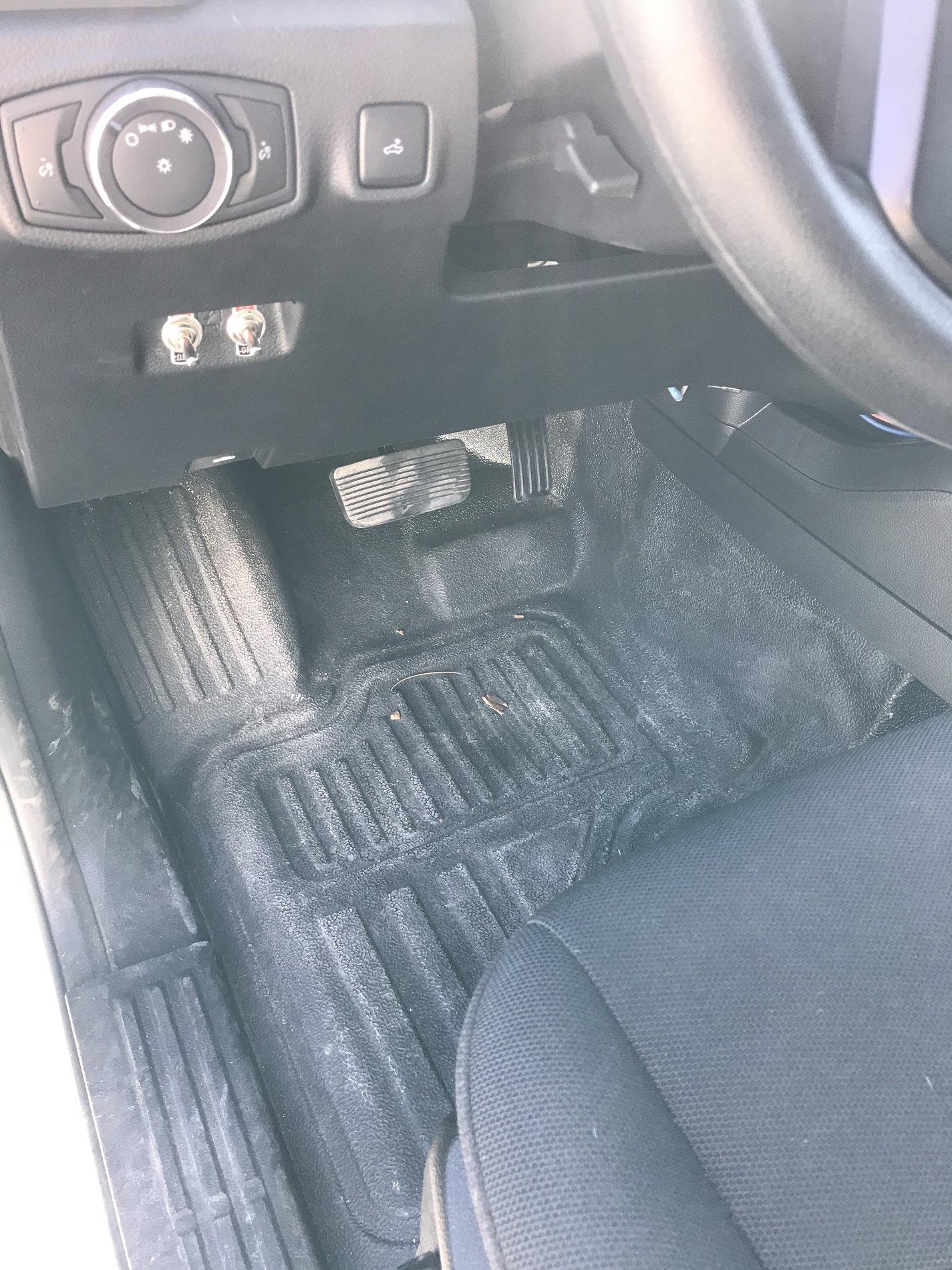

1st picture is the finished product the 2nd picture is the building phase

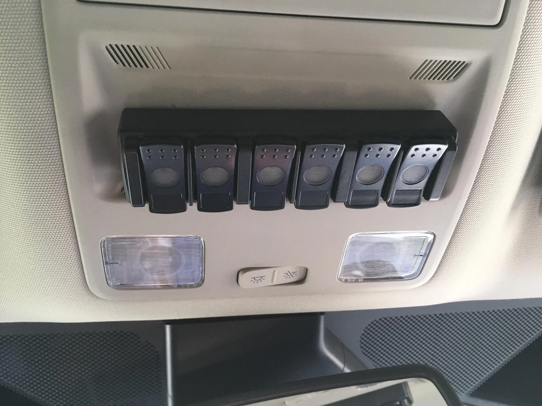

Wow nice setup, perfect spot too! Thatā€™s where I have my relay switches mounted! I think Iā€™m going to copy your idea! Looks good thanks again ????????
