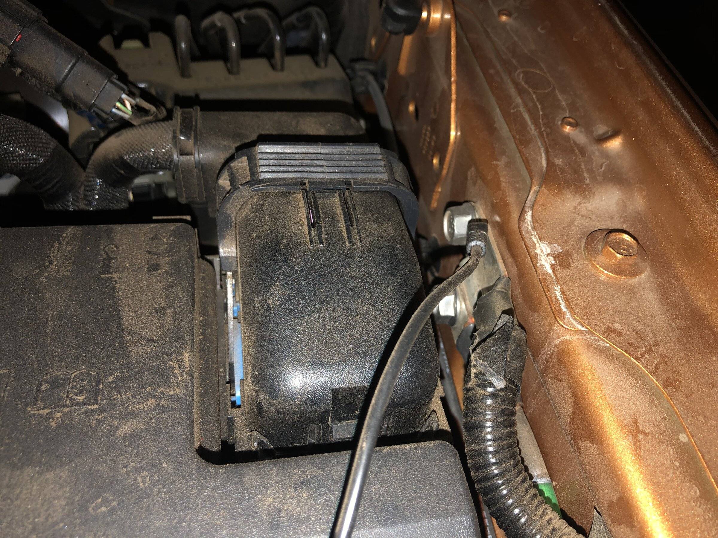

I grounded mine to the side of the fender. I'll dig up the picture and post it.
Do you have your charger permanently attached? I was just planning to use the alligator clips, at least initially...

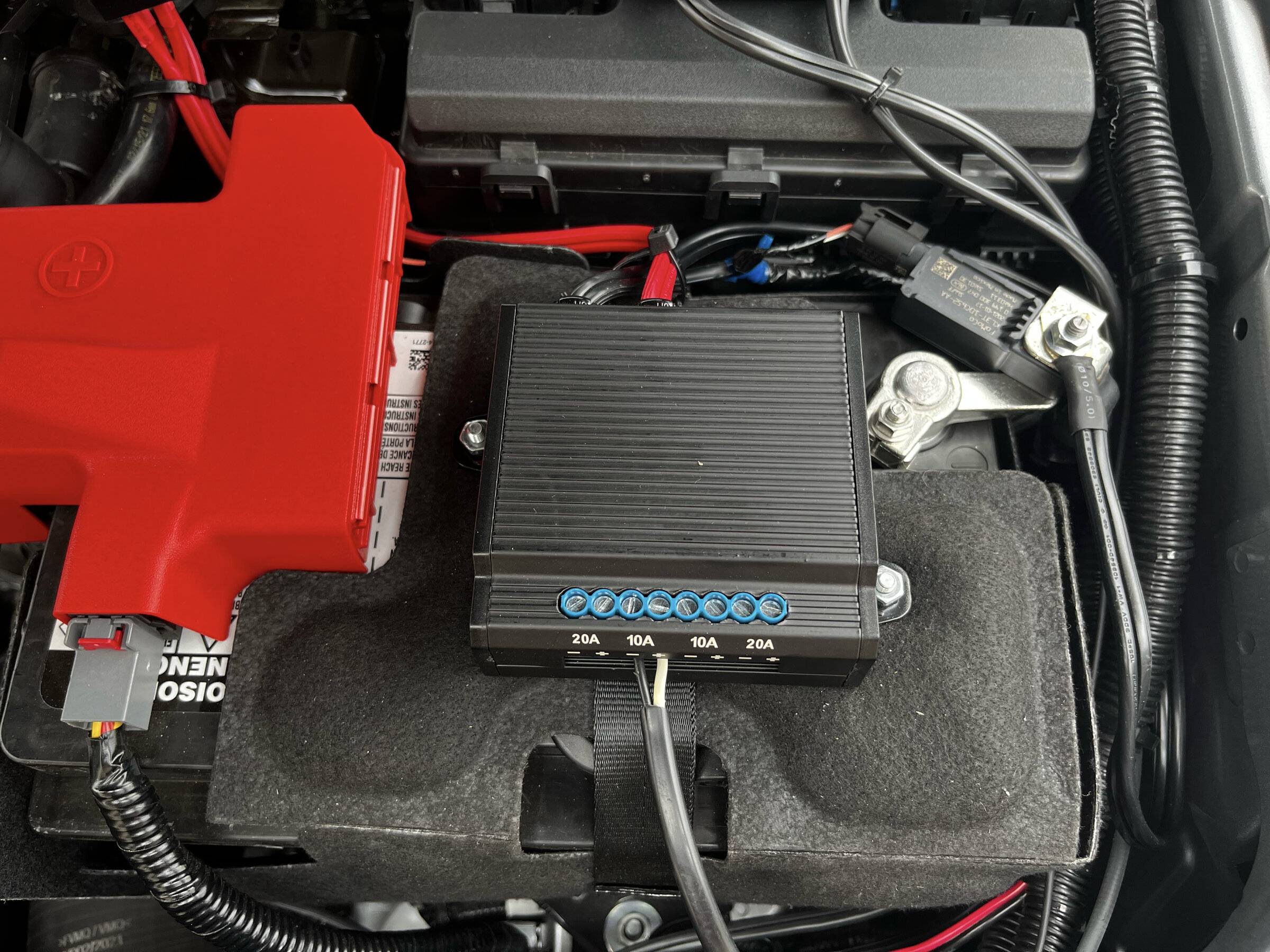

There are a few grounding straps in the engine bay, I grounded my tow battery charger to the top post on the negative terminal on the battery, not the battery post itself but the BMS connection, that way the BMS will still read the power flow.

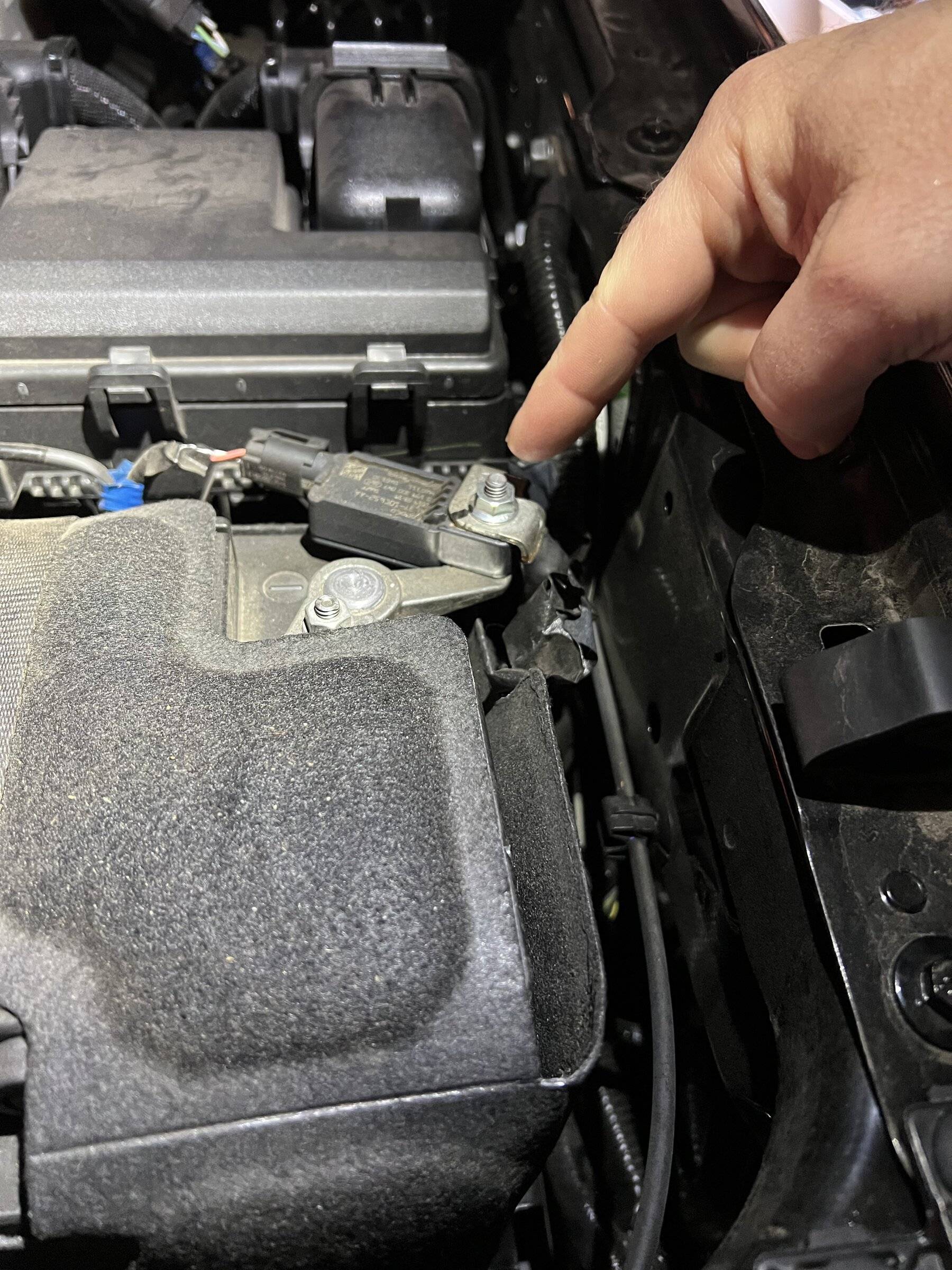

Thanks, I had not considered that. Just to clarify location - here?

If you need a ground on passenger side, look down at the area between the headlamp and the filter box...there's a factory ground wire 10mm bolt head...

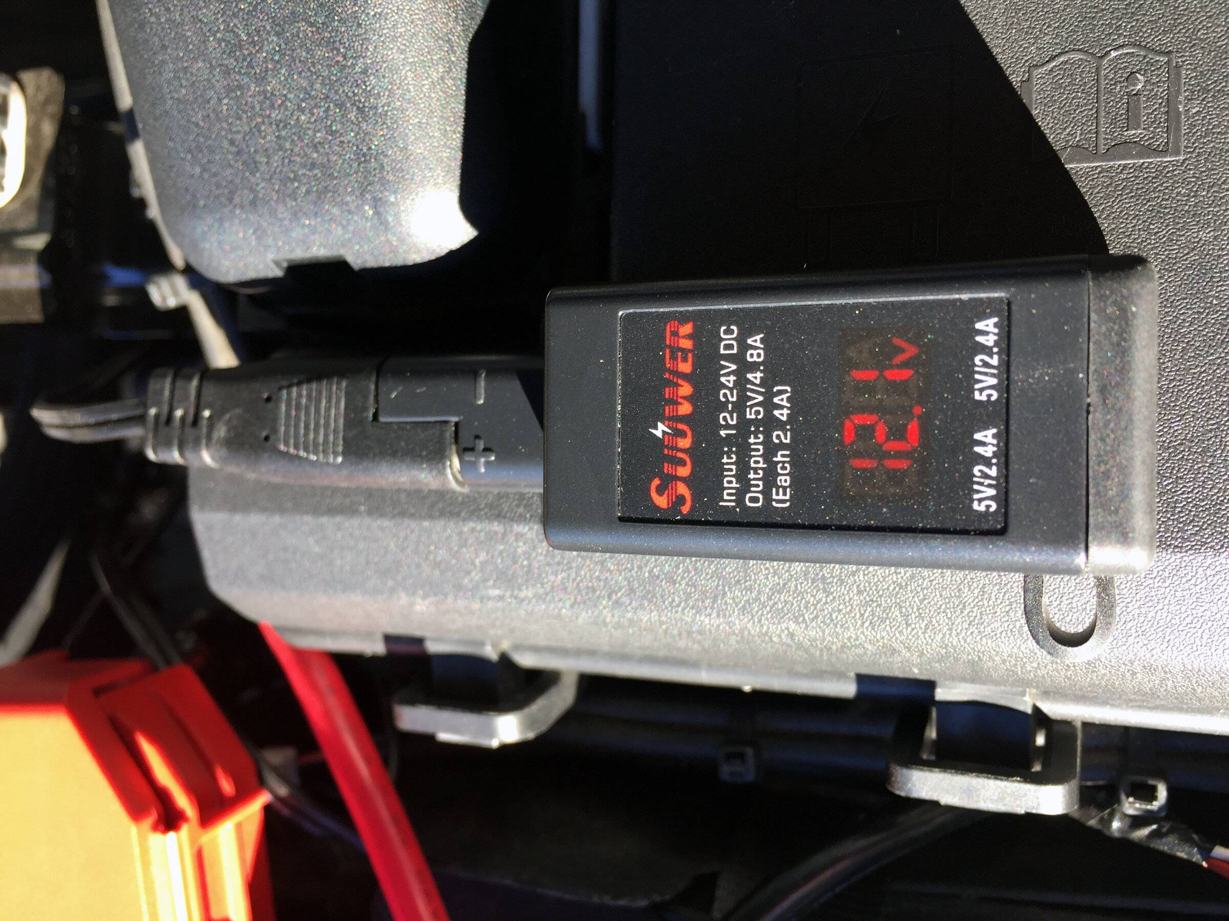

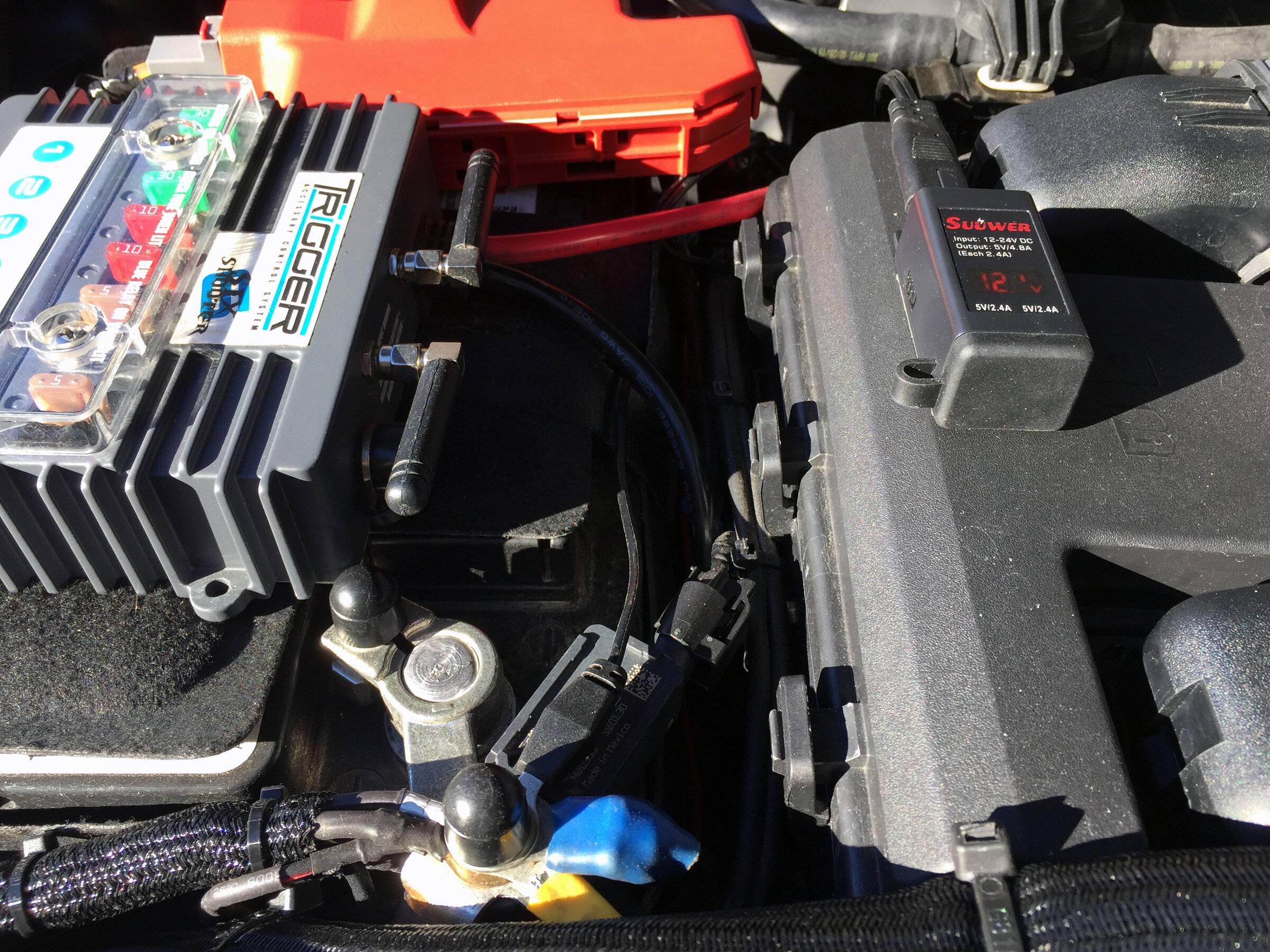

I connected my charge lead directly to the positive and negative posts...it's terminated with a switched volt meter or disconnects for connecting to maintenance charger...
JesseS
Jesse
May 26, 2021
1,755
4,824
NorCal (Roseville)

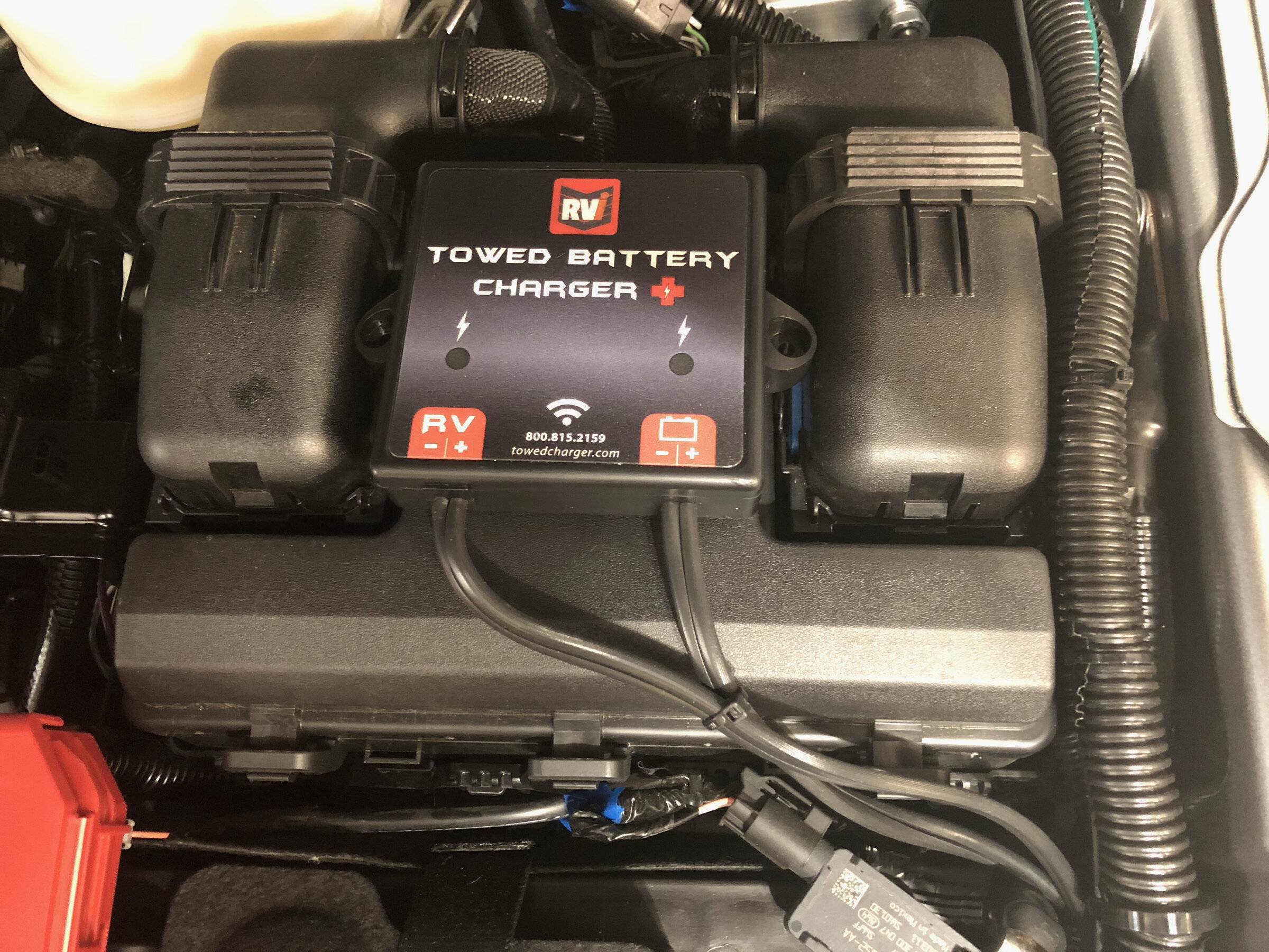

I wasn't sure of what the load draw limit of the BMS sensor was so only ran the neg charger lead to it, with all other loads grounded to the frame. There are 10mm grounding points on both side corners.
Remote switch grounded to frame
Towed Battery charger grounded to BMS
And yes I keep my engine bay clean, makes it easier (and nicer) to work on.
