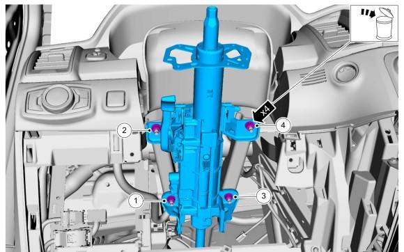

I have a 2019 Ranger with a probable climate control mode door actuator failure (i can't get bi-level air from the panel and the floor - no clicking, everything else works).
I'd like to swap the driver side actuator motor with the one from the heat blend door on the glove box side (same Ford part number) to confirm the failure but while the blend motor is easy to get at the mode door on the driver's side is a nightmare.
do i have to drop or lower or remove the steering column, and even then how do i get around the dash support bracket. can anyone help who's done it or something similar? and are there any manuals available on-line?

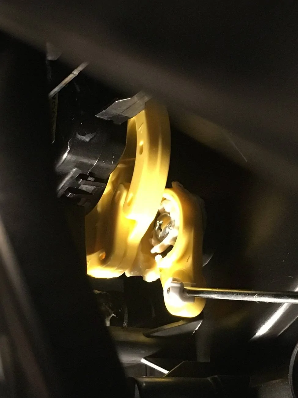

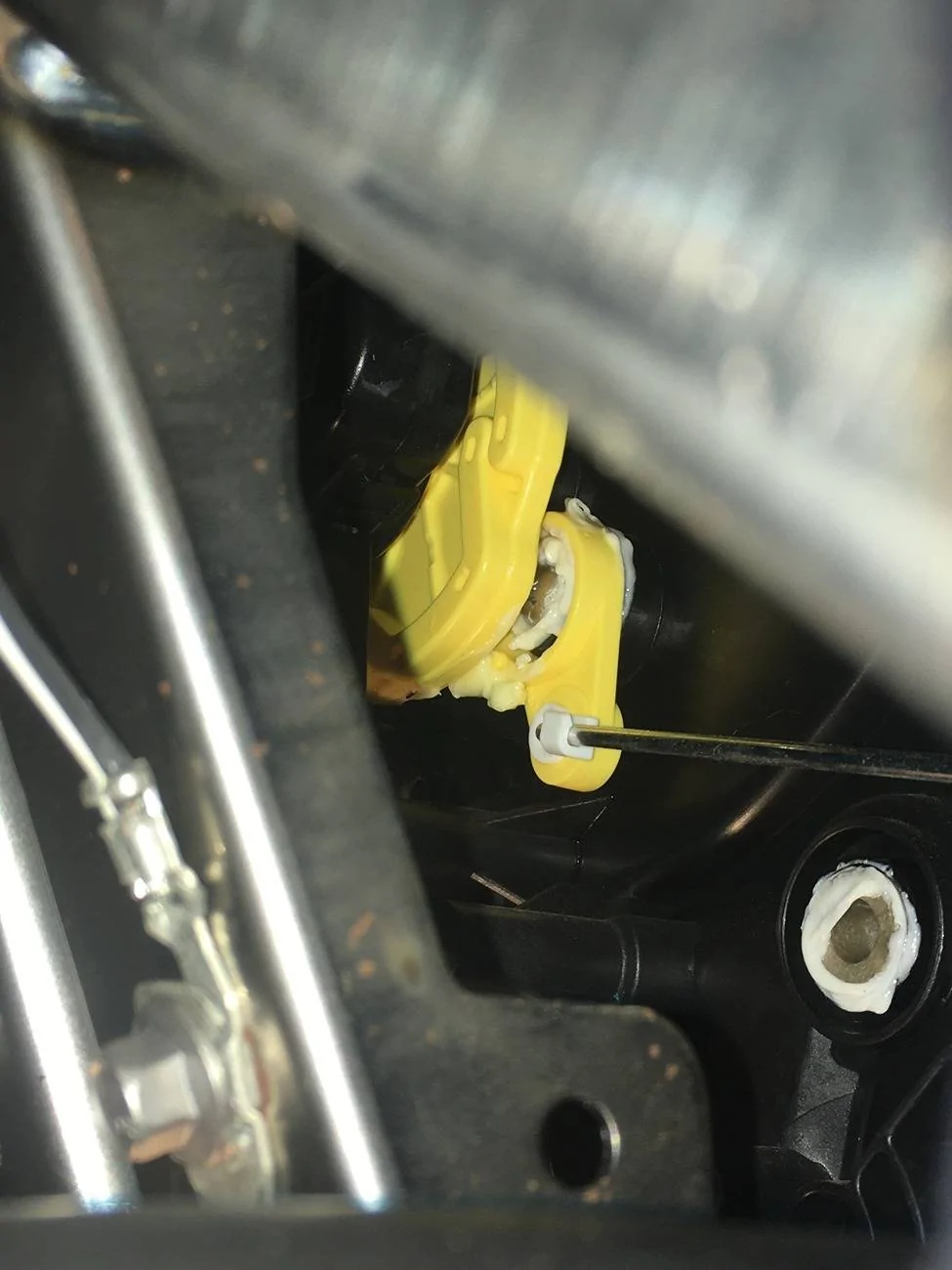

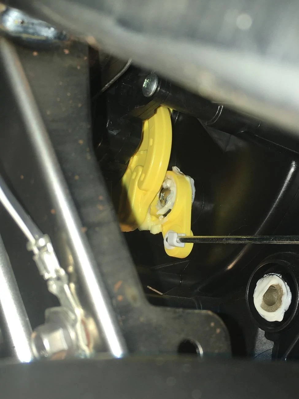

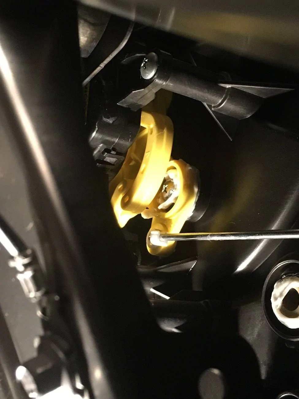

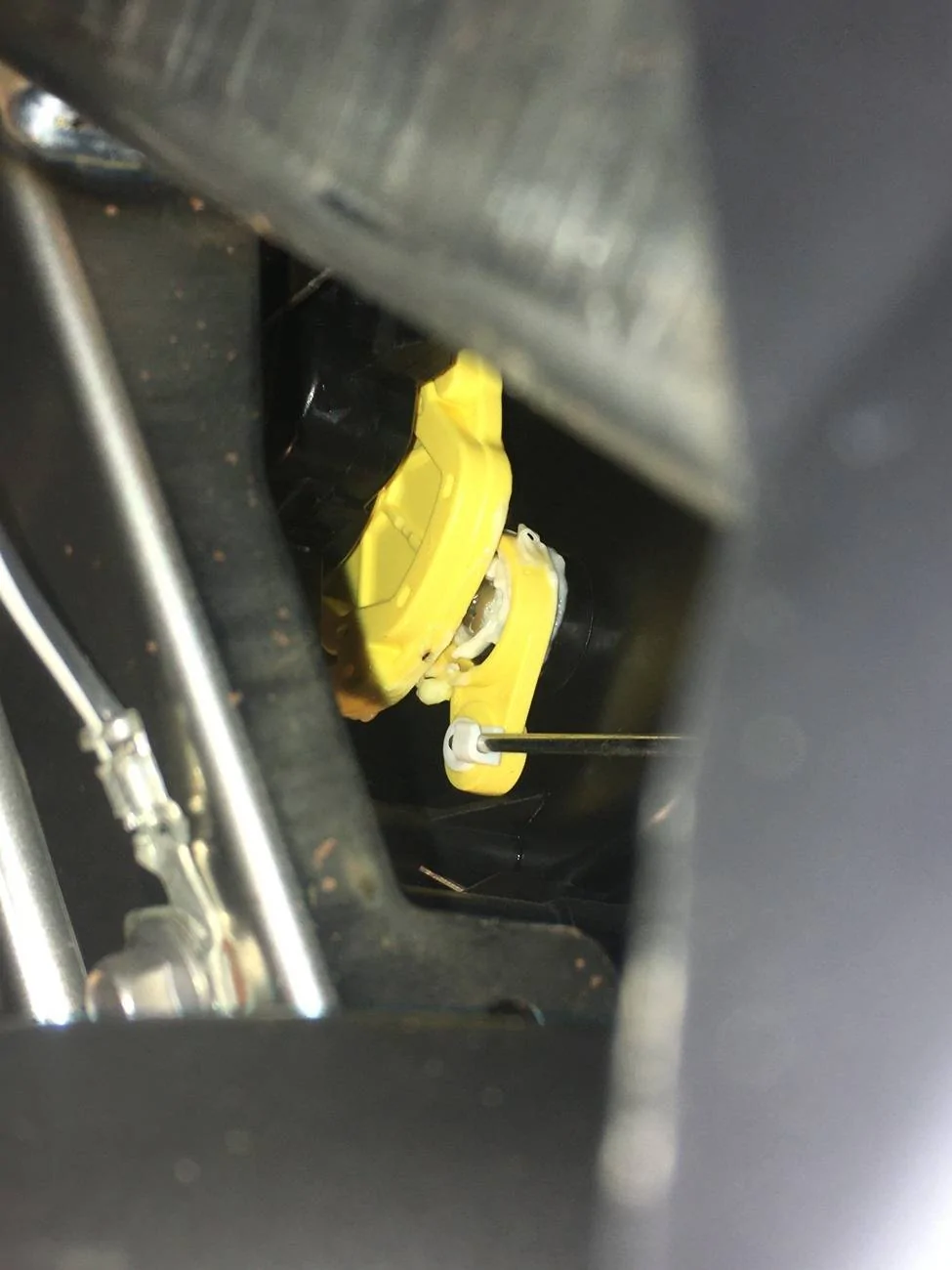

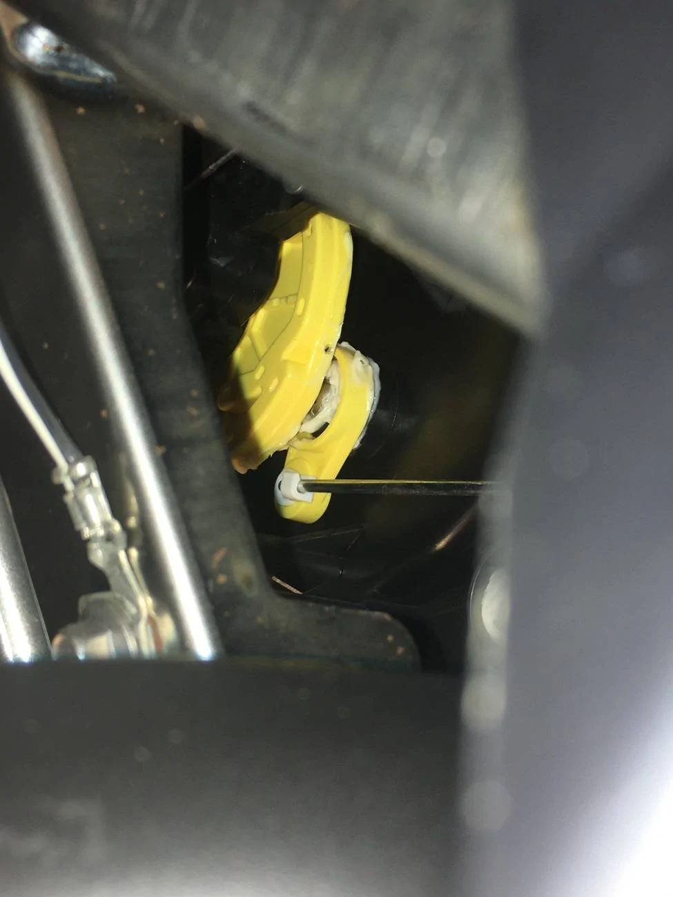

I've included a photo of the cams next to the actuator motor in the panel-floor bi-level. you can barely view this cam if you remove the fuse cover panel below the steering column. it might be impossible to tell but see if you can determine any slight change in the position of the cam (i find its better to take a cell phone photo and then you can blow it up).
jim d.

p.s. can you get of a photo of the motor/cams in the panel/floor bi-level setting?

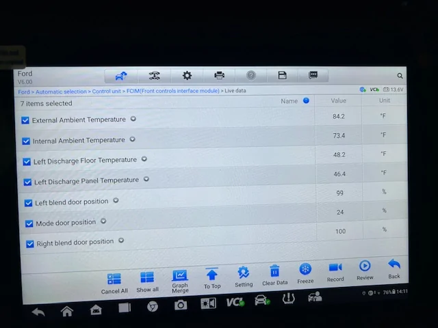

Repost (Due to Server Issue) dumped the post
I played with mine and ran temps full hot and full cold while in manual mode.
Noted that the Mode Door actuator did not move, so I can confirm that in Bi-Level the percentage position should be 25%, but did note that it may read 24% - I do not think a 1% variance will make any difference.
No noted airflow issues
Let id idle for an extended period for testing to ensure both Temp Sensors (Panel & Foot) would closely match
Viewing the FCIM PID data is the only true way to see what the actual position of the door is.
I wanted to include the Temp Sensors as they are the Feedback to the FCIM for actual temperature being delivered and I do not have a full and clear understanding on what the FCIM does with that information (reaction of control)
That is all tied into how the FCIM is programmed.
Basically - will a misreading temp sensor - block the mode selection from going into (Bi-Level) as it would be relying on a valid temp reading.
Note: in (Auto) it automatically adjusts the temp doors and mode doors (using the temp sensors) but unknown if in manual what (control) do the temp sensors have within the FCIM programming (is what I am uncertain)
Just something to check and note what they are reading, however note that they are slow to respond and are not an immediate read, example I idled for about 10 minutes to get these readings (Temp Selected - LO) to drive them down this low.
The most important is they closely match.
The Internal Temp (Humidity Temp Sensor) matched a handheld thermometer when shot into the vent (by your right knee) on the dash
i'm dragging my feet on tearing into my ranger to swap the actuator motors. i'm thinking that even with the steering column removed entirely i just don't see how i'm going to get my hands around that one heavy forward dash support. i don't see how it can be done. Has anyone removed the mode actuator successfully without removing the dash?
another question specifically for you: if you remove the mode motor does that yellow cam stay on the manifold or is it free floating between the two. and if that cam or the bosses on it are broken what then? the cam is not shown as a separate buyable part.
thanks,
