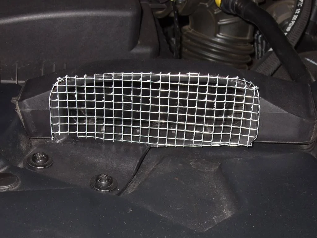

Does anyone know what this piece is for? It is glued to the passenger side vent behind rear seat and there is no evidence of any mice chunks but i would like to cover the vent with the mesh like the drivers side. Not sure if I should remove it to cover it with mesh as it is basically the same except the foam piece.

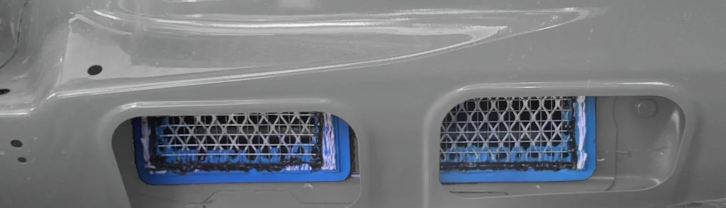

I just removed the back seat backs to take a look at how I planned to block the mice. I have two identical vents back there that open to the air! I figured the engineers would have designed a more robust vent than 2 - 11/5" x 5.5" holes in the back of the cab!
I also am wondering just how long the plastic will last before it deteriorates or becomes brittle and falls out the hole.
I removed the plastic vents in an effort to determine the cleanest way to block the mice.
They will be easy enough to reinstall. Here are the vents removed, one facing forward, and the other showing the back side.
I think I am going to experiment to see just how much of an opening is required to allow the doors to easy close. Those openings must allow road/wind noise into the cabin.
Comments before I do something stupid?

I had two identical vents in my SCAB. And you only having one makes me wonder if two are really needed.
I pryed if off a bit to take a look a couple weeks ago, There is a vent behind it. Whatever adhesive they use for that sure stays super tacky even going on three years. It’s basically the same except for that plastic/foam piece. I am still parking outside though even with all the fixes I’ve done, still nervous to park in the garage.

Yes, we have a condensate drain - the rear vents are not intended for that purpose.
The Air Inlet door, AKA Recirculation Door Actuator, is powered to the mid position when you shut off the truck. The Mode Door also powers to the Bi-Level Position (Floor-Panel)
This action vents the HVAC (Evap Core) to absolve the musty odors and dry out the Evap Core.
Rear Vents - Purpose
Now I do not know how much they actually do but the intent of those is to equalize cabin pressure.
when closing the doors and also Airbag Deployment and Climate Control (Circulation) to expel dangerous fumes from the cabin
How much would it affect (slow down or delay) Airbag Deployment ?‍♂
I do not know why some owners have a foam covering? over them or just (1) of them.
But it may be related to this:
It appears to be different between the SCAB and SCREW - Less Cab space as the variable.
SSM 51263 2015-2023 F-150, 2017-2022 F-Super Duty, And 2019-2023 Ranger - Dust Ingress Into The Cabin Some 2015-2023 F-150, 2017-2022 F-Super Duty, and 2019-2023 Ranger vehicles may exhibit dust ingress into the cabin through the doors or air extractors. This may be due to the climate control system being in recirculation mode as a result of the recirculation button being on or automatic strategies for heating/cooling efficiency. To minimize dust ingress when driving in off-road or secondary road conditions, make sure that all doors and windows are fully closed and the climate control system is switched to defrost on and the instrument panel and footwell air vents are switched to off. Temperature and fan settings may be adjusted as desired. Alternatively, max defrost can be activated which will adjust all settings automatically. Operating in defrost mode will keep constant air flow through the rear air extractors and other small areas, helping minimize dust ingress

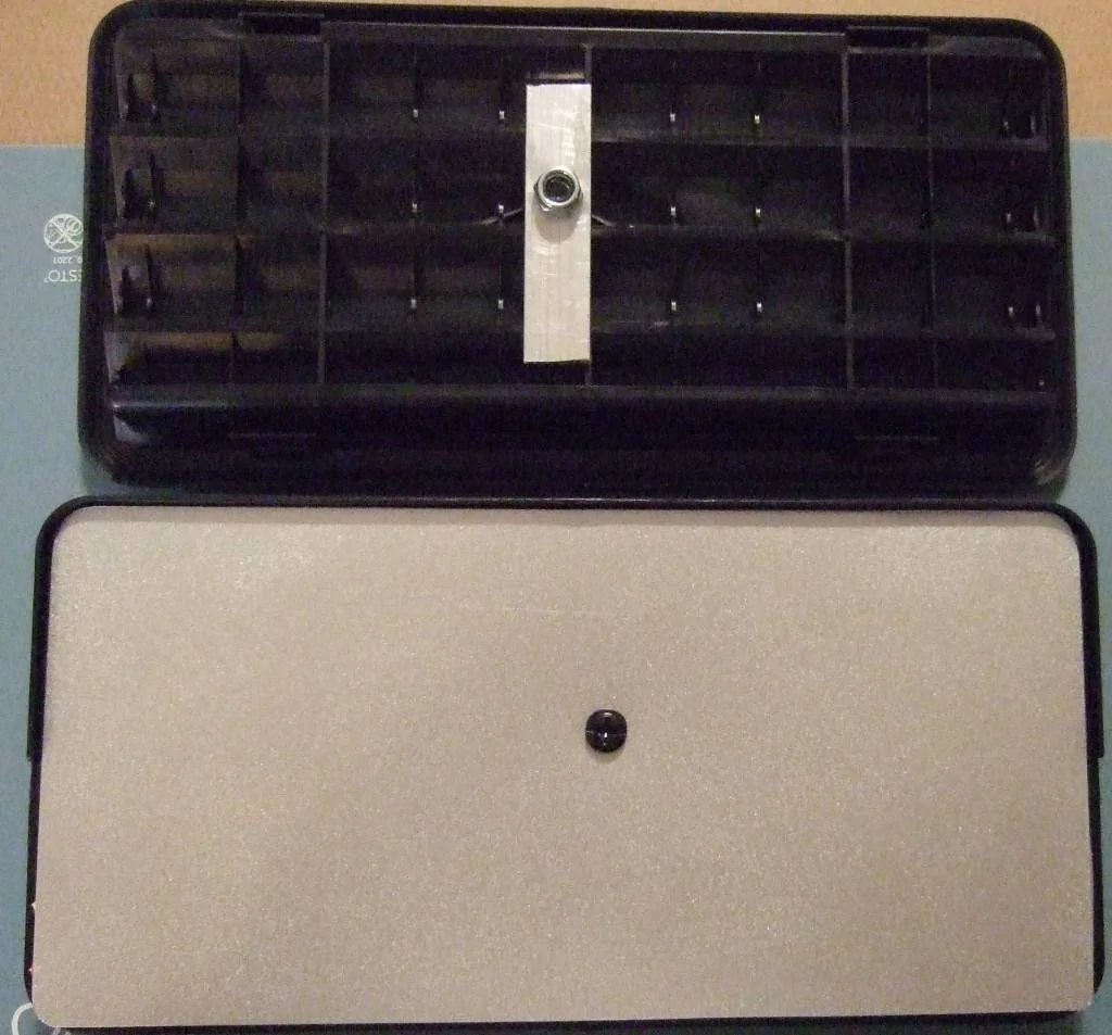

I've got the aluminum panels cut out, cleaned, degreased, and painted to match my iconic Silver SCAB, not that anyone will ever see them! I'll install the panels to the vents after dinner, then reinstall the vents in the truck later tonight.
The ingress for the mice will be closed. No more mice threats inside the truck. The traps however, stay set in the garage.
UPDATE:
Here's a picture of the plate placed in the vent checking for fitment. I will seal the edges with exterior high density double sided tape and insure it says in place with a single bolt through the center. Then replace them back in the truck. This silver side faces the exterior of the truck.
UPDATE 2:
All done! Here are the finished blocked vents. The adhesive would have probably been enough to hold the plates in place, but just to be sure I secured them with a nice powder coated black bolt. I used a 1/8" x 3/4" x 3" aluminum stock as anchor with a nylon lock nut, just snug enough to hole the plate without stressing the plastic. Time to pop them back in the truck.
We'll see how it works out over time.
