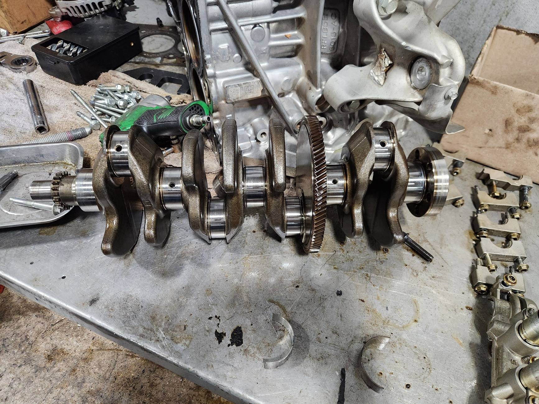

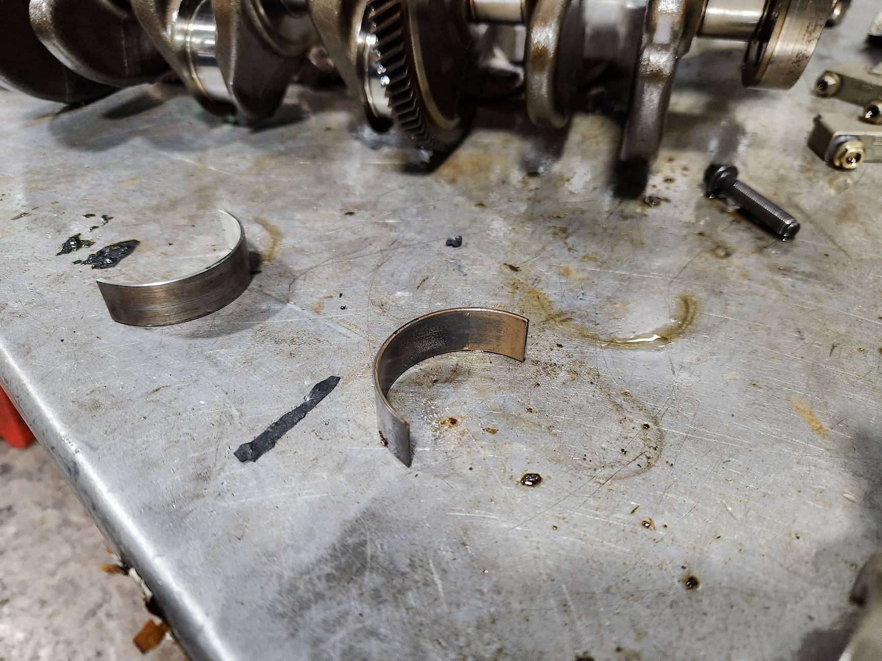

Well, there is a new engine on order from Ford, but i have had an explanation of what happened.
They said there is lots of metal in the oil filter though, so I asked them to make sure none of that metal made it's way into the turbo.
I'll try to keep you all updated.

I asked for a meeting with the foreman to go over the engine when they confirmed mine was bad so feel free to try that with your dealer. I asked about the turbo as well since I had a bad rod bearing in cyl 4 (metal in oil) but they said the turbo was not a concern with this type of issue (time will tell). There is a pre-screen of some sort to keep the large stuff out they mentioned but my lines were fine.
The foreman said remanufactured long blocks are oil pan to valve cover. Supposedly new internals but likely rebuilt blocks/head castings is my guess. With 2k miles on the new engine, all feels fine (after they bolted the trans to the crossmember).
