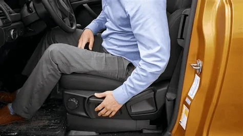

This is correct. I have the manual seats. The front bar is lifted to slide the seat forward and back. The height adjustment is on the side of the seat.
Here's a video...
