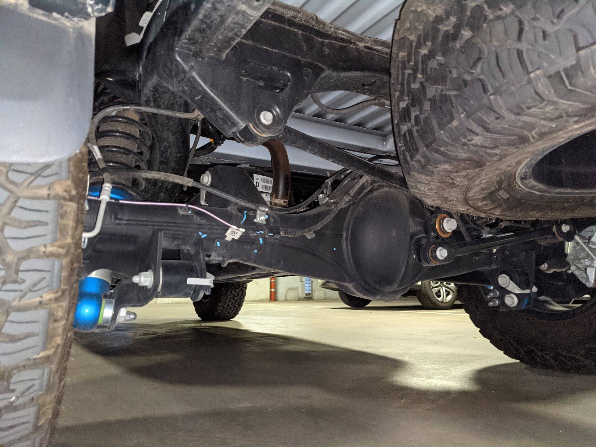

I dearched the rear springs 1.5" which leveled my Tremor, but I did it to the multi leaf global springs I bought, the bump stop should be shortened as well.
I'm happy with it, 37" at all four corners, no more stink bug look and it really helps the loading of my heavy ass ebike.
