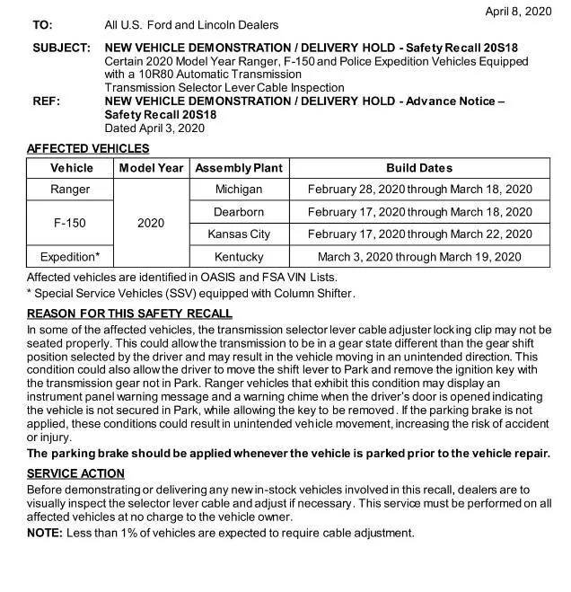

Actually, depending on your 2020 Build Date, there was a recall issued for the shifter cable (locking tab) not being fully secured.
This would allow slack in the cable if not secured.
But the dealer should have caught it, if yours was included in that recall, so this is just a FYI
as it was only a 20 day window. (leap yr)
