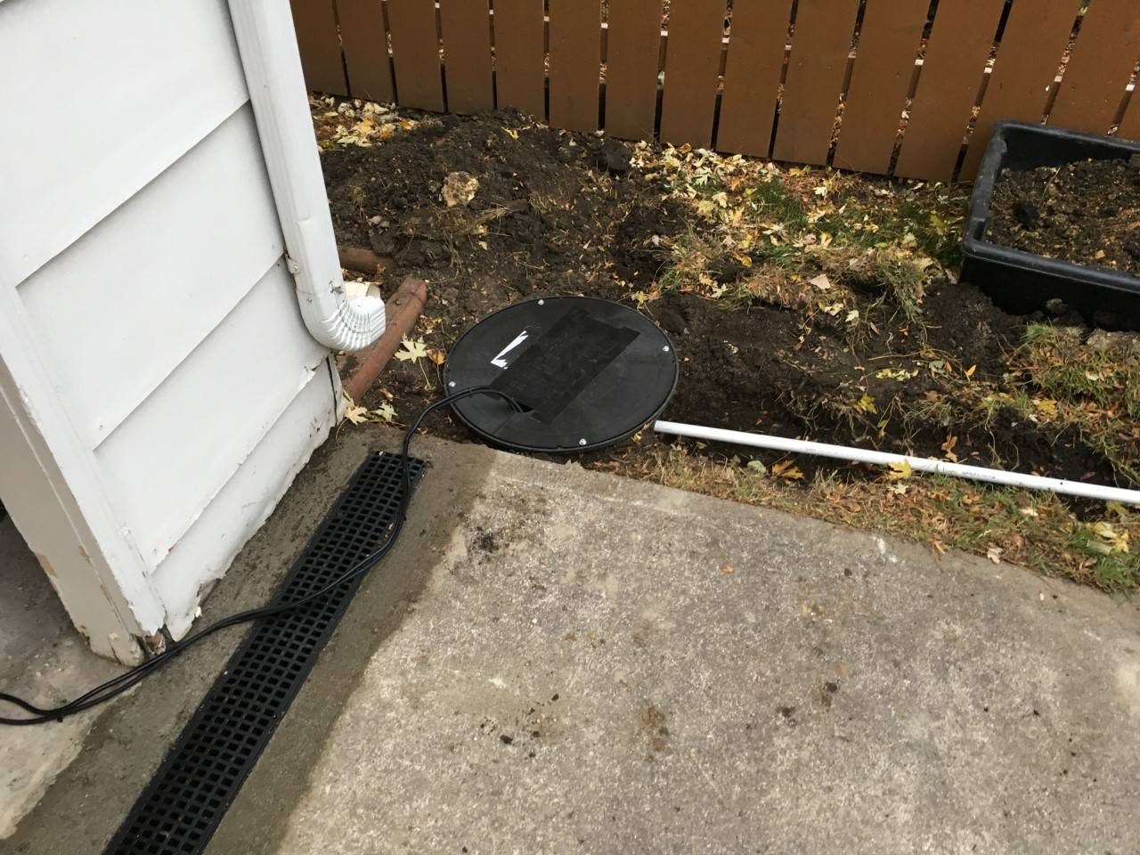

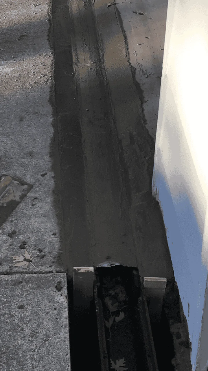

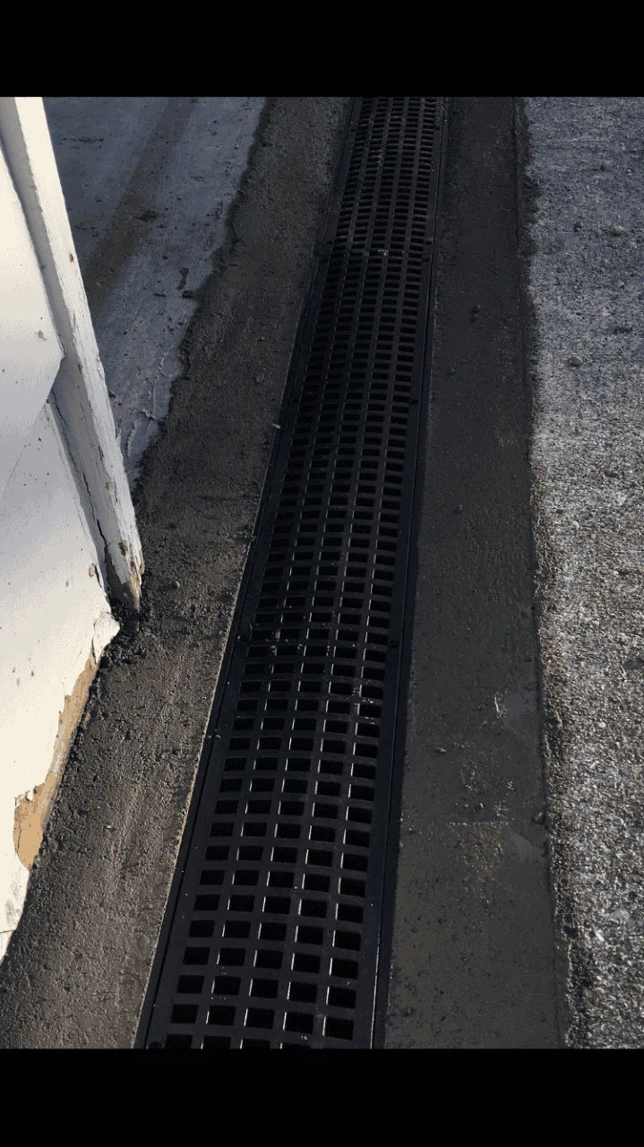

Jack--I put a trench drain in front of my garage a few years ago. My driveway is almost level, but when we get a good rain, it will work it's way into the garage which is very annoying. I ended up cutting and busting out about 12" of the driveway and laying in a trench drain. I covered the top with duck tape, added some rebar, mixed the cement in a Harbor Freight mixer and filled it up. The front, back and sides slope toward the drain and after it was all smoothed out, I removed the tape. It dumps into a sump well on one end which is pumped out to the alley. I'll try to find the link where I bought it....it was the best bang for the buck from what I could find.
Here ya go:
https://drainagedirect.com/polylok-heavy-duty-4-black-trench-drain-kit-3-pack-12-linear-feet.html
