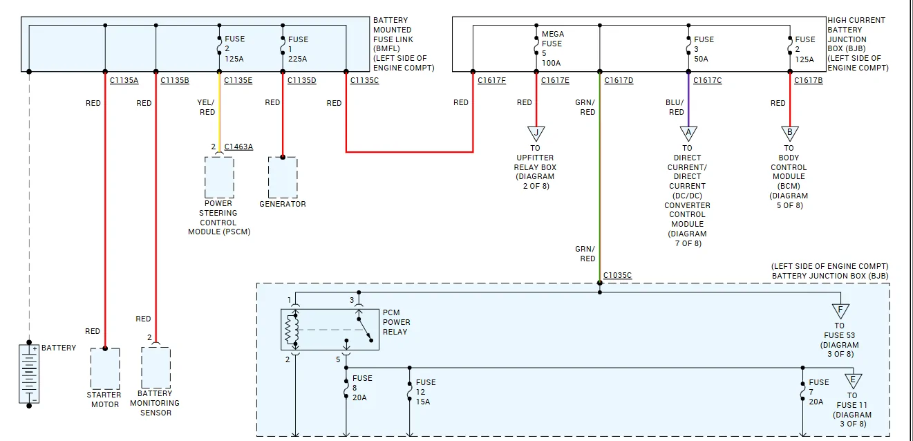

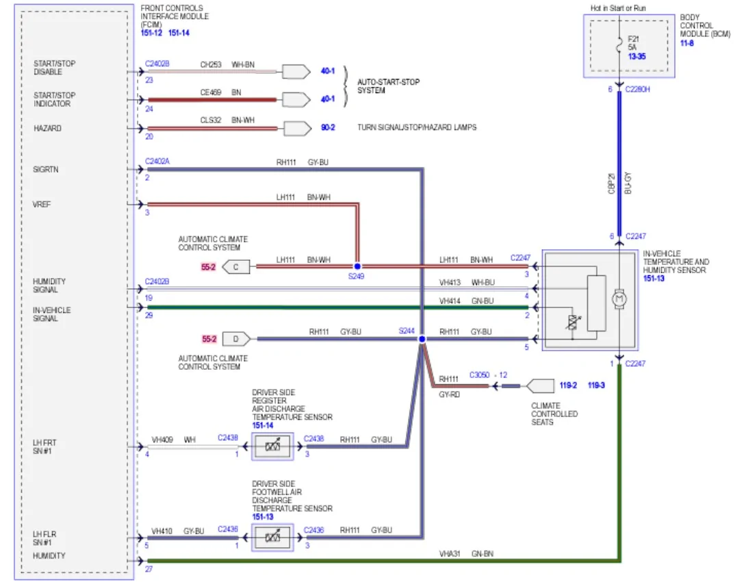

F21 is hot in start or run. It is located in the BCM (body control module), the fuse box under the steering wheel.
From the 2019 shop wiring diagram:

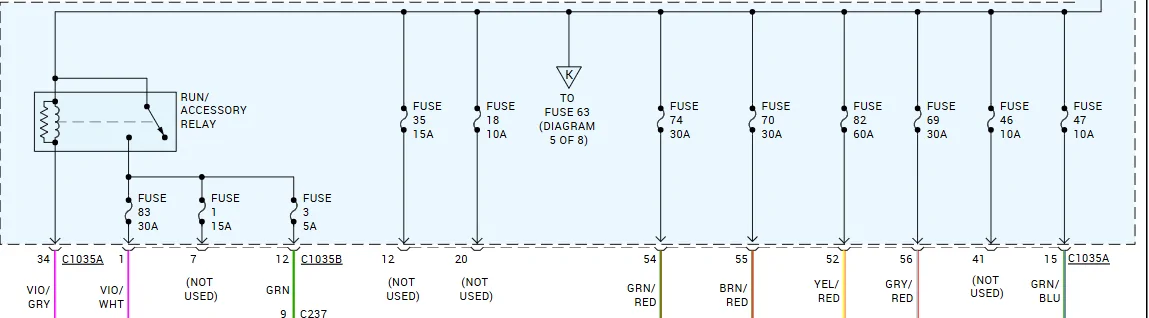

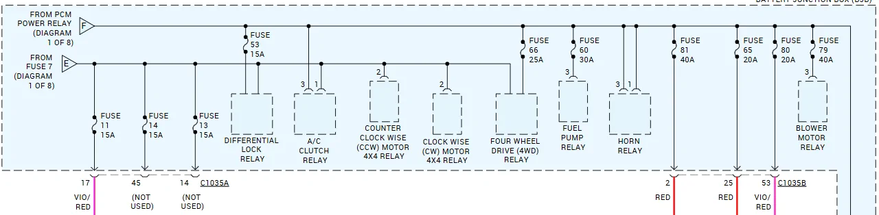

Here are some more fuses that are powered in start or run.

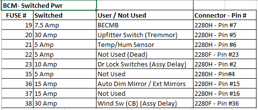

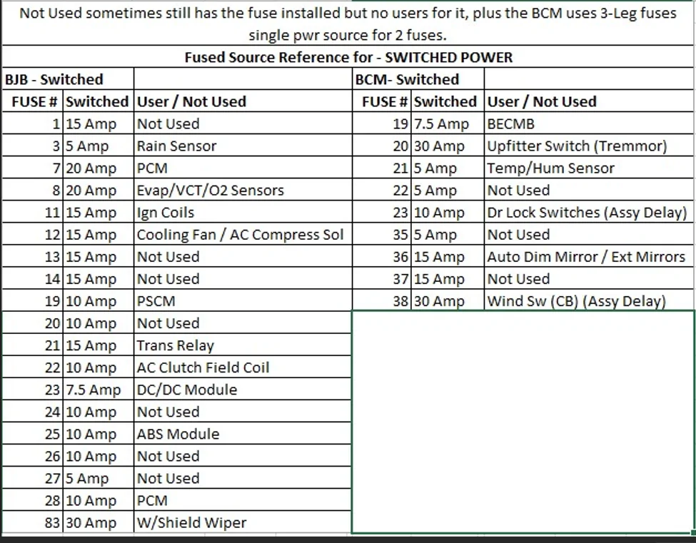

These should be the switched power fuses in the BCM:
The (Connector - Pin #) = what the output leg of the fuse is feeding
Since you have a 2019 - These should be Valid, the confusion you are getting is that in or about 2020 all the unused fuse sources were removed and (Blank Holes) no place to actually install the fuse. example you should have Fuse #24 Installed - later production Rangers - it has been removed and no (Fusebox) contacts to install a fuse. (It's a Circuit Board)
So honestly it takes a visual check and a (Test Light or Meter) to verify as there are too many varied reports on what you actually have.
So -BJB - Fuse 1 / 13 / 14 would be good candidates - If Installed & Second Verf of SWITCHED
and BCM: Fuse 20 / 37 would be good candidates - if Installed but Second Verf of SWITCHED

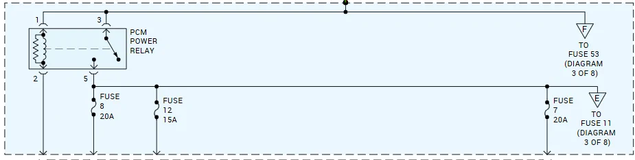

Note: Leg F = Hot Battery & Leg E = Switched Power via PCM Power Relay, in order for the PCM Power Relay to close - the BCM must supply the ground - (Wake Circuit)

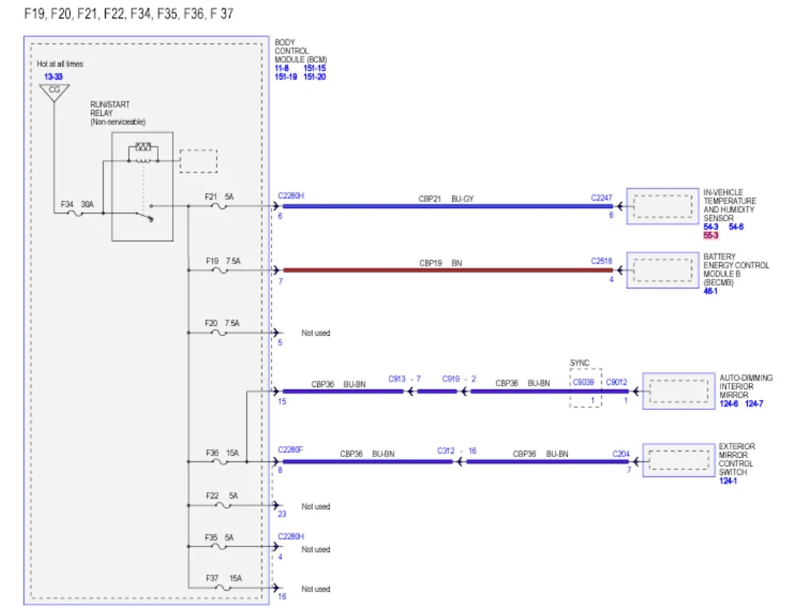

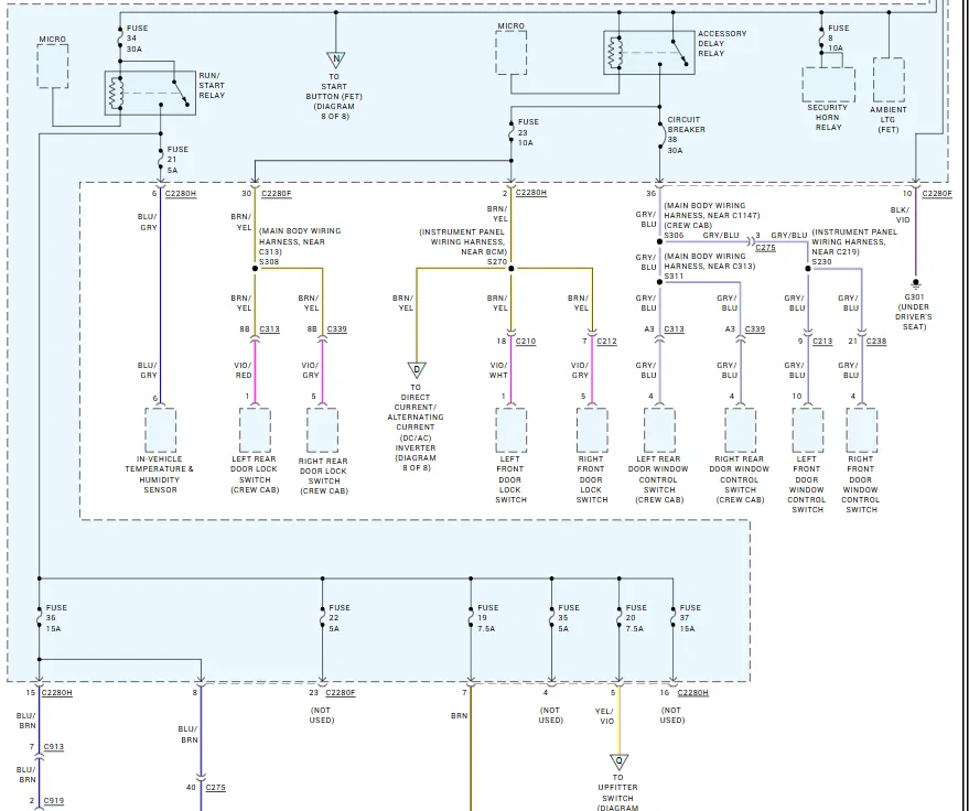

BCM - Fuse 20 & 37 - Originates via BCM (Hot Battery) Fuse 2 - 125 Amp (Leg B), This is the main power feed into the BCM - so all power from this fuse = BCM Power Controlled Output
Leg B (Above) feeds Fuse 34 - For the (BCM-Run Start Relay) - When the relay closes, power is provided to Fuse 20 & 37.
Note: As you can see here with this diagram (Fuse 20 = 7.5 Amps) however then Fuse location charts note it as a 30 Amp fuse.
So: In reality here for (non-tremor) Most Likely is wired for Fuse 19 & 20 (3-Leg) fuse 7.5 Amp and for the (Tremor-Only) Fuse 19 is 7.5 Amp and Fuse 20 is 30 Amp - They have it wired differently than the (Fuse Location Charts) show,
Plus, it is noted that this diagram & fuse location charts show fuse 37 as 15 Amp, however via Ebay pic of the Fuse Box show a 20-amp fuse in that location.
This is WHY - you must physically check what you actually have when it comes to fuses, too many variables to confirm as they differ so much.
BCM Fuse Box - Pic via Ebay - So this is most likely, what you have but fuse 37 amp could be a 15- or 20-amp fuse. (On Print it is 15-Amp) - I would have to physically check mine as well.
So, there is switched power fuses on the truck, it is just the remaining power in the circuit that is misleading when using a test light - if you were to use a meter, you would see about 9-Volts or less, and if Appling an actual load, it would drop to (0-Volts)

10 watts would be about a 1 amp current draw. 15 amps is 180 watts at 12 volts.
See my diagram in post post #3 above.
You should be able to tap into one of those (upstream side of an existing fuse) with no issues.
