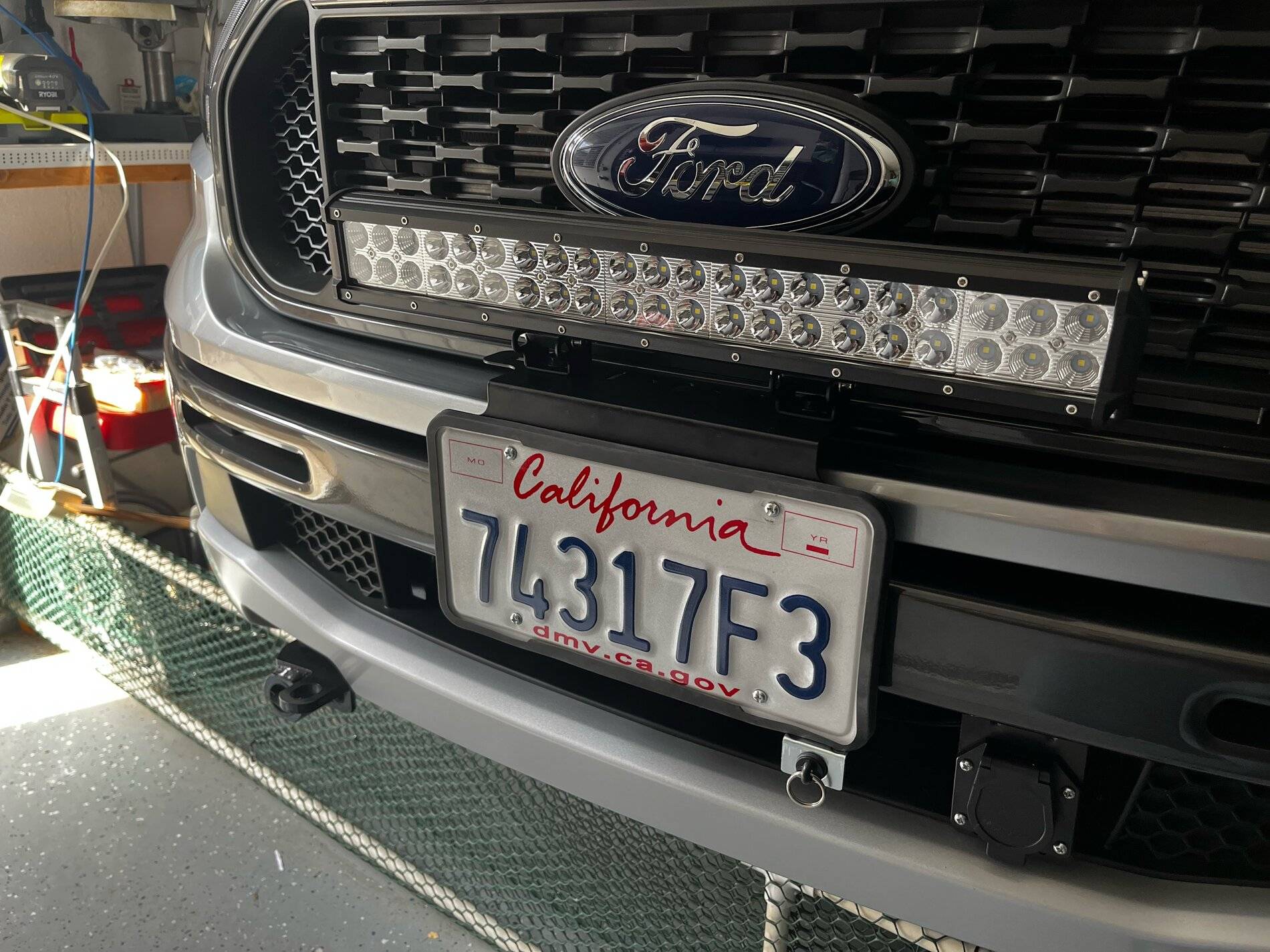

As front Lic plates are required in Calif I went with a Lic plate holder with a built in bracket for a 20" light bar, the area for the ACC (I don't have it) is not blocked. This works well and the bar is rock solid. May not be what you are looking for, but I like it :)

thank you. BTW, did you have to drill the mounting points in order to get to the metal part of the bumper? longer screws to secure the bracket?
Well, as we require a front plate I decided to drill the bumper at high center, it will never be seen in any case, then I made two 90º brackets to stabilize the bottom of the mount into the stock bolt holes for the OEM plate holder. This made the light bar mount rock solid with no light 'wiggle' Neither the center or lower bolts can be seen and make for a solid install, you could actually put a 30" light bar on it if you want, I may end of doing that and moving the 20" to the back bumper. All the hardware I used was SS.

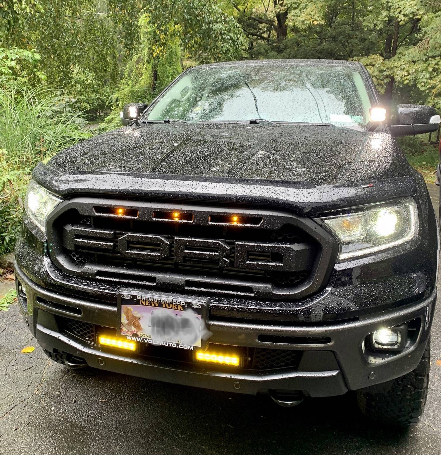

I have the diode dynamics 6” on either side of acc sensor. I use them as fogs frequently
