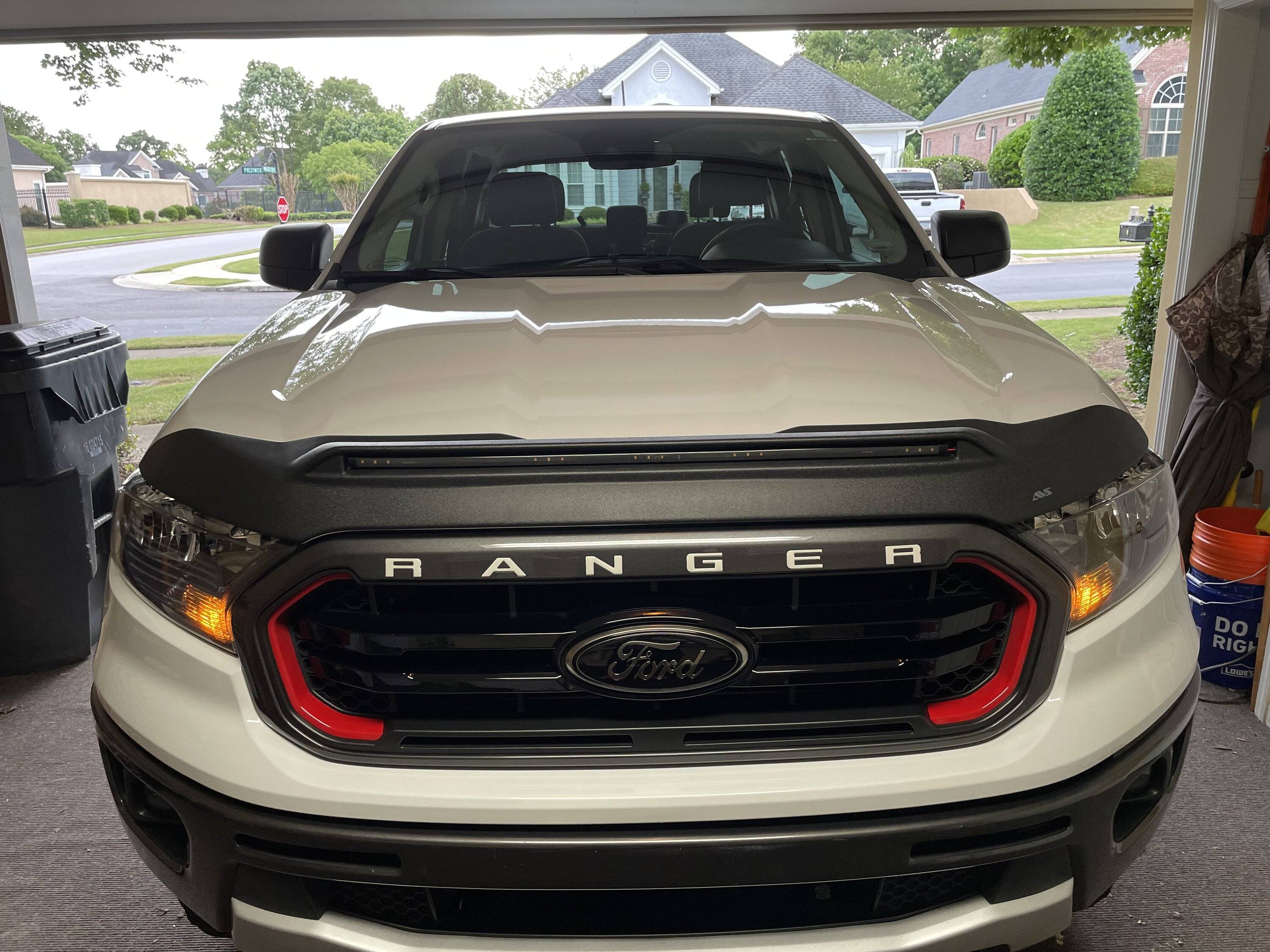

Hello everyone. I was wondering if you guys can possibly help me with something. I installed an AVS Bug Deflector with an LED light bar today. Got it grounded correctly, and hooked the hot wire up to the Gray wire that is supposed to be for the parking lights, but I have nothing. I checked the wire tap more than once and even went to the parts store and got what I feel would be a better tap and still nothing. According to the wire diagram from my Ford dealer the gray wire is for the parking lights and there is only one gray wire so it stands out pretty well. Any other troubleshooting suggestions?
